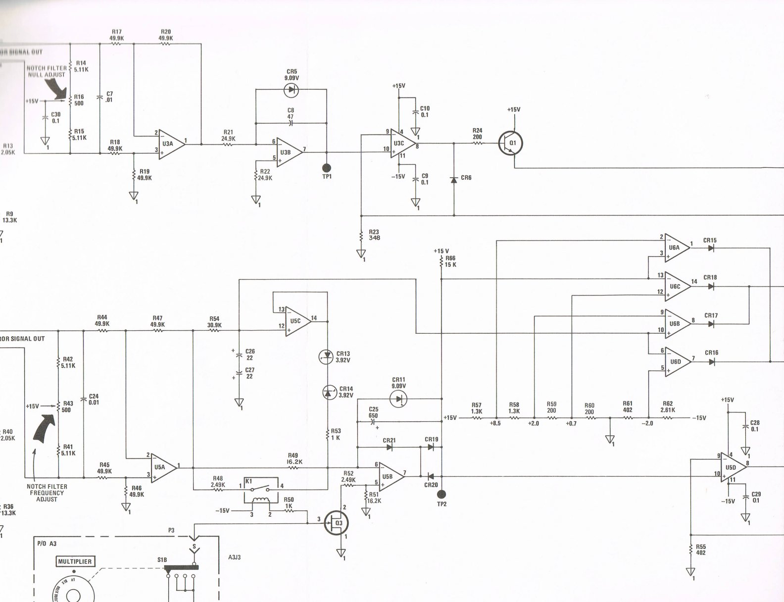

Sync return the A4 board to it original state. I don't how many times I have stressed to you thet you need to do these mode from a clean slate. The mods must be done one at a time and evaluated before going on to another. otherwise you end up as you are, confused by not knowing what's causing what. Do the repairs first then the mods. If the repairs are not successful then don't do any mods at all.
A4U1 goes crazy at -50 dB on pin six. -40dB it's with the
supply noise or background noise.
I thought at fist it was because I removed two of the zeners
on the A4U1 board and lost them or they got lost when the
container of parts fell over. These are the little CR1 and CR7
3.92 V zeners. Wonder if any old zener will work...
i've got some 8V, 9V and 12V ones I guess I can sub in
and see.

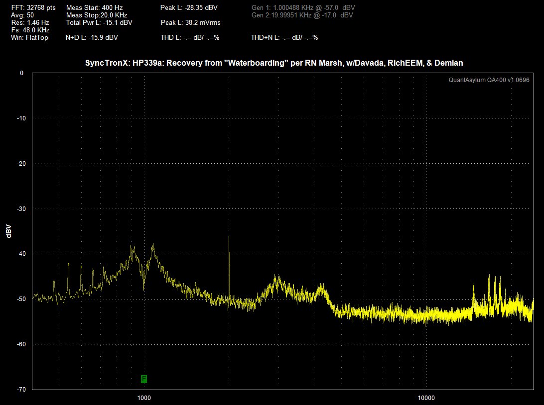

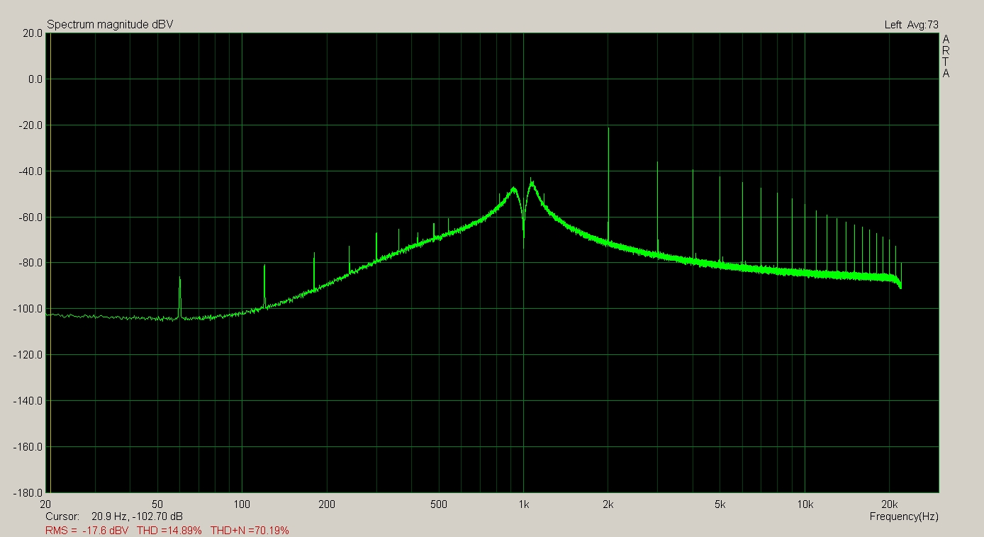

This what my 339A look like on the monitor.
I haven't touch this analyzer in two years and had a bit of soldering to do. I left it in slightly dissembled state.Four hours later here it is. I need to cal the A4 board better and the filters are causing trouble. It's actually not the filters but the filter switches that are causing noise.
If I work the switches for a while it kind of starts working again.

A4U1 has one purpose only: to drive the balanced modulators used as phase detectors (that tune the notch filter to the fundamental) with square waves, and the value of those zeners is important -- not just any zener will do. Along with the high gain of U1, the zeners are signal clippers that make fast and clean pulses for the detectors to do their jobs. You really must find those zeners and use them -- these really are critical components. I don't remember that David changed those parts, wouldn't need to. The extra gain he added using the 200 ohm R can be beneficial to getting a deeper notch, as we've recently discussed. I'll see if I can find a part number for those zeners -- they are special...

So here are the images:
http://www.diyaudio.com/forums/gallery/showphoto.php/photo/11933

The modulators operate with input voltages in the low mV, Typically =<15mV.

After I looked at it again, I removed some more of the parts
for the recommended mods that were abandoned.
It is working again with an extremal oscillator.
I took my measurements from the FFT on the monitor output.
I'll go back see what it does with it's own oscillator.
I haven't resolved buffer nor the filter area yet.
Pics at 11. : )

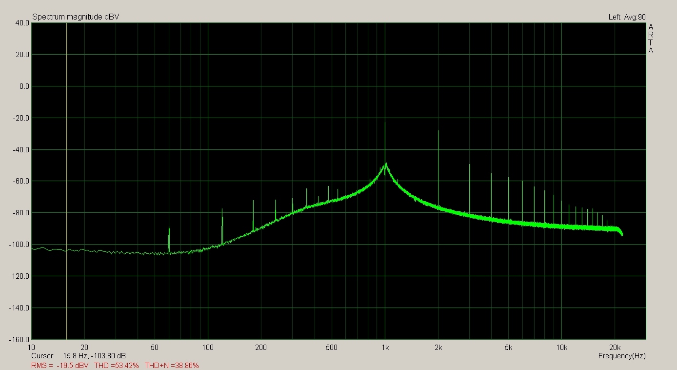

Sync this is with a gain of 1000 on the A4U1 op amp. The offsets from the fundamental are 180Hz. This is the 3rd harmonic of 60Hz. The offsets are hum modulation from the power supply.
Yours is looking better but still has a ways to go.
Switches are causing trouble for this 339A. The mode selector switch is causing signal leakage. I have to work the switch to get it cleared up. The leakage is strong enough to cause the final gain stage before the RMS detector to clip. When this happens the distortion on the monitor port goes way up. The 80 kHz filter is unusable. It completely undoes the 400 Hz filter's effectiveness. It will take some digging to figure out what the problem is there. But unless the switches are working properly then diagnostics are impossible.

The water just keeps pouring on me just when I thought it was
through.
NOPE
Will all the unchanges...the problem is still present.
I discovered it when I plugged the DUTs own oscillator back
into the Distortion Input ...same Elephant ears.
At lease I know the oscillator input is making the problem

A1 TP3
DC voltage is spec 9.1or9.2 Vdc.
AC voltage is hi at 130Vp-p. Spec = 45mVp-p
A1 PT4
DC = .003 - .005 Vdc.
AC = >150mVp-p. Spec = 75mVp-p
A1 TP1
AC= 19.25 Vac p-p.
Replaced CR14 and C24. Didn't make much difference.
Wondering if I should just replace the Diodes in CR2,CR3, CR4
and see if a difference is noted. That would rule out leakage
of those parts. I could also see if the resistors around those
parts drifted or just replace with less noisy parts as I think I have
some. But then where does it end?
