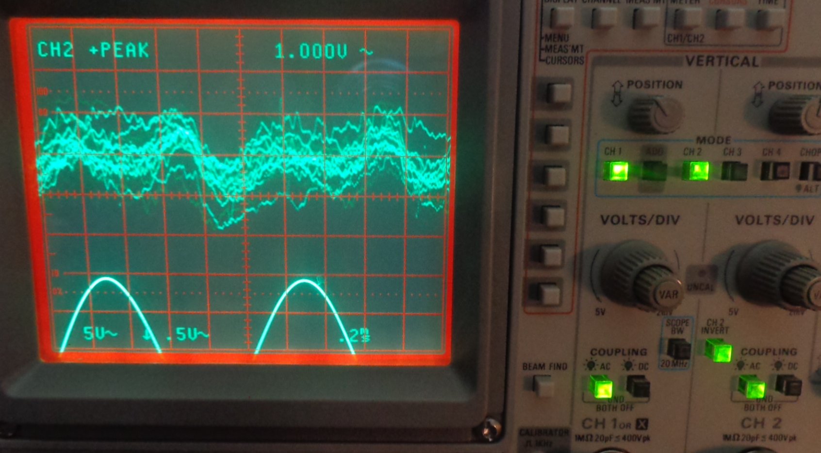

Developing pics from the lab was quite slow but here they finally:
These was the output from the oscillator to the distortionan analyzer
input section. The final nasty harmonic distortion taken from the Monitor
ouput. Do can someone Richard, Davada perhaps post some similar pics
to see how properly functioning HP339a looks on scope compared to this
one? Many folks I'm sure would appreciate it. It will also be good to have
some documented screens do the DIYer that follow will have a trail with
some crumbs.....

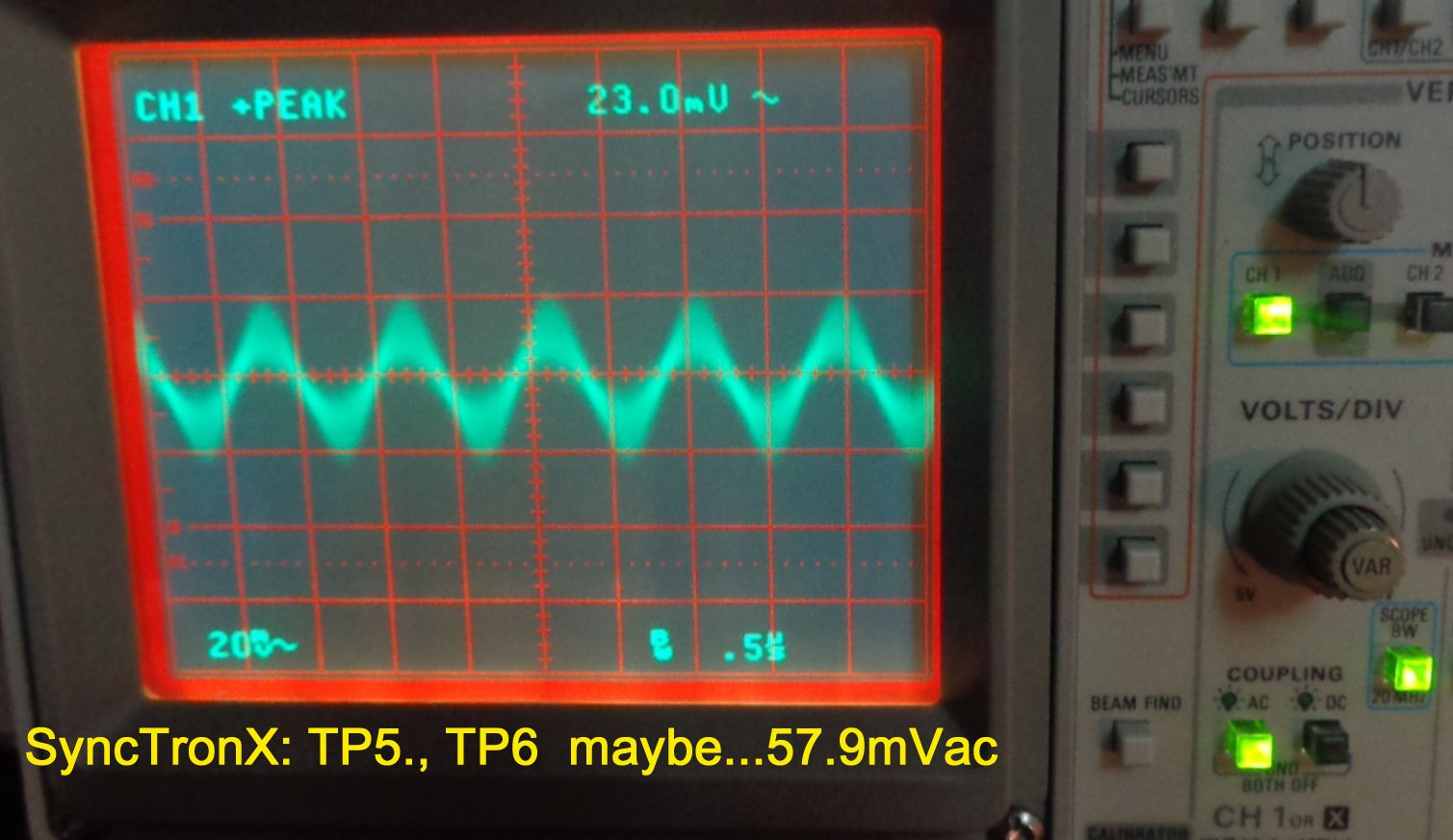

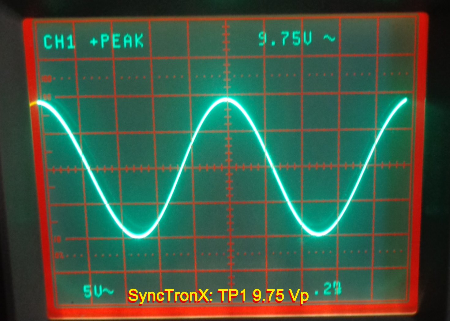

Here is the next one: Showing the since wave at TP1 just off the oscillator.
Following that, this:
Perhaps mislabled, should actually be TP3, right at 9.0 VDC as it should be.
Then there where problem started to rear the head. TP5, TP6 were both 23 - 30 mV ac at the time as shown. Later some how they changed slightly,m which was strange. The other componant was the checking the DC voltages....93 Vdc where they should have been8Vdc on TP5.

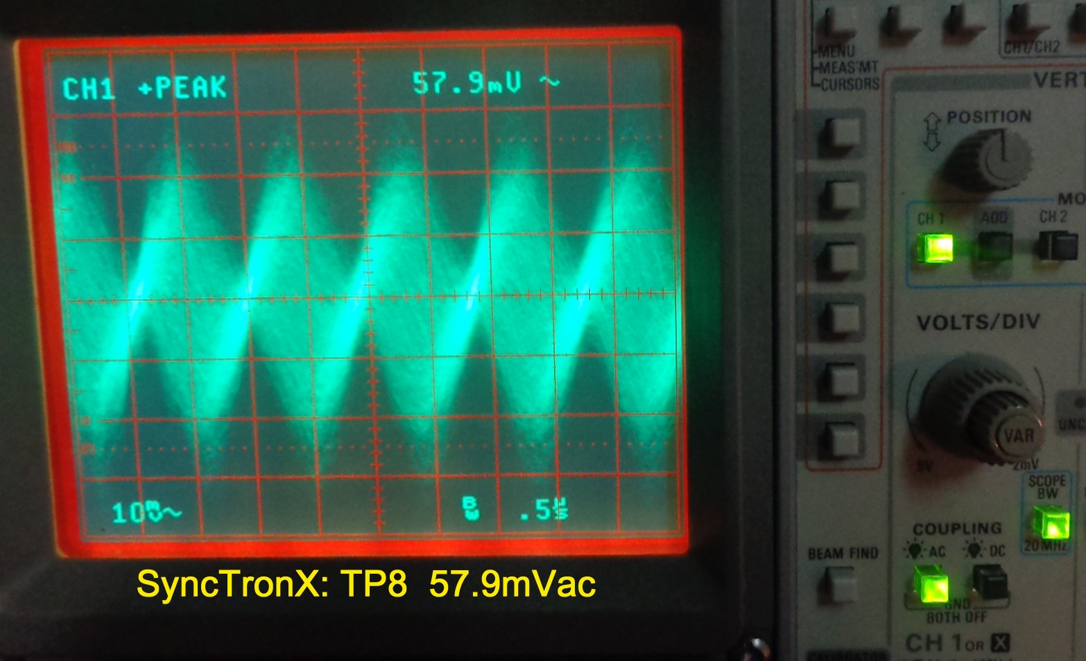

And these:
TP8 just off the main oscillator and JFET should be smooth and clearly
defined to -.461Vdc
So will one of you gentleman take the time to show your scope pics of the same
Test Point voltages. This will be a really big help for anyting troubleshoot their HP339a meters in the future. We've got the screwed up one, now lets see what we should be seeing.

There is some oscillations and or noise showing up in the last two pics. This is your problem.
It's in the others just can't see it as well.
What do you read on the THD meter when you put the sine wave output to the analyzer input? THD level??

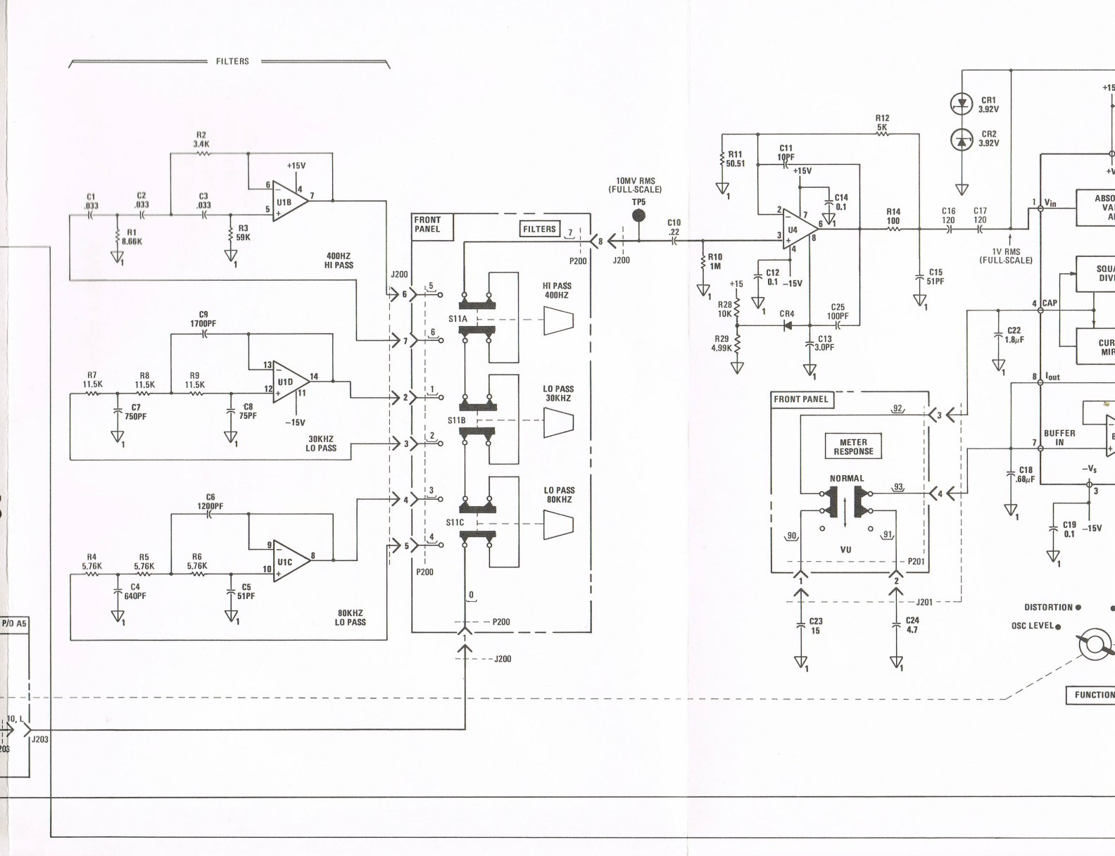

Here's the schematic:
The only source of positive voltage there is right
on the 400Hz opamp U1 B.
I'm guessing. I'll have to check it on the back side
of the board.
of the board.
