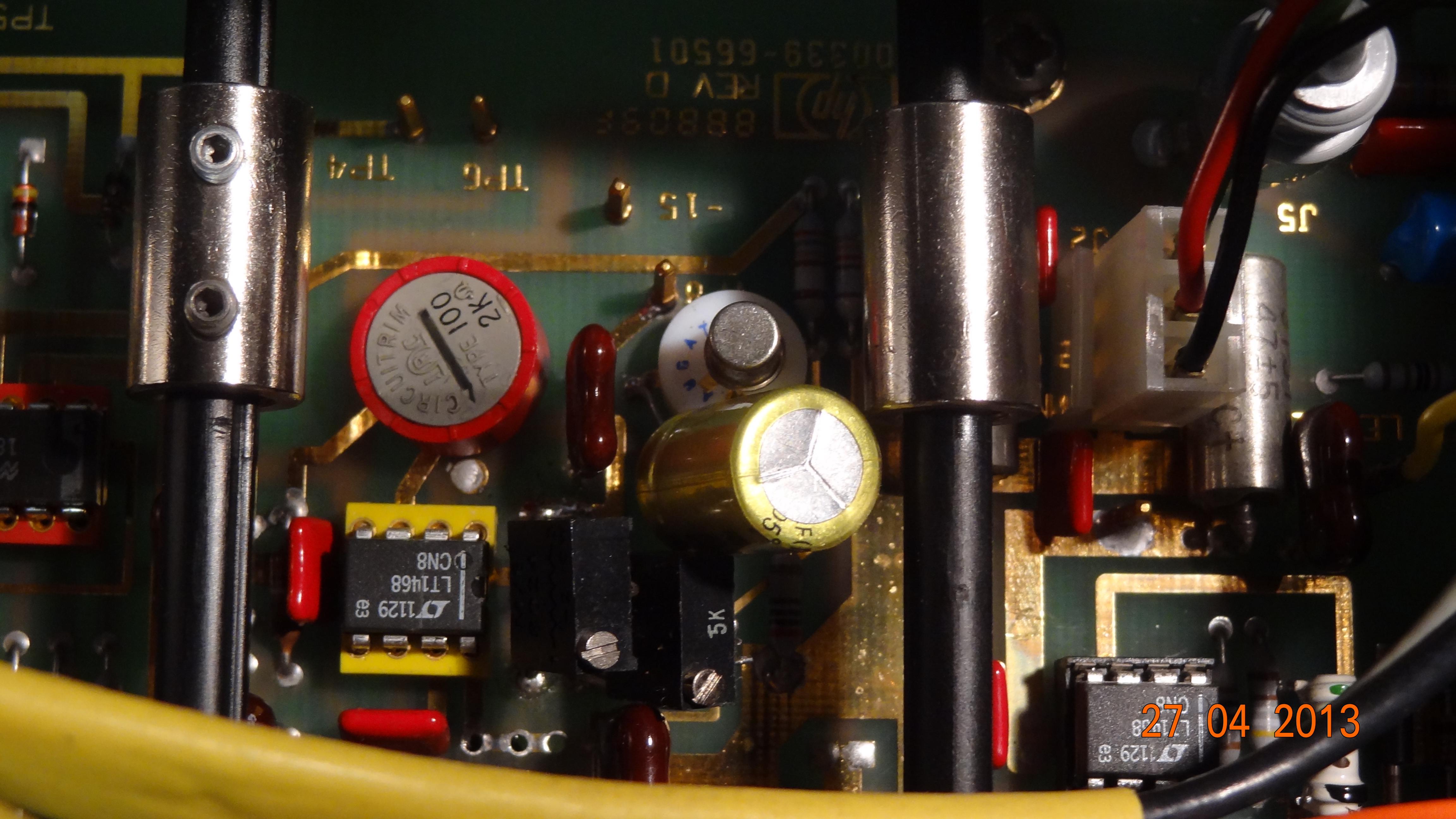

Richard,
I would like to make mine that good. ; )
What are the .1uf caps that you are using?
Did they come in the analyzer?
If you had another pic at the opposite angle
points down so I could see what is on the other
side of the 5K trimmer.
You still have C48 in there, but it shouldn't do anything.
What did you use for your Quad opamp?
And what you used for the quad op amp.
Maybe the circuitrim 2K is the pot to use

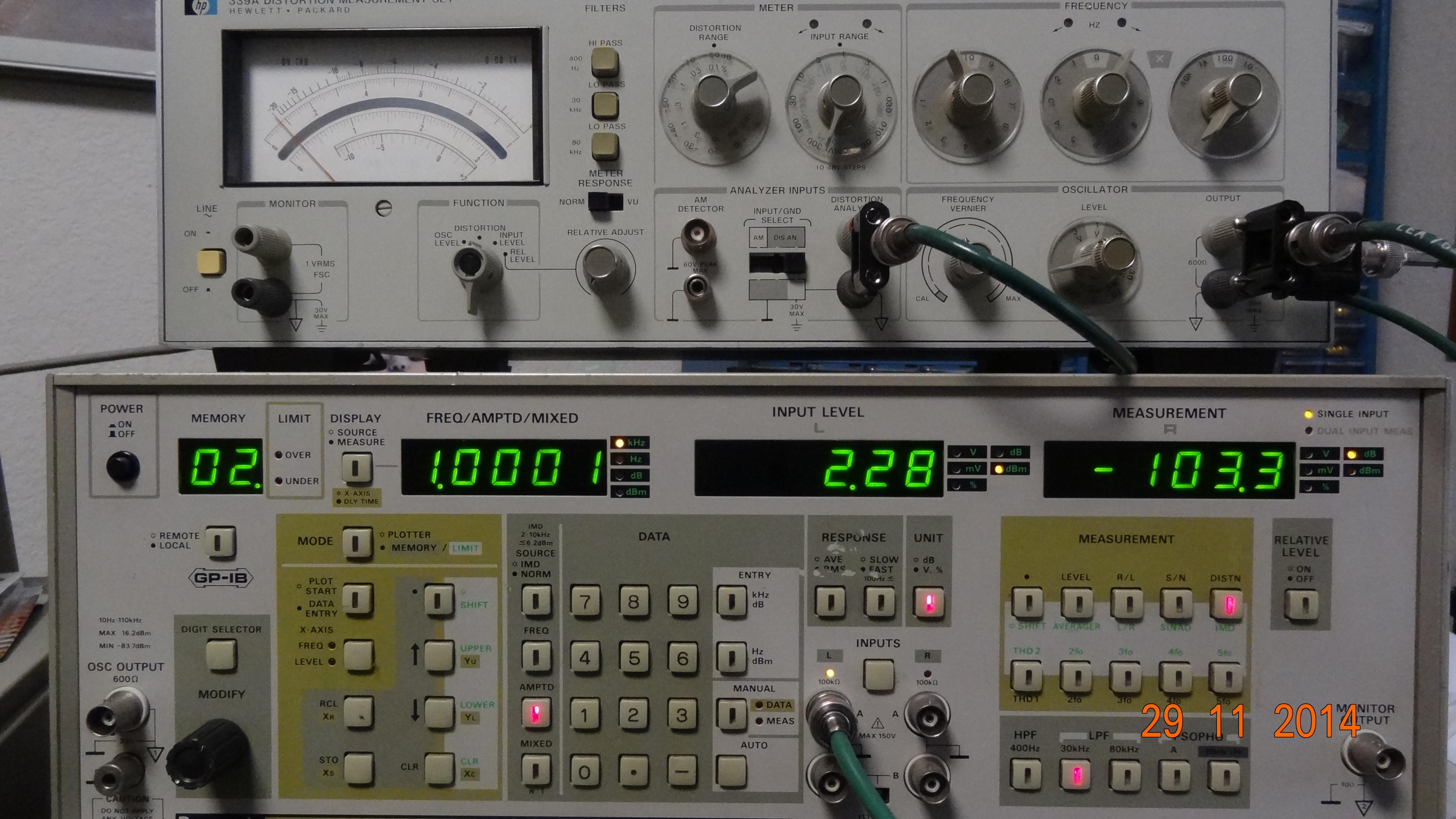

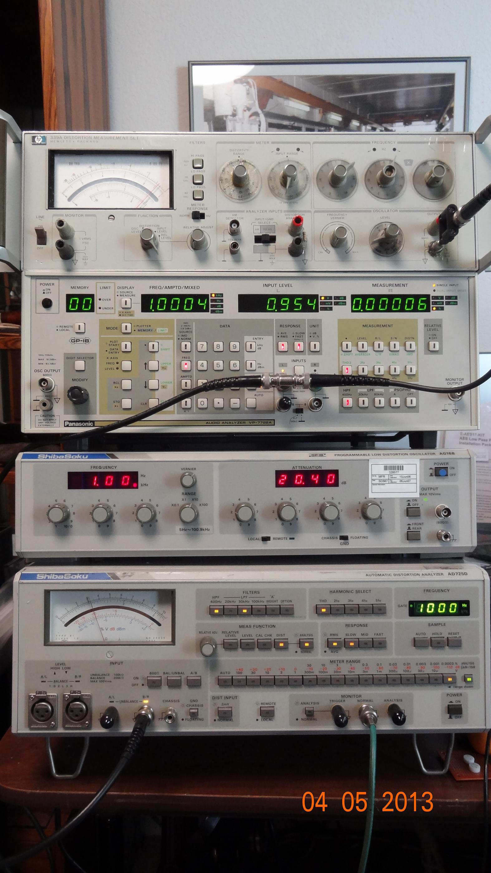

That is an averagew not RMS reading, if you are asking about the Panasonic's display. The RMS will be about as shown on the ShibaSoku 725D.
RichEEM, yes I was.
So, on the 725D, that is -110dB (switch), plus an additional -10dB (from the meter), is -120 dB. Then there is the analyzer gain switch with +10dB.
Do we also need to account for the ShibaSoku Ag16b which shows an additional
20.40dB down? I don't know how the cables are routed...I assume though this.
Then, that leaves us with -120db + (-20.4db) so combined -140.4dB?
OR
Maybe they are for comparison HP339a with Panasonic vs.
ShibaSokus.

Not sure how to combine all the info -- my own 339A oscillator has harmonicss that are in the -130dB range, so the THD+N could be at around -120. I do need to circle back around to the 339 and see if I can get a little better performance out of it. I've been reluctant to go back there because it is so dang hard to work on -- at least the 8903 has boards you can pull out, even if there isn't anything much you can do after that...

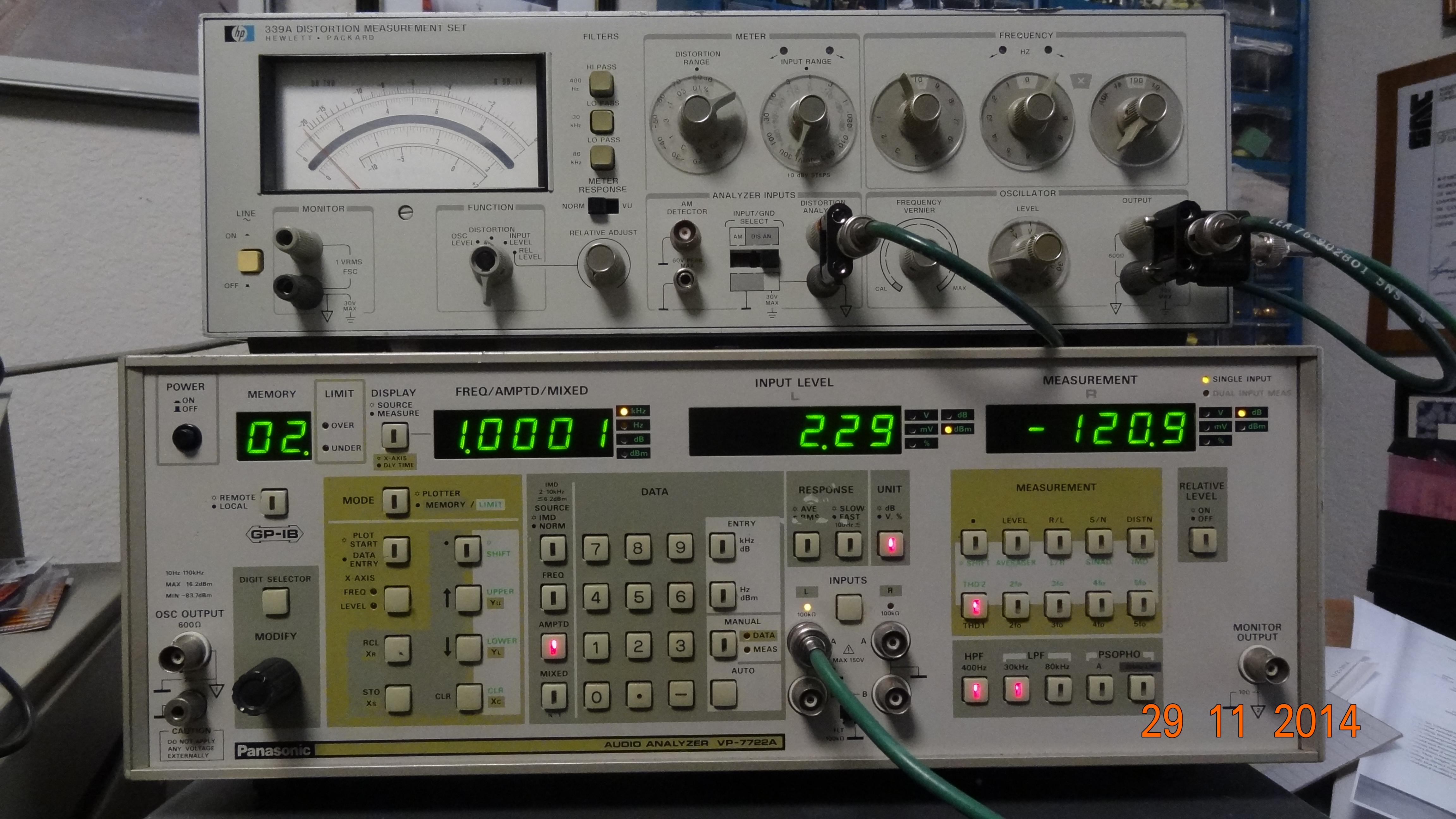

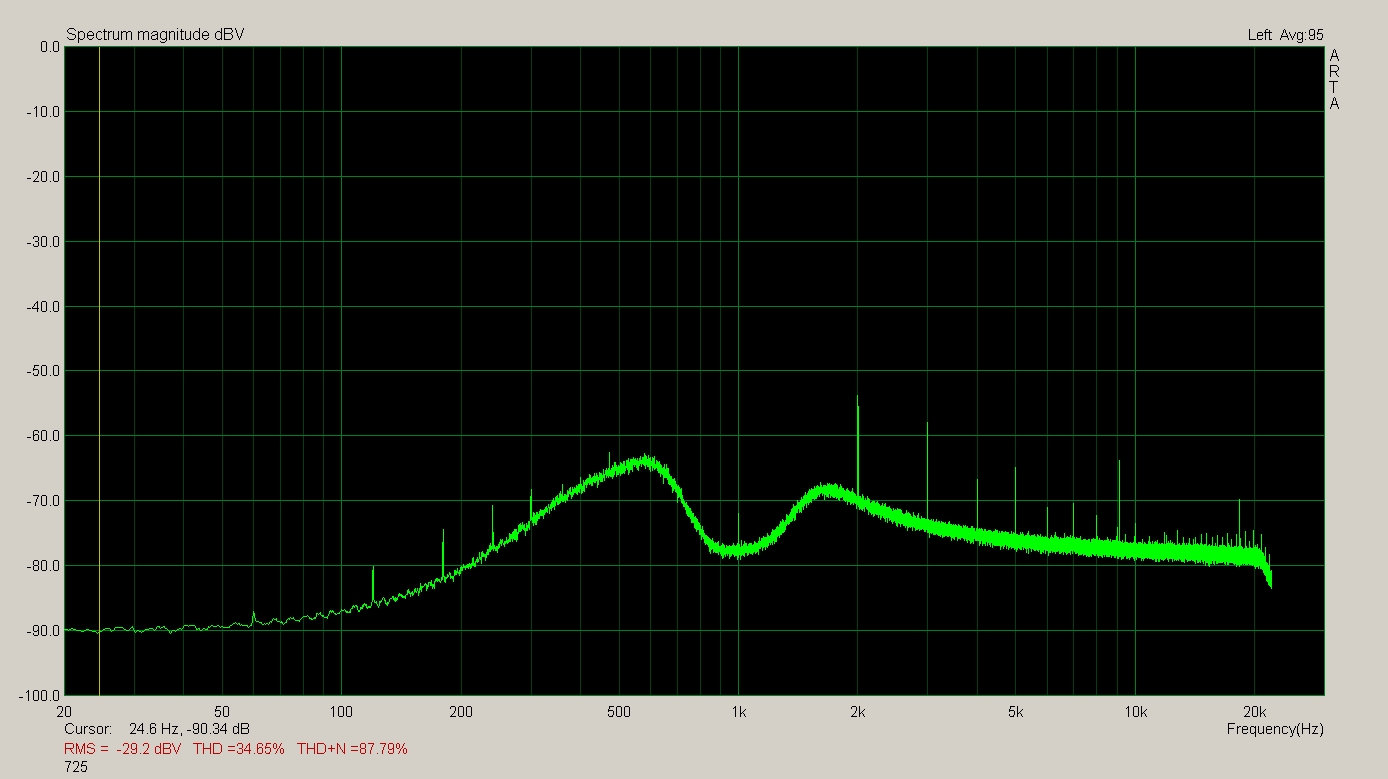

This is down from -90dBV. Meaning 0dBV on the plot is -90dBV on the monitor port.
It aint a ShibaSoku but it can source and measure directly for THD+N to just under .001% with minimal upgrades.
= THD+N
= THD
The 2H and 3H dominate the THD at -120dB....20dB better than the 339A can measure. The osc 4H and 5H + are at -130dB and -140dB from the 339A source.
This is quit good for many tests. When a notch filter and FFT are used to look at residuals, it can do quite well to see extremely low levels.

Richard, Thanks for the pics.

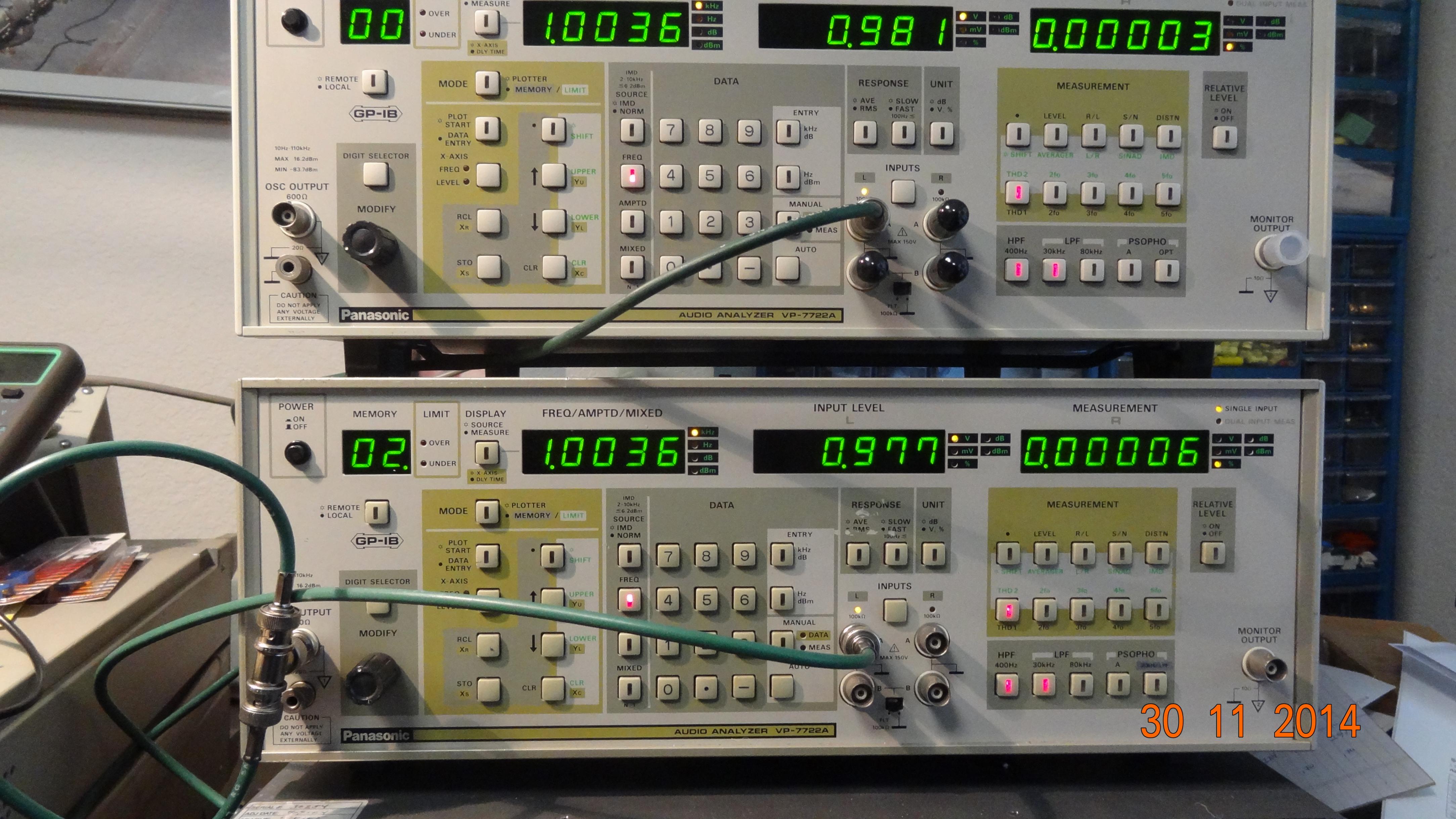

If I read it right, that IS 6 parts per million for distortion.
or 0.6 ppm?
-RNm

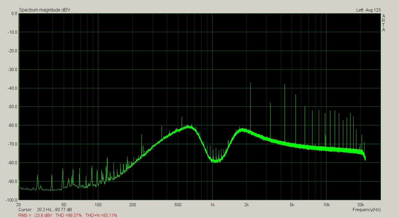

You should be able to get something like this (1KHz) ---
[click on them and zoom in for details]
THx-RNMarsh
@ RNMarsh,
Can you show the photo around the A1U3?
Have you removed C14~C17, R78 arround U3?

HP339a UPDATE
Updates for HP339a:
1kHZ, 3V, Frequency Venier CAL, Level fully CW
per HP Manual.
Generally it is working however the 2H is running pretty high
at about -80 -90 dB at 1kHz with the noise floor 130 db.
Problem 1. Switch filters, 400Hz doesn't work and
no signal passes...not sure yet where the problem lies
at the switch or .033 caps or problem on the board.
HP339a starts to get screwy along the way to the JFET
and the A1 board. This is in the AGC circuitry.
The output of the oscillator U1 measured at
TP1 - 9.45V ac.
TP3 and TP4 are where it should be
according to the schematic.
Problem 2:
TP5 - 23mV - 30mV ac
TP6 - 23mV -26mVac
TP8 - 54mV ac.
Can anyone check their HP339a and see what they
measure on these test points? I'll post some pics
of scope shots after the nightly news. 🙂
Problem 3:
at about 80 - 90 dB. The noise floor is lower than 120 db.
Could this be attributed to the JFET Q2?
Still working on these.

Measurements taken @ 1kHz off a working oscillator.
TP1 9.59Vp This correct. The nominal is 10Vp
TP3 ~ 9Vdc, 24Vpp
TP4 58mVpp, 0Vdc
TP5 ~ 8Vdc
