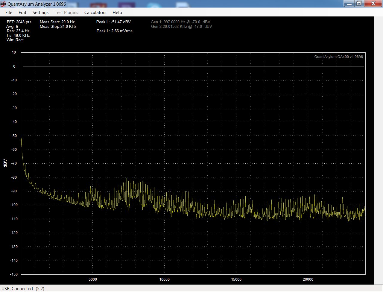

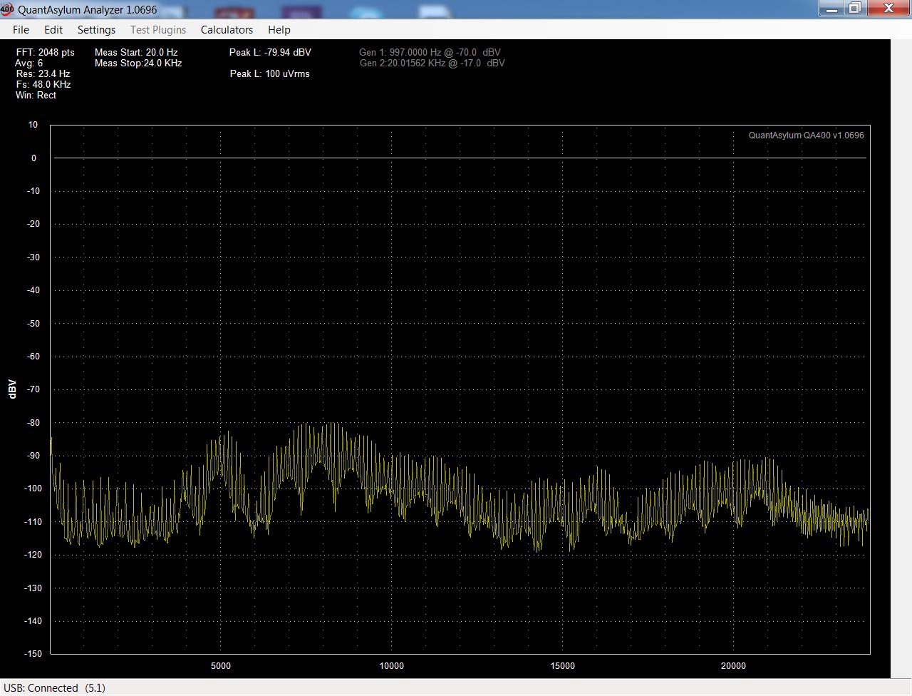

From what I can tell by looking,
the buffer amp is part of the problem right now.
And then somehow, I have bands that rise up
with distortion in 5 kHz bands, that is -10 dB
above the noise floor.
This seems to be imprinting and I'm not sure what causes it.
The power supply isn't so hot and regulation is off about .2 V.
The oscillator power supply seems worse than the Meter Circuit.

600 Ohms didn't make a difference.
I still think HF Notch Filter
A3C18 but then if Buffer amp ringing?
is contributing somehow, that would
help explain things. Maybe why I couldn't
adjust it after changes.

I don't find a lot noise from those regulators. The ones in my 339a are quiet. The 317/337 are noisy. You might have a bad regulator. I doubt that the power supply is causing your problems.
Look at the 339a rails on you QA400 decoupled with a 0.1uf series cap. if there a problem there it will be obvious.
I would say it appears more like a measurement problem. Grounding issues most likely. Not a reg IC.
Or, bad solder joint for intermittant noise... maybe joint of a PS cap... resolder,

That is supposed to be intermittent noise.
Or
Something is back feeding to it.
It is on the Oscillator +15 volt rail.
I captured it, then on a hunch
I turned the viariable cap for the
H.F. notch tuning. Hmmm, it must
cause an oscillation somewhere on the A3 board...
or perhaps that 1/2 of the PS regulator is oscillating.

Disconnect the power supply from the oscillator, load it and see if the noise is there.
How would this noise from an isolated power supply get into the analyzer. You showed a plot of the analyzer alone with elevated noise.
Have you tried the ground switch in a different position? I found it best when the oscillator is floating.
My Bad, it is on the +15 of the Meter.
Here is the POS15 Rail for the Meter
after changing the Function selection:
It also stopped when I turned the adjustable cap on the A3 board.
That Notch Filter HF Adjust Cap A3C18.
That cap also looks like it has head damage to it
on the top. I was very carefull to cover them when
I was cleaning the switches etc.
I'll Try resoldering the Cap leads that I changed etc.

Well I got the Distortion again on the +15 V Meter Supply
rail by turning the FUNCTION switch back and forth
and noticing the pulses change with the Relative Adjust
pot rotation. There are pulses on the meters needle.
Hmmm, when the needle is pegged at greater than
minus 20, (zero on the left) then the needle is stable
but the distortion shows on the plot.
Swiching to OSC Level, stops the distortion on the
plot, but the needle pulsates.
Switching to Distortion, Input Level, REL level
all cause the needle to pulsate.
Switching to Osc level Stops pulsate or distortion on plot.
Then I have to switch back and forth a few times for the distortion
to show on the plot again as below.
