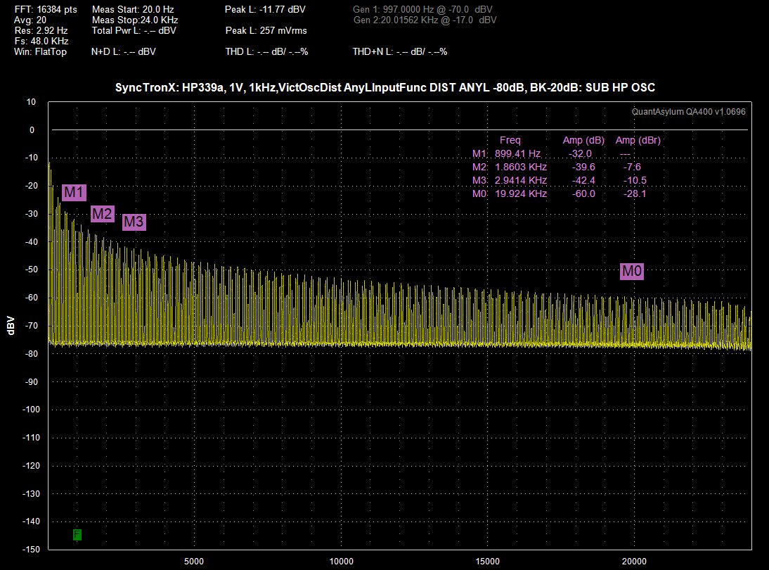

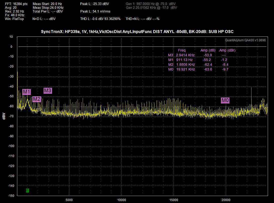

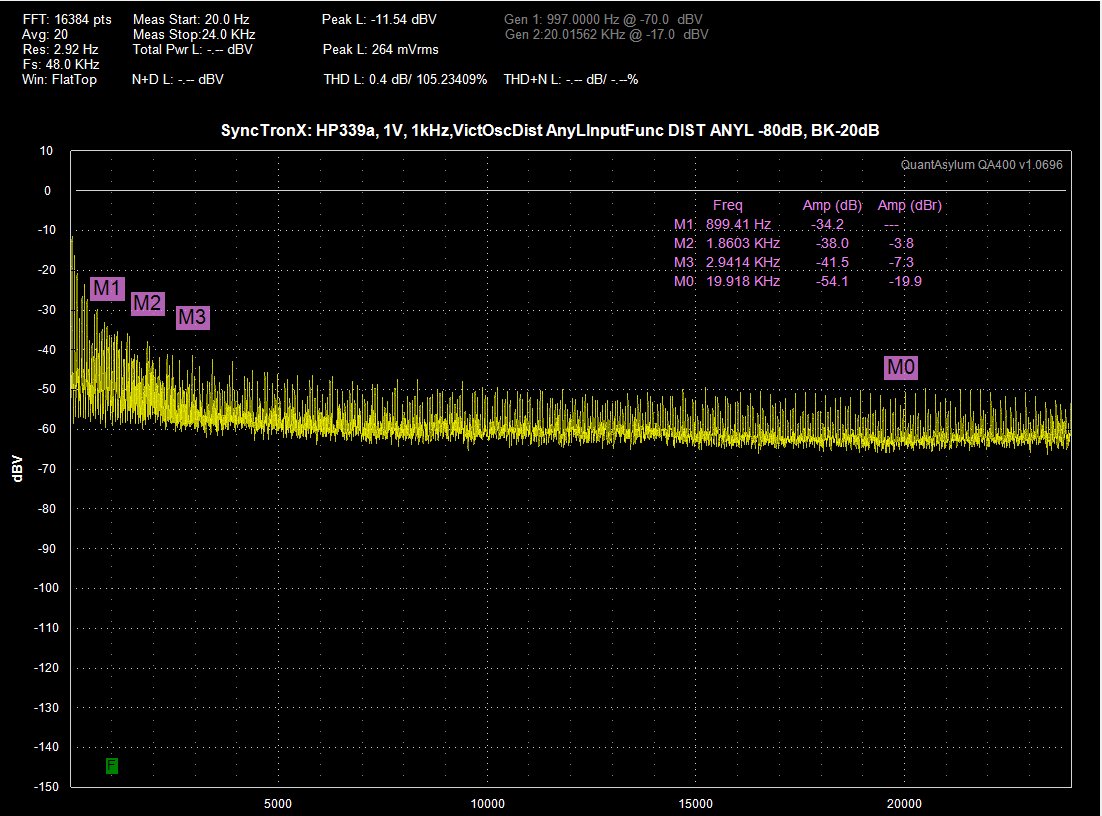

Finished up all the mods for the A4 board, 10K to 1 K resistors.
100K to 10K resistors. Replacing U1 with LT1468, 10pf feedback
across 200K and change R1 to 200 ohm. Jumping R10, R39. changing
the configuration of the U4 Balanced demodulation input to mirror
U2 with the 10K balanced input. Changed C8 to 1uf. Replaced
680uf electrolytic with new one. Bypassed c26, c27 with a
1uf too.
Putting it on the QA400 and using victor's ultra low distortion Oscillator.
Then I dialed in everything as best as I could using the guidelines on the
Low Distortion Thread post # 996. A4R65 is new 20+turn pot.
Then there is input balance 20+ turn pot at U4, which is a new
input Balance adjustment.
Dialing in for notch and phase, then repeating it on TP3, TP4,
then A4TP1, adjust notch (A4R16) and phase (A4R43) and
for min hash and harmonics (A4R65, A4newBAL),
I got the following:
Trying to use the frequency button on QA400 is useless to me. It won't pick
up on any other signals other than QA400, so what good is that?
Trying to dial in 1Vrms, 1kHz causes QA400 to clip, lights flashing etc.
like the thing is going to blow up?
I guess the Victor's Oscillator is working alright, as it is going to the
HP339a Distortion Input, with the Function = Input Level, it reads
-10dB at the 3V input and -80dB distortion range.
I ended up putting the 20+ turn pots at an angle because they
won't fit just straight up and down with a side adjustment.
I don't know if it is better to build from scratch for keep hacking
away at this baby. It takes a hell of a long time to do the work on
this thing modding it, and all and about 1/2 the stuff I've tried makes
it worse.

Does the problem exist with the 339a osc as the source.
I have have admit I haven't been following this with full attention.
Here is Victors Osc input:
Then Here is the the ground with the HP inserted into the input:
Then, here is the HP oscillator inserted into the Distortion Analyzer:
Here is just the HP:
All of the work I did on the 339a was with the QA400. I don't remember the 339a ever looking like that. Indeed you have a problem.
What you need to do is go through each stage of the 339a signal path starting at the input and see where this begins. Use a probe with the QA400. Take the ground from the nearest ground point closest to the section you're probing. You can pull the RCA jumpers to isolate sections. The plot of the 339a by itself looks like parasitic oscillation. Trace this with a scope, no signal input, starting at the the input amplifier.
