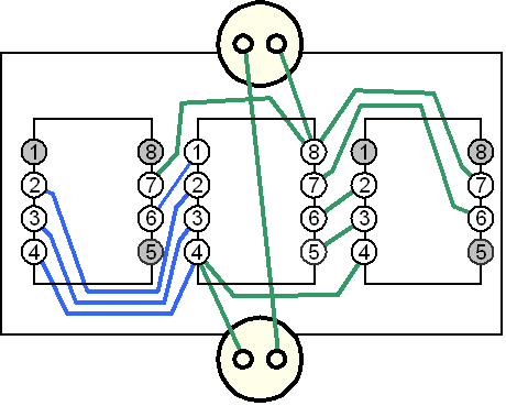

DIAR,
Your diagram is most helpful.
If the connections are exactly as you have stated, then it means that the two caps are in series and this combination protects both OPA's.
Besides connecting the 'B' pins of each cap together, did LCAudio provide a place to solder an extra wire to connect the junction of these caps to the chassis ground?
I cannot imagine why LCAudio did not use one cap of half the value (220pf) instead of two in series (2 x 470pf) if he did not intend to ground the junction of the caps using an external wire.

I thought I could build a module for two OPA627 using round pad card and a bunch of jumpers.
The chips on the right and on the left are for example AD8065 chips and the socket or what ever is soldered to the CDP PCB.

OPA627 - Single to dual adaptor
Should I use capacitors between Vin+ and Vin- poles with OPA627 as LC Audio uses in AD8065 module?
I'm not sure if this adaptor is connected correctly but I think it is. There is room for caps in the middle.
It is possible to make it much smaller but in that case you must use double sided PCB or use one short jumper and cut off a few unused pins.

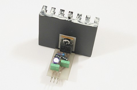

LM317 regulator for DAC works fine now but I will continue experimenting with it as it seems to have a significant effect on sound. I installed temporary sockets for capacitors and regulator which allows me to make the changes quickly and without harming the PCB.
Picture of the analog output PCB including regulator for DAC [AD8065 (from LCAudio), OPA627 (on browndog adapter), Black Gate NX Hi-Q 47uF super-e-cap configuration, LM317 regulator (on diy adaptor)]

There are several caps after the regulator: 1000, 100, 0.47 and 0.01 uF (individual sets for 5.1 and 2 ch DAC). The first one (Elna Silmic 1000 uF) is right next to the regulator. The other ones are on a different PCB and are mounted close to DAC. 100 uF capacitor is SMD electrolytic. Should I concider changing it? There is always a risk of harming the pcb when removing SMD components (I do use two soldering irons).
The caps that I'm talking about are C629 and C635:
