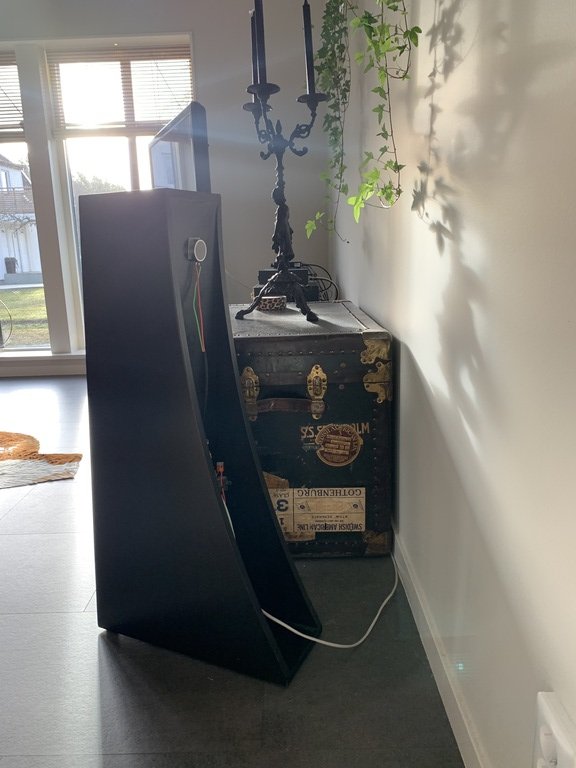

An easy and cheap way to improve the treble a bit is to add a rear tweeter. It works fine with Ron Clark type curved horns when you have som distance to the rear wall. Make sure to place the tweeter in the center line off the fullrange. I have had it in A126 with Daves treated drivers with a Dayton NDF20-6
and now in FH3 with Daves A7.3 and AKAI orthydynamic tweeters. Temporary attached with blue tack pads.
Wire tweeters in phase, pad it down 4-5 dB and select a capacitor to your own personal taste.

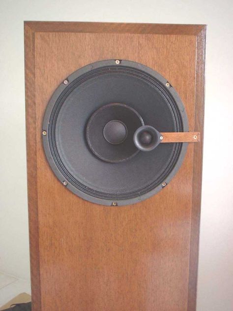

That tweeter would be better mounted in the end of a phase plug.
Is that one of the little Daytons?
dave
dave
I have no idea what kind of tweeter it is. I just pulled a picture off the internet to illustrate the mounting style.
