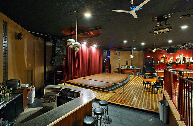

If you haven't gone too far already I'd take a step back. First of all you need to consider the size of the venues and how low you want to play. For really getting loud, horn loaded is definitely the way to go. I have some experience in doing sound systems for decent size clubs and touring type applications. One of the best overall subwoofer designs out there is the LAB Sub designed by Tom Danley. All of the info is over at prosoundweb and you can find the plans here in both metric and inch units:
http://www.prosoundweb.com/lsp/
As with any horn subwoofer, the cutoff frequency and efficiency are determined mostly by the mouth area of the horn. As a result putting them in clusters greatly increases the low end efficiency and the low end cutoff. We did 4 of these pretty much as a free addition to the line arrays we did in Nick Barnett's Five Six club in GB here that has since been shut down. You can see a couple pics of the arrays and the LABs underneath on the floor.
Ideally we would have kept all 4 of the subwoofers together in one cluster, but due to the screen being there we couldn't do so. In any case, the efficiency of these in a bank of four is right around 110dB 1W all the way down to the cutoff frequency of 30Hz. This is amazingly low for any PA type subwoofer as you will see most will have a cutoff in the 45-50hz range. Maximum output with the cluster of 4 of these is in excess of 145dB, again all the way to the 30hz cutoff range. This kind of extension and output capacity is literally unheard of. These 4 LABsubs alone filled the 8000sq ft area and many people described the sound on the dance floor as if they were sitting inside a loud car but with a lot more clarity.
As far as the drivers go, each cabinet has a pair of LAB12 drivers made by eminence. With the drivers in parallel and the loading of the horn they are essentially a 4ohm nominal load. We originally ran each one off of a bridged Behringer EP2500, but had major issues with the amps the first night. We swapped them out for QSC PLX3402's (3400W bridged 4ohm) and had no issues from then on.
All in all, you're looking at much better power handling, extension, output capability, and then also reliability than with the others you were looking at.

On the previous page, John shows a system that he designed. (BTW, It looks really awesome, John.)
John, I did run across that design the other day, and it looked easy enough to build. It seemed to be more of a concentric horn - I guess the perfect arc is what would differentiate it from a folded horn. Compared to the 1850 horn design, will this really create lower frequencies? I was under the impression that larger speakers have more of a chance to create lower frequencies at higher volumes. I also noticed that according to what is in your post, these ProSound horns may use less amperage to produce lower bass at higher volumes. Is this true, and how am I - the hobbyist - to understand how this can be so? I would like to see more discussion about this. What does everyone else think?
It's my nature, In this situation I have to think about how to make something bigger and more expensive. SO, just to throw it out there - What if I took these plans for the ProSound Horn and scaled them up proportionally to accomodate two 18-1000 VOID and built a monster version? I know from experience that some things in other fields of interest - like model airplanes - don't work when you scale them up or down, so it's a chance this principle occurs with speakers and enclosures as well. Let me know what you all think about this...
Finally, John - in your post you mention club size, well the club in your picture is about this size of many clubs here in Atlanta. Our goal is to get the low bass to fill the dance floor. We also want to go to the bottom of sonic bass frequencies, because lots of D&B has information that goes into this area, even if it's only accents in the melody of the bassline, or chaotic spinoffs that delve into these lower frequencies. (This is the stuff that makes us D&B fans crazy, and it's rare that someone comes to town with enough balls/clarity in their system to do this.) Add to this that the DJ wants to produce tracks that exploit our setup, and we have this other theory that he could create basslines that emphasize the points of resonance in our system - which we'll have to see how that works...
Finally, thanks again John for taking time to contribute your experience. I don't know how I'm going to take you all out for a beer, but I'm sure there will eventually be an online bar for this purpose...

The design was done by Tom Danley. If you look through the LABSub forum, you'll find tons of information on them. Many of the questions you asked were asked also during the design. With a horn subwoofer you're really not concerned with the size of the driver so much as you are with matching the driver properly to the horn. The design is intended to play loud, be efficient, and have incredible bass extension that is nearly unheard of. Few commercial subwoofers even compare. Those that do really cost a good chunk of money. The design was also made to be somewhat portable. The dimensions of 22.5" x 45" x 45" make them fit nicely between the wheel wells in a standard cargo van or pickup truck.
The LABsub has a much longer path length than the 1850 horn and a more exponential flare rate. It will play much lower and with much greater efficiency. There really isn't much benefit to going with a larger scale version. When it was originally designed many people asked about using 15" drivers instead of 12" drivers. The issue is that you aren't going to find a 15" driver that properly fits all the required parameters. The LAB12 woofer was designed by Tom specifically for this design.
As you mentioned, you want to play low. The LABsubs do that. As I said, most people compared the low end volume to that of a loud car system. A prosound subwoofer taht plays 30hz with that kind of output potential and efficiency is just scary. There are hundreds of these built all over the US now. I'm sure if you go on prosoundweb and ask, there are some within driving distance that you could go listen to.
