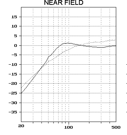

Drat. Forgot to post that graph, for interest's sake. See below.
Anyway, agreed. I'm no pure subjectivist, or objectivist. The above is simply my take on publishing measurements & some of the reasons why I'm wary of it. I don't want this to go turn into a debate on measurements either, so from my POV, I've nothing further to add on the subject here. Back on topic, as you say, it'll depend on the room, system & taste as to which you might prefer, so if you can tell us a bit more, we can probably guide you more effectively.
The Fisher quote? He did have a good turn of phrase didn't he. 😀
