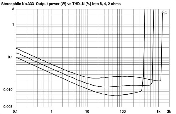

i was talking about typical classAB, here are some examples...mark levinson

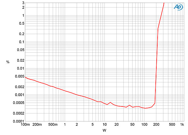

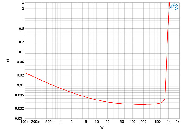

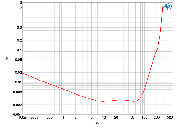

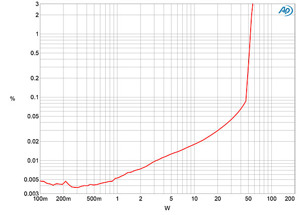

Question: those who claim only clean amp should be used...can you please tell me what is % distortion cut off according to the listening tests below which amp is considered clean, and above which amp is considered 'effect box'?
Well you just showed the class d purify module based nad c298 having the same distortions at low power as your class A gryphon...while the gryphon distortions rise with power same as in any class ab amp...not sure i'm getting your point anymore.
