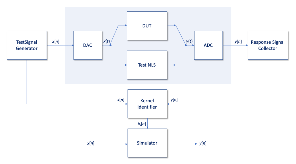

However, there is a small detail to add. As already stated, the non-linear distortion model adopted at the moment is of the static type. This means that the input/output curve (fig. 2 of the same post) is univocally identified by setting the amount of the desired distortion for each harmonic. Also the relative phases of harmonics result univocally identified with specific ratios. Well, I compared these values with those obtained from the measurement of dozens of preamps of all types: the agreement is weak.
This because our audio devices are also affected by dynamic non-linear distortions, caused by the non-linearity of the components inside the amplifier, together with thermal effects. The effect on the model is a variable input/output curve, dependent on the frequencies of the input signal, and probably also on its level. Therefore, if we want to represent more faithfully the non-linear distortions injected by our audio devices, we need to adopt a more sophisticated model, the Volterra Series, which can take these aspects into account.
I am currently working on this model; the reference scheme is as follows:
Basically, a digital Test signal is generated, a Synchronised Swept Sine which through the DAC reaches our preamp or power amp (DUT) to measure in analog. The property of this test signal is that of separate non-linearities for single harmonic. The DUT output is then converted back to digital via an ADC and stored. Then, the two digital input and output signals are processed (de-convolved) in the Kernel Identifier block to identify the parameters of the model (the Volterra Kernels). These Kernels hi[n] allow the Simulator to reproduce the behaviour of the preamp digitally, and then validate the model using any signal x[n]. A Test NLS component can be used as known block instead the DUT to further checks.
Of the processing components described, I have already created all of them except the "Kernel Identifier", which is currently being completed. Suggestions/comparisons with similar works are always welcome.
