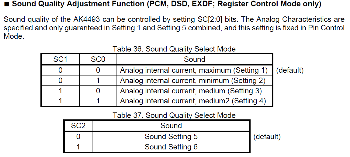

AK4493 datasheet contains some explanation on the sound control. I guess "Analog internal current" refers to VDDL/R, not Vref as it is only 1.5mA in these voltage out dacs. AK4497 has similar sound control but there the non-default Sound Quality Select Mode is labeled as "High Sound Quality Mode". Limiting the internal analog circuit current may explain the increased distortion I measured with AK4490.
