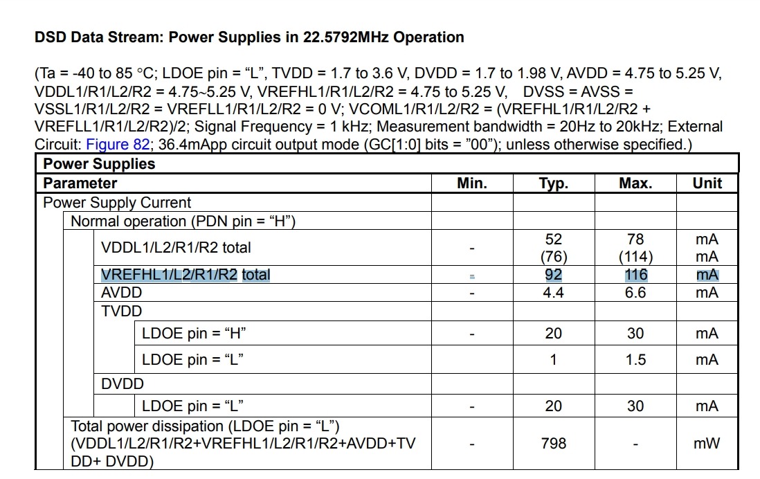

According to AK4499 datasheet VREFHL1/L2/R1/R2 total is 92mA typical and 116 mA max. Same for PCM and DSD.

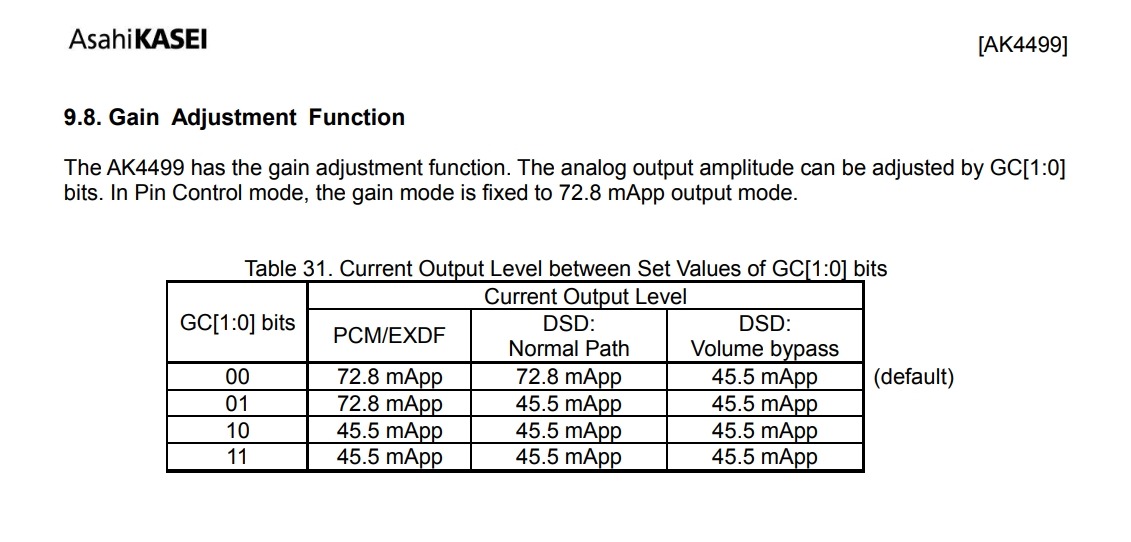

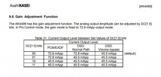

Output current varies with settings, which for me is 'DSD volume bypass' mode (please see first attachment).
Regarding Vref current, it is given for 4 channels combined. For one channel the value is one-forth of the total, or 23mA (pleased see second attachment). My Vref power supply is per channel.
