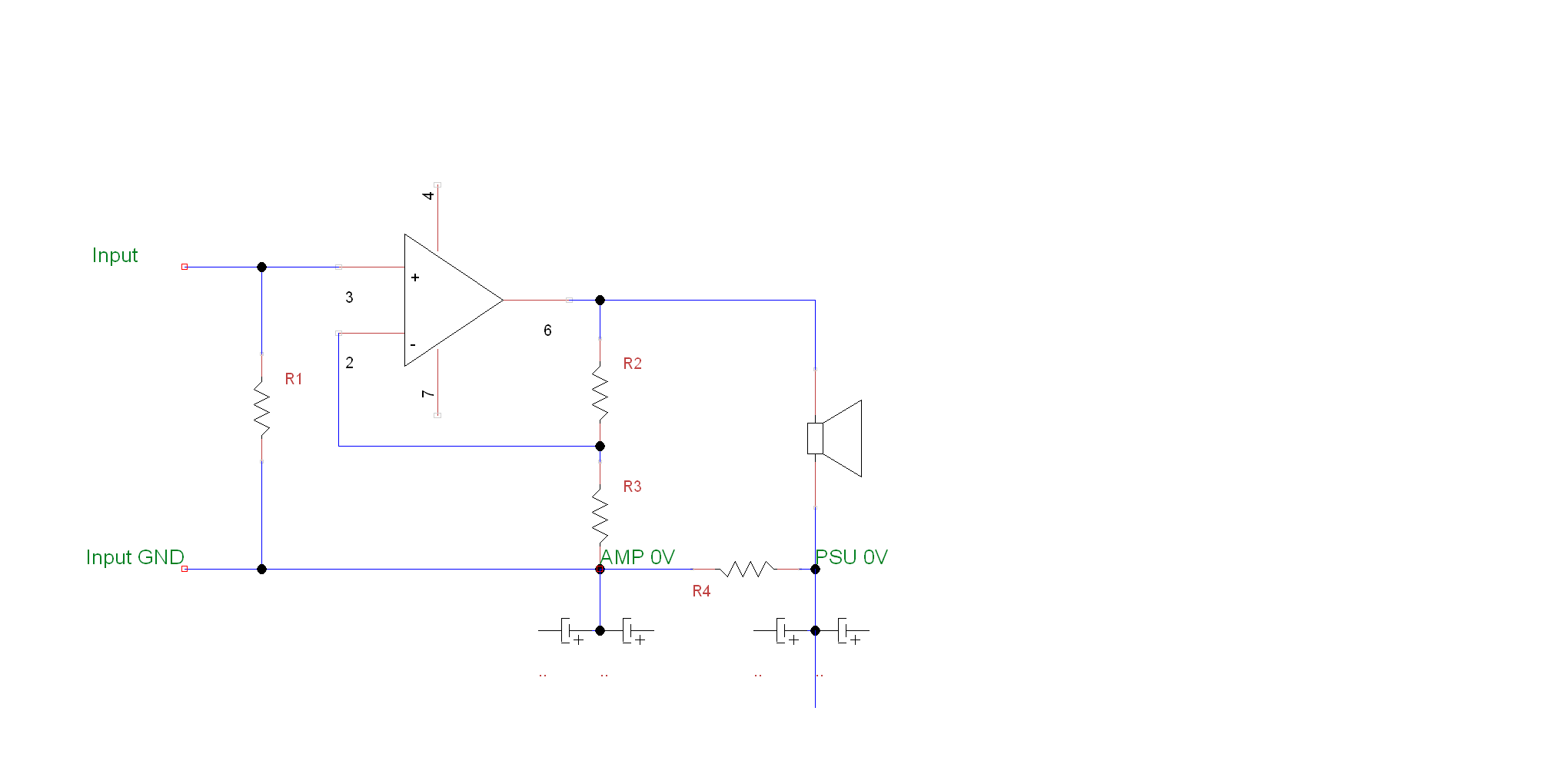

That is what I have done. If you limit the voltage over the HBR to about 1V with the diodes, it will prevent a 1ohm 1/4 W resistor from going open in the case of a current spike that can happen when connecting equipment together. In my opinion, the HBR is not a safety problem when used in an audio amp. Different story for an instrument amp where the input ground is connected to the instrument.
If the HBR fails and the feedback loop is broken, the amp will go open loop with full negative rail on the output.

This is a good trick - I've had a 3.3 Ohm 0.25W HBR go open circuit and back to back diodes like this would have probably saved the resistor.
I see the implementation .... There are two diodes in parallel with the resistor. One diode is reversed. One will conduct when the absolute value of the voltage on the signal ground is greater than the forward voltage drop. So,there is no protection for anything other than the HBR -- they represent a bypass.
I suppose this adds bulk to the HBR "system" thus raising the challenge level for those who are retrofitting.I see the implementation .... There are two diodes in parallel with the resistor. One diode is reversed. One will conduct when the absolute value of the voltage on the signal ground is greater than the forward voltage drop. So,there is no protection for anything other than the HBR -- they represent a bypass.

If you take the speaker return back to the PCB, you have to use a HBR on your amp modules to reduce the loop current in the input wiring. Secondly, if you have not placed your input connectors next to each other and bonded them together, you will be very susceptible to noise pickup from radiated field from the transformer inside the amp.
The benefit of taking the speaker return back to the amp module 0V is you minimize the loop area of the speaker wiring inside the amp - you don't want to be radiating potentially large signal related magnetic fields inside the amp.
I've also done measurements and gotten a better result taking the speaker return back to the PCB rather than the PSU 0V common - so, the point is which one works best is very implementation dependent.
Do you mean the 0V at the PSU or on the amp module?
If it’s the 0V back on the amp module, then yes you are correct. But, Ilimzn shows how to mitigate this clearly (and its in my slides in the HBR section). If you take the speaker return back to the PSU 0V your loop areas are significantly larger. And you will still have the induced loop current problem to deal with either way - and it’s as serious a problem as the common impedance one you are alluding to.
You have to keep the 0 V to the amp modules short and thick.

The hum breaker resistor doesn't need to be delicate, it could be a stick of graphite glowing red hot as the linearity doesn't matter at all. Carbon comp has very high surge ability, I wonder if there is anything better?
Light bulb?
