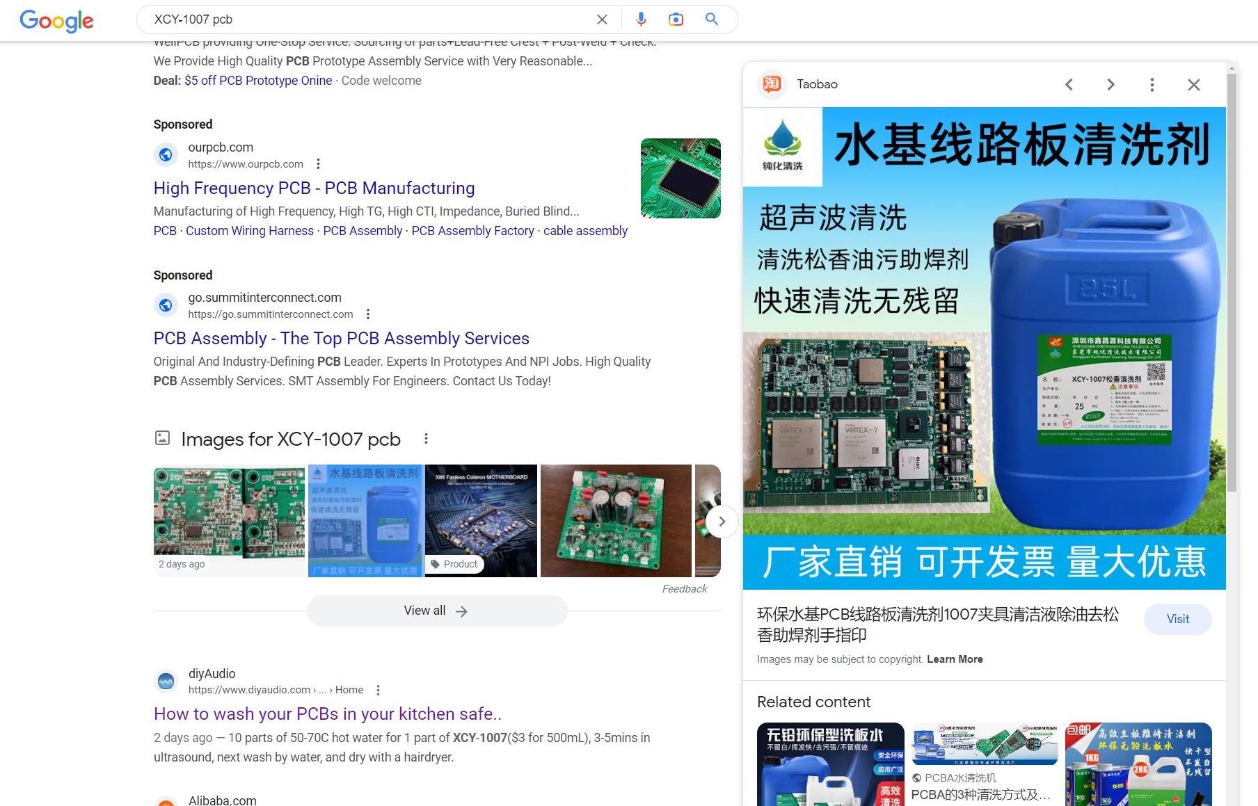

BTW, today I noticed on taobao Mechanic 850(seems HK company) or somethinging like that, they call it "water to wash PCBs". Probably the same water-based cleaner as SWAS or 1007?
China has many makers, ask if the item can be shipped to USA, means MSDS compulsory, which you can look up.
