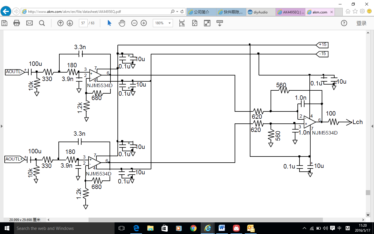

I wish to use a dual opamp in a DAC output circuit that uses two single opamps. The reason being I recently used a MUSES01 in a DAC that uses one dual opamp for both L and R channels and found it is extremely good that I wish to use the same opamp in another DAC board that uses two single opamps. The output circuit does not show the ground pin but there is a ground pin on the PCB in each channel that uses two single opamps. Do I just forget about the ground pin?

A single opamp package has one opamp fed from one set of supply pins. A dual opamp package has two opamps fed from one set of supply pins. You can combine two single opamps to get two opamps fed from one set of supply pins. You cannot separate a dual opamp package into two single opamps each with their own set of supply pins. As others have said, opamps don't have a ground pin.
So if you need separate supplies you can't do it; you can't separate what is joined within the package. If you are happy with common supplies then there is nothing to do, as the dual opamp already does it.
Are you (the OP) talking about using an existing circuit board, or laying our a new one? If the pcb exists, then adapting a dual to fit in the footprint of a single is possible, but probably not available off the shelf. You could make a daughter board style adapter, but the question then becomes "Is it worth it?".
RE re re reading your question, and assuming a couple things which are not clear:
1) I assume you already have that DAC board, it currently uses NJM5534D (0.84U$) and want to use Muses01 (U$45) instead, because of a perceived better quality.
2) want to get/build an adapter board which allows you the replacement, without designing and building a full new DAC PCB
3) not sure it isn't available somewhere, wouldn't be surprised, but you can easily design and reasonably build , depending on your expertise, an adapter board which connects *one* of Muses01 internal Op Amps (pick one) to a male DIP connector matching single Op Amp pinout.
The unused Op amp must be "neutralized" ; standard practice is to short OUT and - IN pins, and tie the +IN pin to some suitable voltage, typically ground.

To clear up my muddy question:
1. I want to use one dual opamp on an existing DAC PCB that uses two single opamps.
2. I don't want to lay a new PCB using one dual opamp instead of two single opamps.
3. The existing DAC PCB that uses two single opamps has a group pin in each channel but a dual opamp does not have ground pin.
My concern is do I just ignore the group pin?

a) existing PCB has a ground "pin"?
Cool, leave it untouched.
You are substituting Op Amps,and neither the old one nor the new ones have ground pins , so I don't see you have a problem.
b) you can't split a dual Op Amp case open and extract one of them, so you'll have to use it as is.
Practical way is to use one and neuter the second one; I suggested one way, Sretten suggests parallelling them , which is an interesting option if application allows it, what you can not do is leave the unused one fully unconnected because it will still share power pins.
