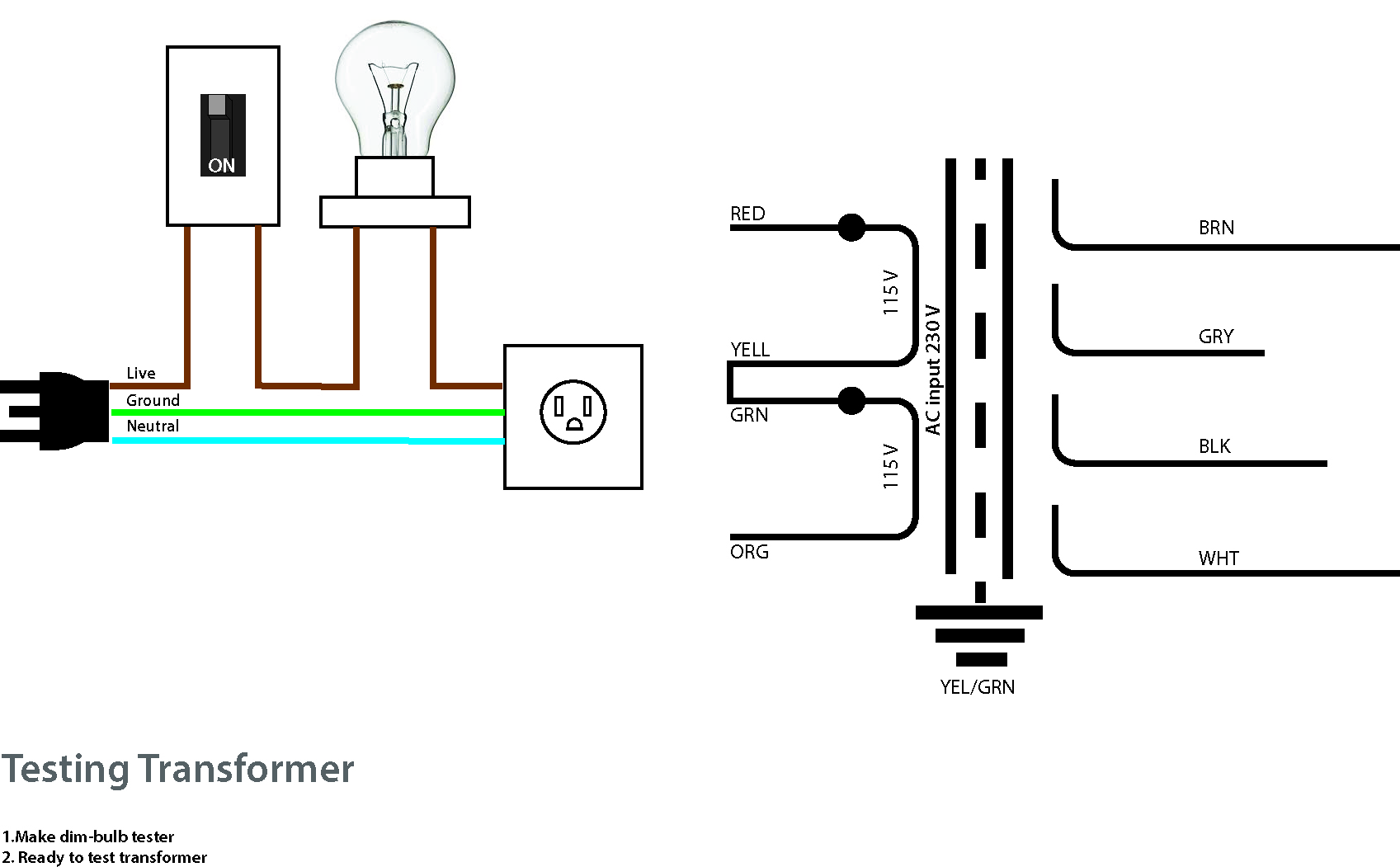

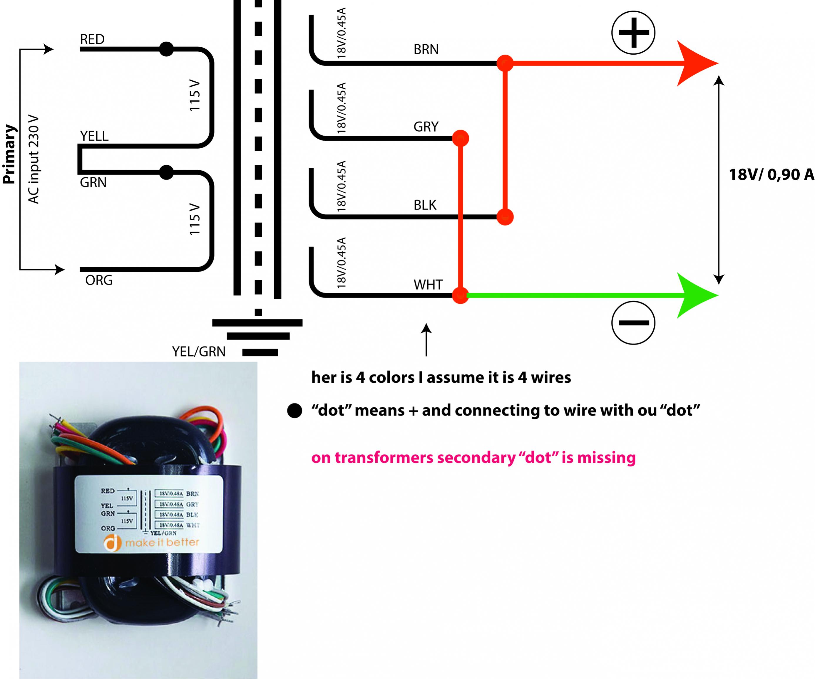

Guys take a look at mine sketches,please comment on mistakes. When we finish correct them I will make nice diagrams.
That Rcore has 4 secondary windings and two primary windings.
One side is phase marked to look like the other side. On the R cores I got from Selectronic, the phase marking, by colour codes on the wires is completely misleading. You end up with a shorted secondary and out of phase primary (no magnetic field = enormous primary current = burnt out primary !!!!!!!
Use a Mains Bulb Tester to prove you have firstly wired the primary correctly and then wired the secondary correctly. Do wire primary first and TEST your wiring.

Find which tappings are on the SAME winding. Label them A & B
Connect one A tap to one B tap.
Power ON via Mains Bulb Tester. Because two tappings are open the bulb should not light. If you accidentally connected A to A and/or B to B then the bulb would light.
Measure the voltage across the two AA tappings.
Measure the voltage across the two BB tappings.
Measure the voltage across the open A & B tappings.

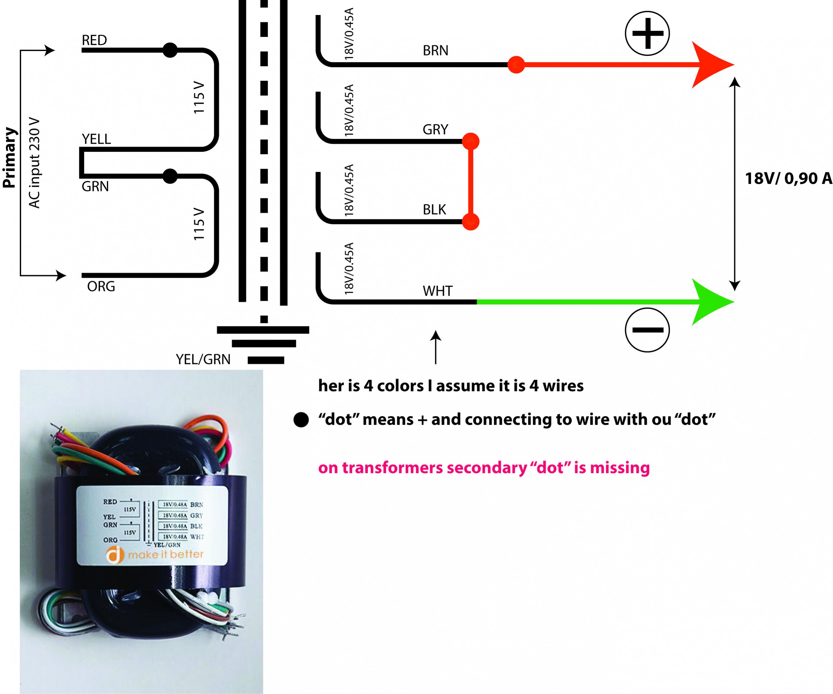

OK guys..have make a drawing Step 1.
Know is a question witch wire where to connect ans what purpose of test it would be?
You are still showing 4 wires for the secondary, but there are 8 wires.
Brn1, Brn2, Gry1, Gry2, ...
You have 18V between Brn1 and Brn2. Also 18V between Gry1 and Gry2. Also ...
To get more Amp from the secondary but still 18V, you have to paralel the wires.
So connect Brn1, Gry1, ... All 4 and also connect Brn2, Gry2 ... Ending up with 18V with 1,8A. But that is not what you want.
If I understand, you want -18-0-+18V with 0,9A.
So you need 2x 18V 0,9A secondaries.
You connect the first 2 secondaries Brn1+Gry1 and also connect the Brn2+Gry2. Now you paralleled the Brn and Gry lines.
This line is now the first 18V 0,9A secondary.
Second is the Blk1+Wht1 and the Blk2+Wht2.
Now to get the 0 point you connect the Brn2+Gry2 and the Blk1+Wht1.
So the -18 is the Brn1+Gry1
The 0 is Brn2+Gry2+Blk1+Wht1
And the +18 is Blk2+Wht2.
The problem is to know which line is 1 and 2 at all the colors.
Because if you connect Brn1+Gry2 and Brn2+Bry1 then you will force the secondaries to work against each other.
This is what AndrewT is trying to describe. That is what the dot is for.
Hope I'm understanding the problem.
