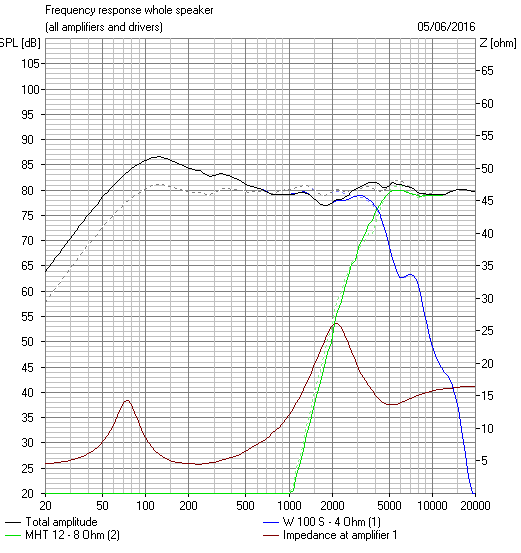

Your problem tweeter curve is a little tricky to correct as shown. It can be done, possibly by increasing series resistance but I think the issue is the simulated baffle diffraction.
This issue might be overstated by the sim. Not only this but it is not a problem that can be (or should be blindly attempted to be) fixed by a crossover.
The tweeter appears in the sim to be being run too hot. If it were me I'd cross the tweeter without the diffraction simmed, and attempt to reduce the diffraction only if it is a problem using something absorbent on the baffle.

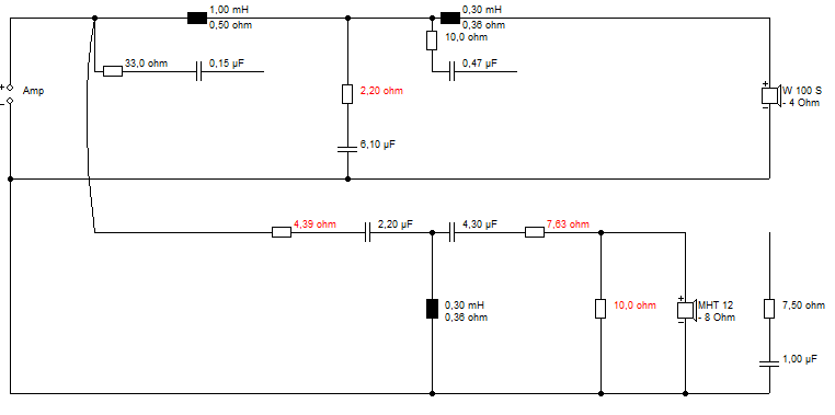

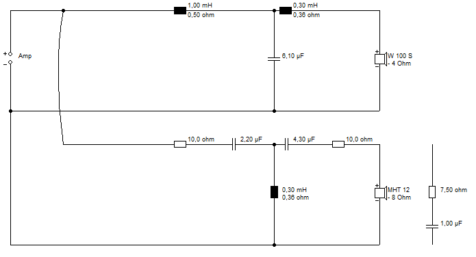

Your build is just a 300Hz lower crossover than Paul Carmody's. It's otherwise identical. I used an 8mm offset on relative acoustic centres and it lines up either way.
Something is exagerrating the top end of the tweeter. Maybe your FRD file is not exact. Off-axis it should be flat enough.
Possibly a tweeter Zobel would help with a couple of dB at the very top. TBH, I would try to get nearer preferred values like 4.7uF and 6.8uF. Easier to buy.

It's normal if you use too low capacitor and the rest of the bandwidth is so attenuated. It's not normal for a woofer to have such a low sensitivity like yours. Check again the FRD of the woofer and make sure it is "normalized" with the tweeter FRD.
In fact the two crossovers are almost identical. Any problems with a peaky high end are inherent in the ribbon tweeter.
Paul Carmody thought it sounded OK, but there is a tendency to a bright top. It's in the FR of the tweeter. A diffraction issue in the rectangular diaphragm, IMO. These things can sound bright on axis.
It's one of those things that are a balance really. Power response versus frequency response.

Well, It's good to know I got so close on my own to what a more experienced designer did. I used a real-time analyzer to look at the peak as I was moving the mic around, it did diminish off-axis, but honestly not as much as I hoped.
I measured the tweeter 3 times, triple checking my set-up, and I, too, used an 8mm offset and it lined up pretty well.
I think the bottom line is that my expectations for a speaker of this caliber were too high. Don't get me wrong, they sound good. I think I was expecting reference quality. I also can't do tricks like put a soft fabric on the baffle - I don't want to cover up my woodwork!
I believe the reason my ears prefer the brighter setting on the woofer is because in the current physical location that 115Hz peak is very audible, and so is the 12kHz peak, therefore I felt like it was lacking in the presence range.
We will be moving soon and these will go in a larger room, where I think both of those issue will be more negligible. I think I'll take your advice and move my values a pinch toward Carmody's.
The biggest challenge here is only have about 3 hours total tweak time (my last project was probably ~30 listening hours). So I'll just be sure to leave it accessible for after the move.

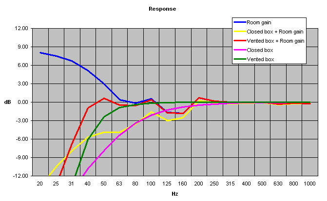

Crisis or opportunity? The reality of finding a source position that boosts below 100Hz might just give you a dip at 115Hz. At these frequencies the room has the more significant influence and it is worth playing the juggling act.in the current physical location that 115Hz peak is very audible,
Opportunity, for sure, but only with a redesign. The lack of presence in the bass must be due to the single bass drivers. Twin basses just project better.
AFAIK, room acoustics exert a big influence on perceived bass. But how it seems to work is that dual drivers, or a cylindrical topology fall off less with distance in a big room.
TBH, there's no replacement for displacement with bass, so bigger drivers work better, but doubled-up small ones have strengths.

Sorry for a miscommunication here. I mean the "presence" region as in 2-5kHz. These have an amazing amount of bass - no problem there. Both drivers have a small dip around 4.5kHz and somehow it's audible even with the rest of that region is a bit hotter than normal. Though, I'm wondering if applying this zobel network will change that perception.

I've just realised you are using less bafflestep than Paul Carmody:
I think you need to raise the tweeter level 3dB to achieve his balance. Quick and dirty, just change the 10R to a 4.7R at the input. It helps the slope too. There's also something to be said for putting a 0.47uF across the 0.3mH in the bass filter, a la Louis Coraggio's Piccolata.

I ended up splitting the difference and going with 7 ohm. I might brighten it up later, but I'm pretty happy with it for now, considering I've had only about 4 hours of listening.
Sorry if the picture is sideways - it's not on my computer, just on the website . . .?
What does the "0.47uF across the 0.3mH" accomplish?

Two follow-up questions- What are you using to post the XO schematics? It looks so much nicer than my screenshots of PCD 🙂
And of all the designs I've seen, it doesn't look like anyone did any cabinet bracing. What's up with that? There are certainly frequencies high enough inside the cabinet to resonate those small panels, and with only .5" walls I'm sure we're wasting just a smidgen of energy (not that these are short on power).
The simmer I use, mainly because I like the optimiser function when I get stumped for ideas, is Visaton Boxsim: Downloads
You just mark appropriate components "optimize" and the computer does it's best to improve it. TBH it's useless on BW3 since it always tries to phase align, but I have workarounds. You can also adjust acoustic centres to correspond to baffle alignment, but I guess most sims can do that.

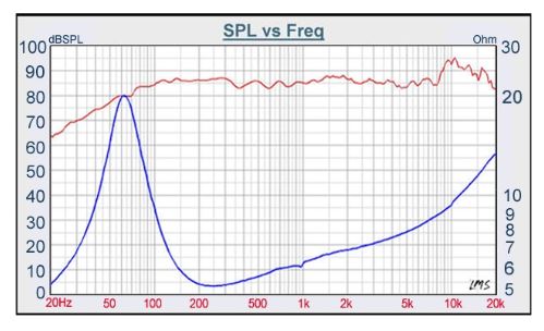

Your TB W4-1720 4" woofer looks like this on FR:
Clearly a bit of an issue with bass cone breakup at about 10kHz. Hence the notch idea. Is it overly fussy to fix it? Is the rising tweeter top end worth fixing? It's your speaker. 😀
Below are some elements you might try. Minor tweaks really, but they all do something good IMO. The 7.5R and 1uF zobel does interact with the 10R tweeter shunt, but you might settle for 22R. This is the game. Where do you say, enough! I'll stop there. 😱

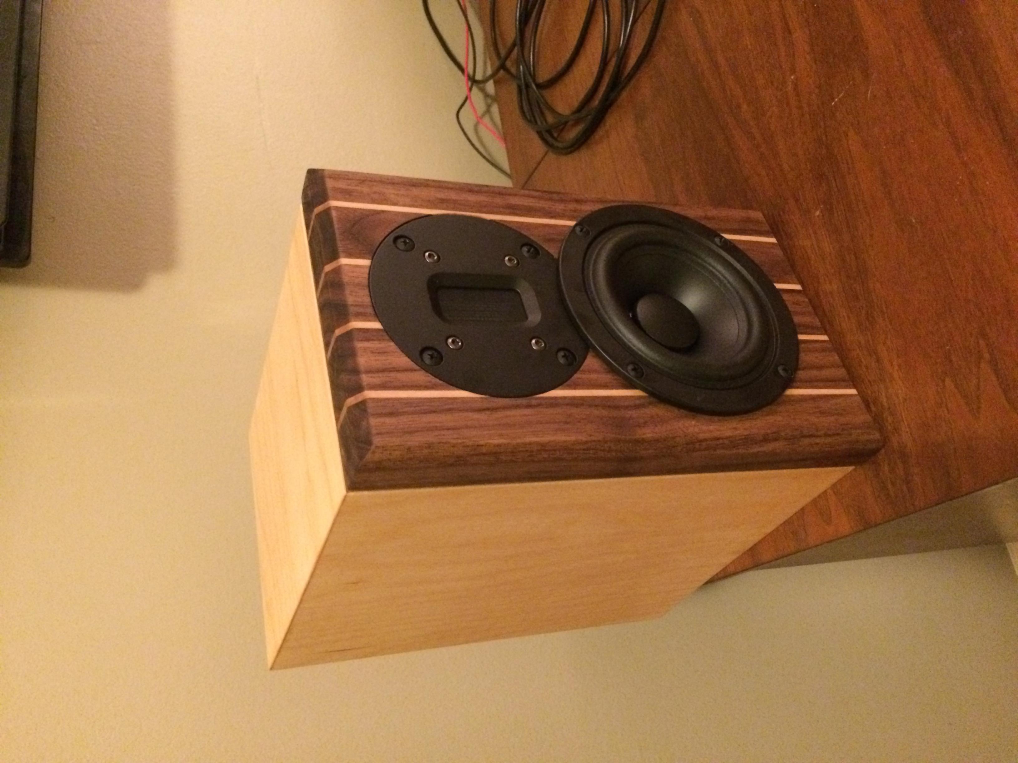

Nathan, that was fascinating, and a really good project well executed. 😀
Definitely Paul Carmody's Speedster improved, and I think you CAN stop there. These are pleasant speakers IMO. The necessary highish 4kHz crossover and tiny bass are the main factors, and you've done well with them IMO.
