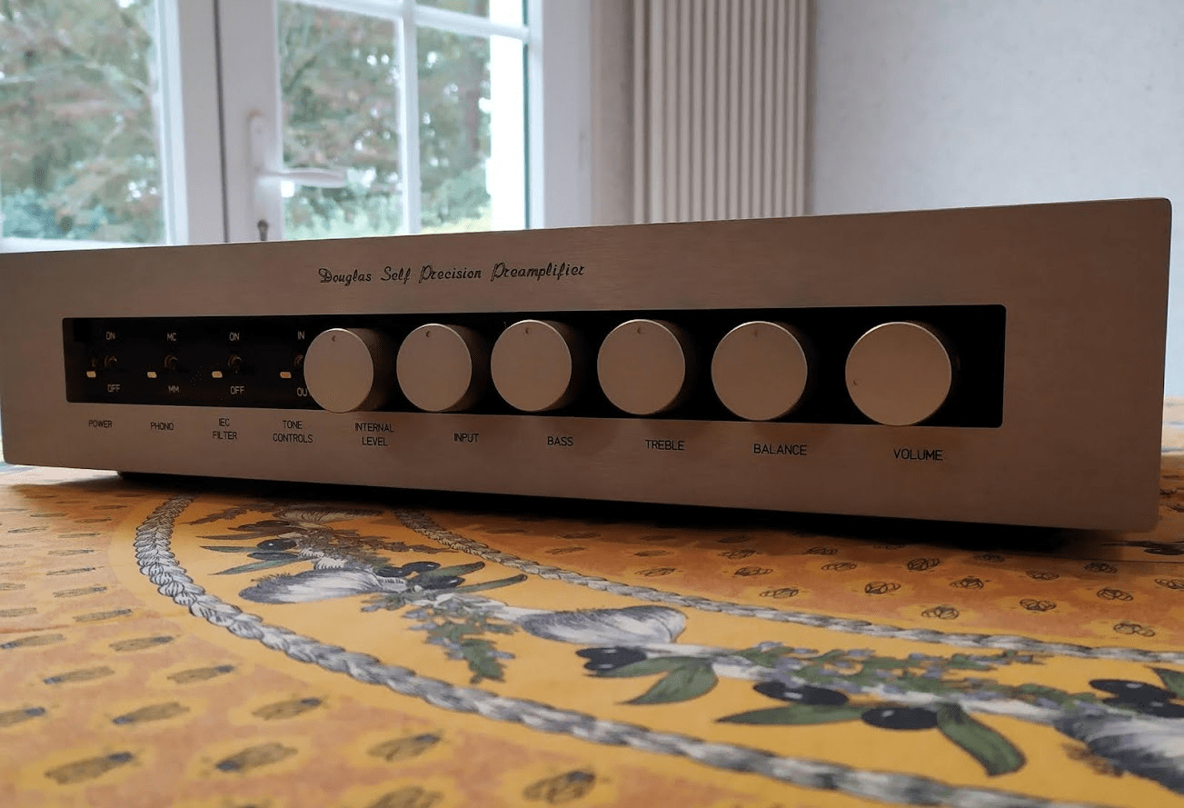

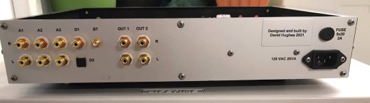

Like this ?
I did it with Schaeffer's Front Panel Designer. It took a while to achieve proper design and placement though.
The construction album is here https://photos.app.goo.gl/uokQftXSwhSfjHik6
Like this ?
Easy : download the software (https://www.schaeffer-ag.de/en/front-panel-designer/?lang=en) and once completed, send them your project for fabrication. You can even send them your own material for them to process it, which is what I did.
https://www.schaeffer-ag.de/en/front-panel-designer#functions
I kept the file for this project, if it fits your requirements I can email it to you.
There is also Front Panel Express in the USA, if that helps.
https://www.frontpanelexpress.com
I used them for the front of this project. The lettering is engraved and then filled with ink of your color choice, so it's very durable.
Quality was good and price was reasonable.

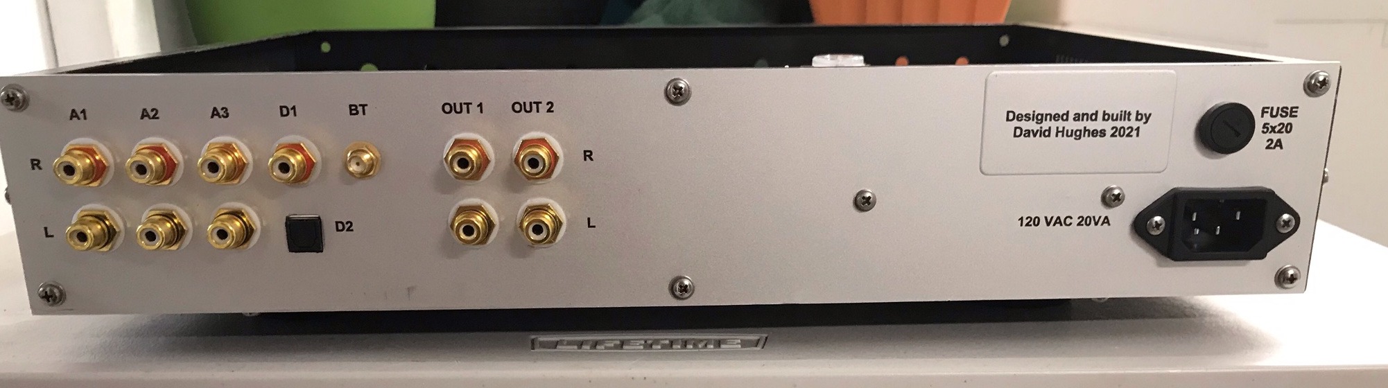

The back panel I did myself with the toner transfer method, which frankly is a bit tricky to get right.

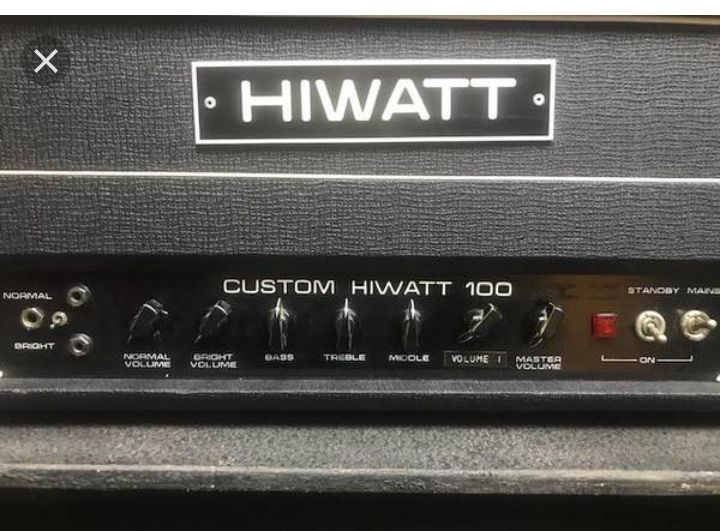

Done for decades by HiWatt amplifiers of Pink Floyd, The Who and other Guitar Gods fame 😄
They didn't use CNC (not yet invented) but mechanical Pantograph engravers, then filled carved lettering with paint or coloured wax crayons.
They also used "sandwich" type acrylic: a white core with a thin black layer laminated on top.
Engraving exposes the white below; very tasty.

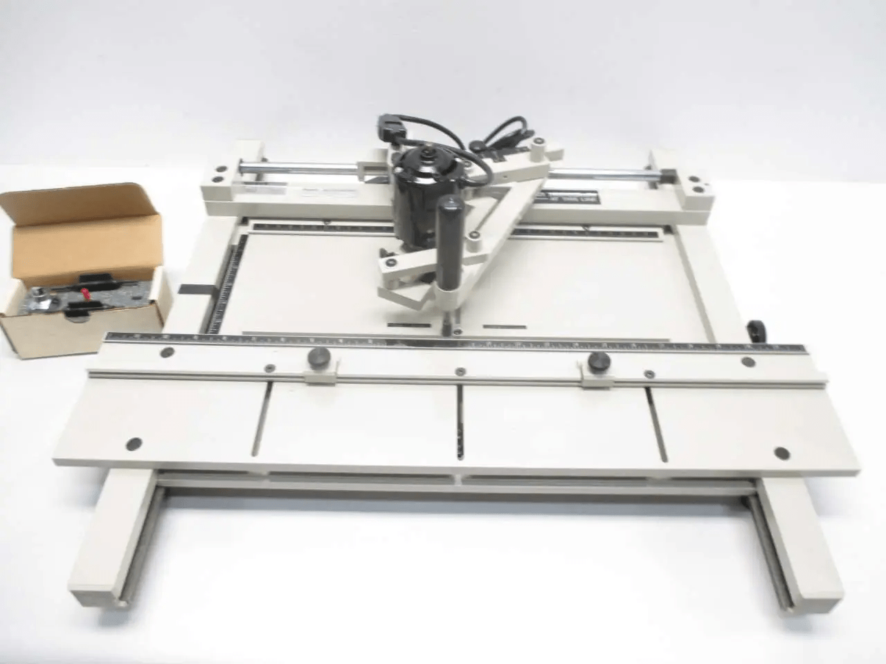

I am still making my control panels and nameplates the exact same way, using the same Lamacoid material and my old Scott Signgraver pantograph.
The material is still available in a multitude of colour combinations, although it's a lot more expensive now.
I worked in a printing shop after school when I was a kid, and I was well instructed in the operation of that machine. When I began building custom industrial electronics, this was one of the first tools I purchased. I'm still pretty quick on set-ups, haha.
Interweb pic, but I use the same model machine:
