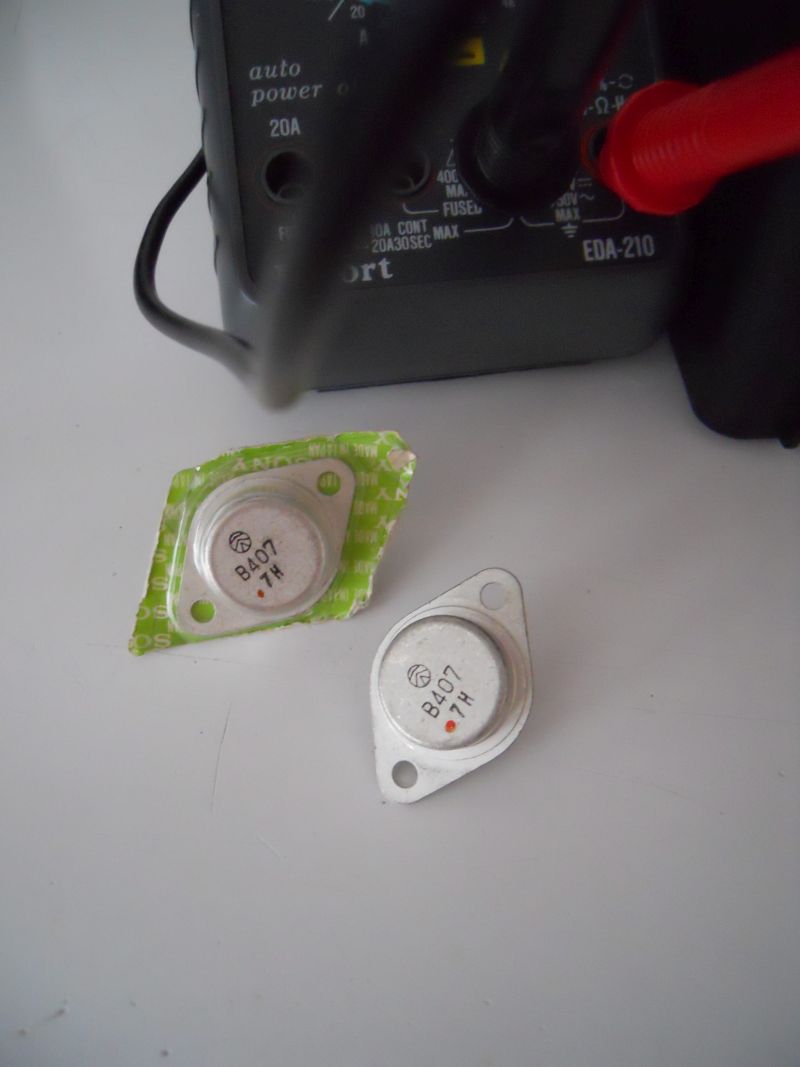

I you can get a datsheet, you can do a Iceo test. Try datasheetcatalog.com first, theirs are more complete than alldata
If they are TO3 like in the picture, then collector is case. If you look at the lead side with the long dimension towards you, base is usually on the left, emitter is usually on the right.

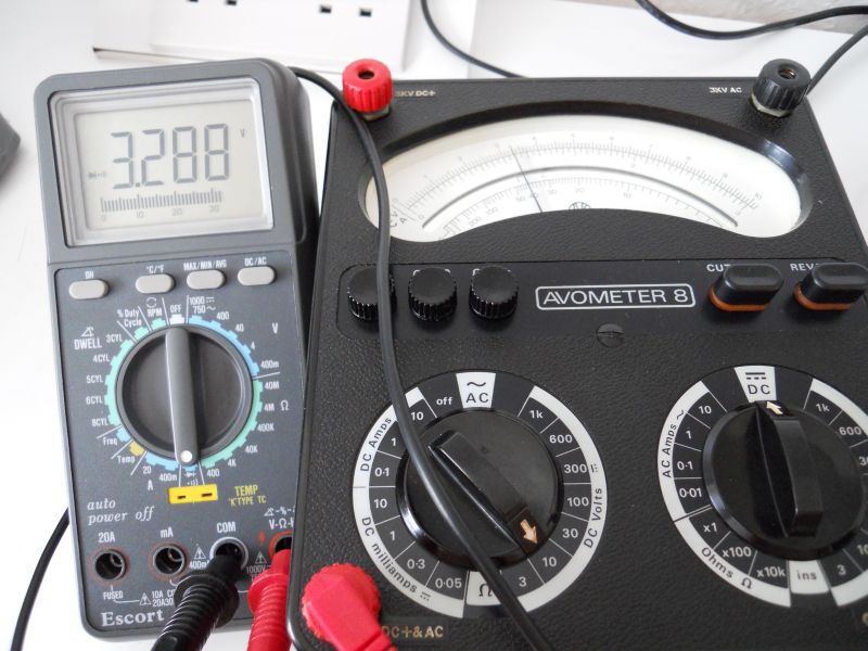

Here we go and the devices tested just happened to be
First shot shows that the DVM on diode range really is displaying its own test voltage across the terminals. That voltage is read on the AVO as proof.
The meter and its range makes an enormous difference to the readings because of both the test voltage used and the test current that flows. The AVO on low ohms ranges uses a 1.5 volt battery and on high ohms ranges a 15 volt battery.

The AVO has very specific ranges and the scale is non linear for resistance measurements. You can see the x1, x100 and X10K ranges on the right hand switch. So you need to use a range that gives readable resolution for the test in hand.
The X1 and X100 ranges use the 1.5 volt battery and so that is the maximum voltage that can appear at the leads, and as you say, it isn't enough to get a reverse biased junction to breakdown. The high ohms range is great for identifying leaky silicon devices that a DVM won't pick up on.
