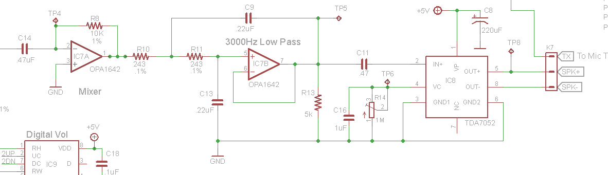

Ok lets see if I can get this to upload an image of my schematic. I want to be clear, there is no problem with running this thing in BTL or SE modes. It will fill a room with clean sound on a 9V battery.
The problem I have lies in the fact that a bridge tied load uses both terminals of a speaker. (It has to do this because the signal is floating at half VDD). In my case this removes any access to the common ground that a microphone PTT needs to activate.
Connector K7 leads to a 3 terminal jack where the speaker mic plugs in. On previous versions I used a LM386 amplifier where the 7052 is now. In that configuration the speaker uses common ground and the PTT functions fine. This whole exercise is an example of project creep at this point.
I tried this to see if I could get the circuit to work in BTL mode and somehow find a way to provide a ground path for the microphone to function. I don't have the microphone circuitry unfortunately. In any event I believe the answer lies in the mic. I need a mic circuit that allows the speaker to operate as a bridge tied load while providing a ground path for the PTT.

ah, i see now.
hmm interesting problem.
a not so obvious solution would be a transformator , lol.
1:1 ratio, ~8 ohm on the side where the 7052 would connect.
on the other side you can then have a ground references output just like if it was single ended all the way (i think)
question if it would worth it at all.
i'm not familiar how the push-to-talk stuff is achieved.

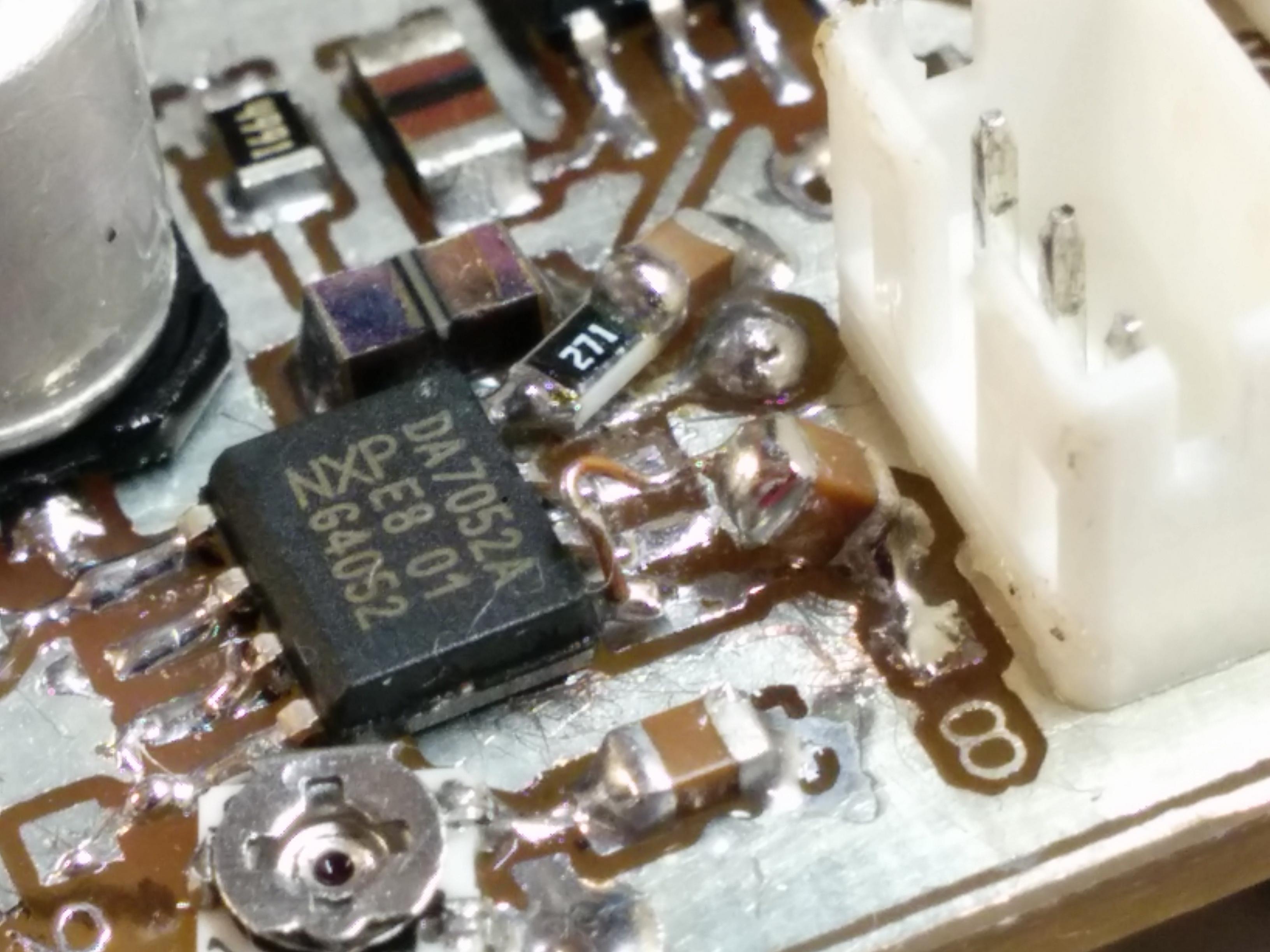

The transformer idea might actually work but it's impractical considering the size of the board. Shown is the top layer and as you can see it's not much larger than a 9V battery. The 7052 is in the lower left corner with K7 to the right. I think I'll try to find a 2 plug mic and see how that works out. I'll post it here just for interest. Otherwise it's back to the old 386 and this board delivers music in my shop.

How about tying a 100ohm resistor between the+ and- outputs to satisfy the chip and then the 8 ohm speaker and a cap in series with the speaker to ground and + output.
Interesting idea however after thinking about it I don't believe that's any different than single ending the chip the way I did it earlier with a cap in series off the the positive output and a 50 ohm resistor and cap in series to ground off the negative output. Added a pic to show that on-board adaption. The 100 ohm resistor would sit at half the supply and prevent the speaker from seeing anything other than the positive output which is only going to be a few mW of output. Again it's not enough to drive the speaker.

Yes it would definitely drive a ouple of power transistors but I'd go back to the LM386 before I did that (thanks anyway for your input). The TDA7052 is designed to work bridged and it does it well so I'm keeping it in there if I can. Single ended using one output is fine for an earbud or mono headset but that's it. I'm talking to a manufacturer about a speaker mic wired to work the way I want with positive and negative speaker, mic and ground pins on a single plug.
Looking at those drivers now. Are you suggesting a push pull section driven by a single 7052 output? Version 1.0 of this device used a push pull final section and I immediately moved to the LM386 in ver 2 to reduce distortion effects at higher volumes.
As suspected the solution was to get a speaker microphone wired for a bridged load.
One thing I did notice though was the heat. Had it running a fairly large speaker in my shop for a day which probably drew the full output capability of the chip. Could still hold a finger to it but I was suprised at how much heat it was producing. Since this is a communications system with a modest duty cycle it won't be a problem but for heavy duty applications like music it would be a consideration. Whats out there for heat sinking on SOIC pakages and the like? Other then sufficient copper pour to wick off the heat what options do you have? I don't do much in the way of audio circuitry so heat sinking is rarely an issue for me.
Thermal adhesive (applied carefully so that it doesn't smoosh out onto the pins), can stick a little heatsink, like the Mini 2CHANNELS TPA3123 Class D Digital Amplifier Board Assembled 20W 20W | eBay TPA3123, ebay#321232086753 Have a look at the heatsink on that listing's photograph.
Alternative: Computer motherboards hold a heatsink on with a metal spring to keep it in place, and with that approach, ordinary white thermal paste is used. Arctic Ceramique is non-conductive and may be used.
Alternative: Fairly thick traces can be used, and they can be left uncoated, so that they may be fluxed and solder added to the traces to further thicken them. This will efficiently draw heat out of the pins. Its very easy with PDIP, but not so blissful with SOIC.
Assured stability is an additional way to run the audio amp a little bit cooler.
Really good decoupling (such as nearby 47u~220u) caps next to the chip, will probably run cooler than ringingly large 1000u and larger caps (no problem, large caps may be used after installing the smaller caps).
And, how are you set for cool air intake vent (under) along with hot air output vent (above), for convection airflow path to remove heat?
An emitter resistor could cool it off, but at some cost to output power. The linearity may improve with that approach though (depends on the needs of the speaker). Some frequency contouring is also possible, with an emitter resistor paralleled with a small value cap, such as 0.68u.
When it comes right down to it, best results may necessitate a more efficient speaker with a lighter load. A 100db efficient 16 ohm or 20 ohm speaker may be suitable (and scarce). That kind of speaker was commonplace from the late 50's through the early 70's. Today, you'd be looking at an MTM or WWT, involving a pair of Very high efficiency 8 ohm speakers in series to make a 16 ohm load. That will cool off your amp but also thin your wallet.
You could cheat a little with the audio coupling if you know your target speaker bass frequency response capacity. This idea is useless for a 15" speaker but may be even vital for a 4" speaker. Reduce the size of the input coupler cap (application may also depend on source output), the negative input coupler cap (its probably already too small, so there's no need to change that one) and the speaker output cap (give it one if you don't have one). . . until the caps are just barely big enough so they don't interfere with bass response from the speaker. If installing an output cap on an amp that doesn't require it, put the cap on the speaker negative.

A comprehensive answer full of good info. Unfortunately most of it cannot be applied here.
This audio system is in a small waterproof box so no ventilation at all. All components were selected for their temperature range for that reason. To make matters worse its going to be strapped to a tactical vest in 30 degree heat and pounded into the dirt so anything likely to come loose like a spring or even a conductive adhesive is a poor candidate. I have no idea what the enclosure temperature will get to.
Frequency shaping the output isn't really an option either I would think since it's all filtered though a 3KHz low pass ahead of the chip amp anyway .
Input coupling is done at every stage using .47uF metallized acrylic film caps. The BTL output should not be coupled. Supply decoupling for the 7052 is done with 220uF electrolytic however I'm not sure it's doing much with the regulated supply. All mixing and filtering are done with Panasonic ECPU-A series caps and .1% thin film resistors to assist in stability and reduce noise, both positive and negative supplies are regulated and every chip on the board except for one logic inverter is decoupled.
I have no (or very little) ability to control the speaker selection since I'm restricted to available (and suitable) speaker microphones which is generally 8 ohms.
I could look at output resistors but the entire board is about the size of a 9 volt battery so space is very limited as it is and heat in the chip or in the resistor still has to be dealt with. I could go to an all metal box and try to use that for cooling somehow but weight is also a consideration and previous versions used tough ABS enclosures without a failure. Adding significant weight just for cooling one chip is not going to be well received.
In normal use the circuit will see voice frequencies only and the speaker will be bypassed with an ear piece. If an open speaker is used at all it's at middle volumes. The only reason I noticed the heat is because I was piping music through it from my phone to a big speaker for fun. Not a likely field scenario but it got me looking for SOIC heat sink options, I don't see a lot. Originally this was a single ended design and heat issues never arose. The only reason it's now a bridged load is for better sound on the occasional time the speaker is used. In fact I now have to contend with the additional power since all volumes need to be turned very low to be comfortable. Accidentally turning the volume down has happened in the past by rolling around on the control module attached to the front of a vest. That would be even easier to do if the volume was already low. I'm actually considering reducing the mixer stage gain to compensate and adding a lockout to the volume buttons.
I really wanted to leave copper pour under the chip in the initial board design but the area was needed for tracks. If heat did turn out to have an effect I would try beefing up the pin tracks like you mentioned and experimenting with adhesive sinks (I have this scary vision of a heat sink rattling around in there at the worst possible moment).

if you could mod the small waterprrof box, then you could actualy use that as a heat spredder.
how far is the chip from hitting the wall of the box?
prehaps all you need is to make a cut, glue a piece of aluminium on from the outside with a good glue, to keep it waterproof.
then , if the gap is not too large, you can use thermal pads to make the chip contact the newly made heat spredder.
if the gap is too large for that, you might need some wizzardy done to the aluminium sheet. i see no reason why it could not be done.
maybe you gona have to make the aluminium shaped into a Z form,
the top of the Z glued onto the box, the mid part would sortha act like a spring, and push the bottom of the Z form against the chip. then the thin self-adhesive thermal pad (sticker style) can do the rest of the work.
shock resistant for sure, still maintains serviceability if needed, and will keep the lil bugger cold.
We're on the same page. While writing the last response I realized that all the chips on the other side of the board actually contact the enclosure (like I said, space is minimal). If it became necessary I could relocate the 7052 to the other side and glue a thin sheet of heat sink to the enclosure wall.
Just reduced the mixer gain by 10 to allow more headroom on volume control which worked out well. The 7052 only had to draw a mA more if that. No I think I'm going to go without a sink on it if for no other reason than a test of its capabilities in this application.
