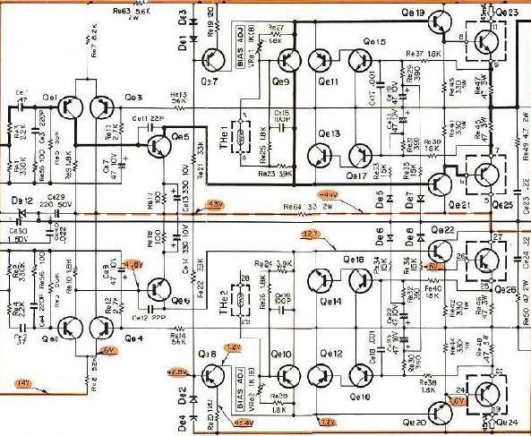

How to set Power transistors on Kenwood ka-5500?
Richie,
Well, I can’t find a good reason to attest my reasoning except that of course we aim for the lowest possible offset first. 🙂
Lipaso,
So, lets get rid of that dummy load. 🙂
45mV across the emitter R’s results in 95mA. That’s too much. You need to set the voltage at 20mV.
I can see no trimpot to adjust offset although 23mV is not that high.
/Hugo
