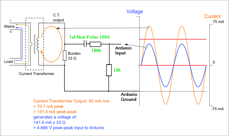

Thanks, yep I am aware of the aliasing issues. But I am not looking to adequately sample the signal, only average out the amplitude of the signal for a rough calculation of output power.
Any reason why this wouldn't work ? Nice & simple & Extremely low cost. Should be less than a £ 🙂

Ron E said:
Haven't used arduino for signal processing. I think arduino is pretty slow, maybe 5-10kS/s, you would want at least 40kS/s or you will only read power data below half the sampling rate and could have aliasing issues.
Aliasing will not be a problem as you are not interested in reconstructing the signal, merely measuring how big it is. You can sample as often or as slowly as you like.

Wiggle8 said:
Calculating an RMS value for my power calculation is where I am struggling. Is it reasonable to simply collect a good amount of data points (say 20) over a period of 0.25 seconds, store them in an array, square each value and then divide out the number of samples and take the square root?
RMS=sqrt((sum(VALUE*2, i=0..20))/i)
(where i is the number of samples)
That would work. However, you might want to maintain some sort of moving average or low pass, so you get a smoother change. To 'low pass' over 20 samples:

Measuring amp power is more involved. i did it digitally and the first effort was a disaster. First the power is the product of volts and amps. You can't just measure the volts and the amps. You need to measure the instantaneous power (volt X amps} and then pick an averaging time. You will also need to decide on attack times and decay times. And a digital display will be very hard to read if those are too short. (I got a patent on that, not my best work but it looks good in the portfolio).
HP has a discussion on sampling AC voltage accurately in the writeup on the HP (Agilent Keysight) 3458 Page 15 here http://www.hpl.hp.com/hpjournal/pdfs/IssuePDFs/1989-04.pdf (25 years later its still the most accurate lab DVM.) However you will need to sample voltage and current simultaneously and then do a lot of math.
Doing this gets some interesting and unexpected power numbers with speakers and their changing impedance. Its also possible to show instantaneous impedance.
