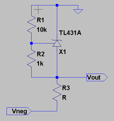

Well, I want to use the tl431 to regulate + and - 12V suplies, and since it's a shunt reg I know it's possible to regulate the negative rail as well, but my question is, how exactly? In a text book circuit for this reg, I'd have a resistor on the rail and then a voltage divider feeding into the TL431, correct? The output voltage behing (1+R1/R2)Vref R1 and R2 being the top and bottom (connected to rail and connected to ground) resistors in the voltage divider respectively, correct? So in a negative reg I'd use a resistor on the negative rail, then again a voltage divider feeding into the TL431, that I know. But if I want the output voltage to be -(1+R1/R2)Vref, then must R1 be the resistor connected to the negative rail or the resistor connected to ground (and R2, obviously being the other one)? I'm gathering that the R1 would be connected to the negative rail, for this would simply result in the same circuit as the positive reg, except with a negative rail and the TL431 flipped, which, would work, right?
Thanks for any replies, I'm just not too sure about this, I would try it myself, but the TL431s haven't shown up (ups ain't that fast) and this is bothering me, I'd like to know.
Just hook it up like the attached picture. Example is for -27.5V. Bias resistors shown are a bit too low in value, resulting in 2.5 mA through the resistor string. You'll probably want to reduce this by increasing the resistor values.

Ah, thanks, I guess I can start work on the pcb layout now 🙂, just gotta wait for the TL431s, that's all that's missing for this project.

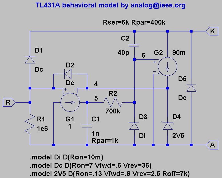

Thanks again, but on another topic, I see you used LtSpice to make the schematic, how did you add the TL431 macromodel? I can't seem to figure out how to add models except for the BJT or fet or whatnot models...
I got this model from the files section of the LTSpice Yahoo users group. I tried using the TI model but had all kinds of convergence problems with it. To join the group you need a Yahoo email address. Sign up with the "no email" option (it's really a mailing list archive), then you can browse it like a normal discussion group.
There's a .asy symbol file that I put into a directory I created under LTSpice\lib\sym called "Extras". When I do an F2 to add a component, this added "Extras" folder will appear. Browse to it and select the TL431A. There's a matching .asc file that must be in the same folder as your project. It will be picked up automatically. See the instructions that come with the file for more info.
Here's the model. The author, a guy named analogspiceman, looks like he spent quite a bit of time coming up with this. You can see that it models the AC characteristics. I've had zero convergence problems with this model. The Yahoo users group is located at http://groups.yahoo.com/group/LTspice/

Well, start by choosing R1 and R2 (per the attachment above). The current through the resistor string R1-R2 is Vref / R2 where Vref is 2.5 Volts. So maybe choose R2 = 2.49k to give 1 mA. Then pick R1 to get the desired voltage. You want maybe 1 mA or more through the TL431, so that would be 2 mA total in the absence of a load.
So pick R3 = (Vunreg - Vreg) / Itotal
Where Itotal = current through R1 and R2 (1 mA if R2 is 2.49k) plus current through TL431 (say 1 mA or more) plus the current drawn by the load (which should be low in a good design, otherwise you may need to rethink the design).
