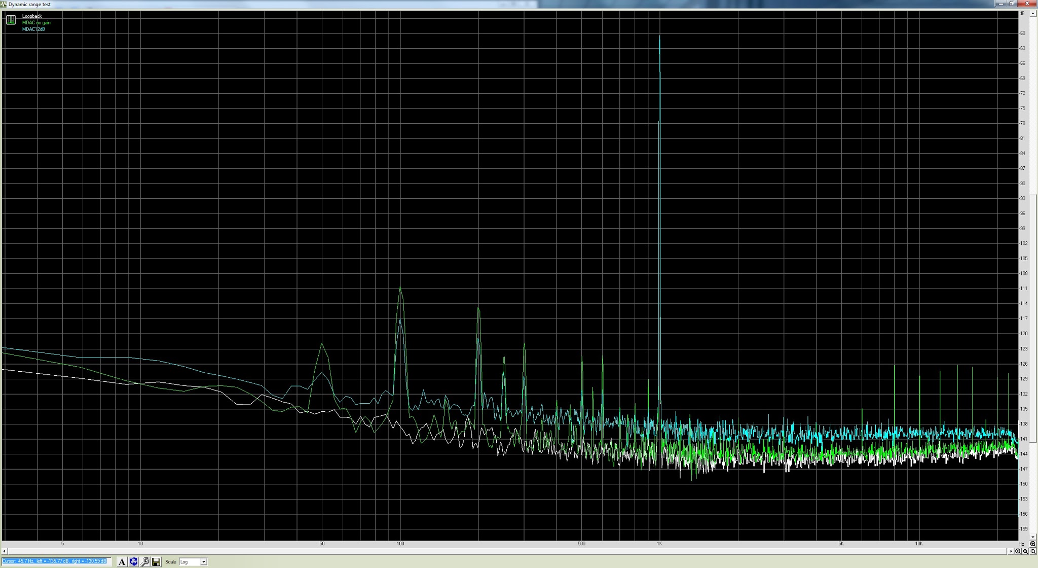

I've designed and tested an attenuator based on a multiplying DAC and an opamp. It works really well but I'd like to know if there is any changes I could make in order to improve performance, mainly noise and dynamic range.

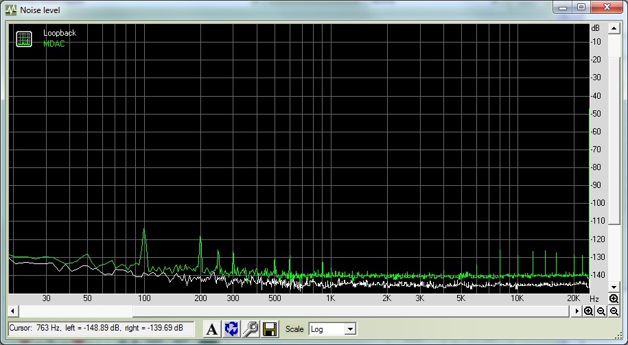

Using my E-MU 0404 for measurements, I think THD is below what I can measure but see the attached RMAA graphs for noise and dynamic range. I have three items on the graphs:
- Loop back = WHITE
- Attenuator with no gain (R2 and R3 removed) = GREEN
- Attenuator with 12dB gain = LIGHT BLUE

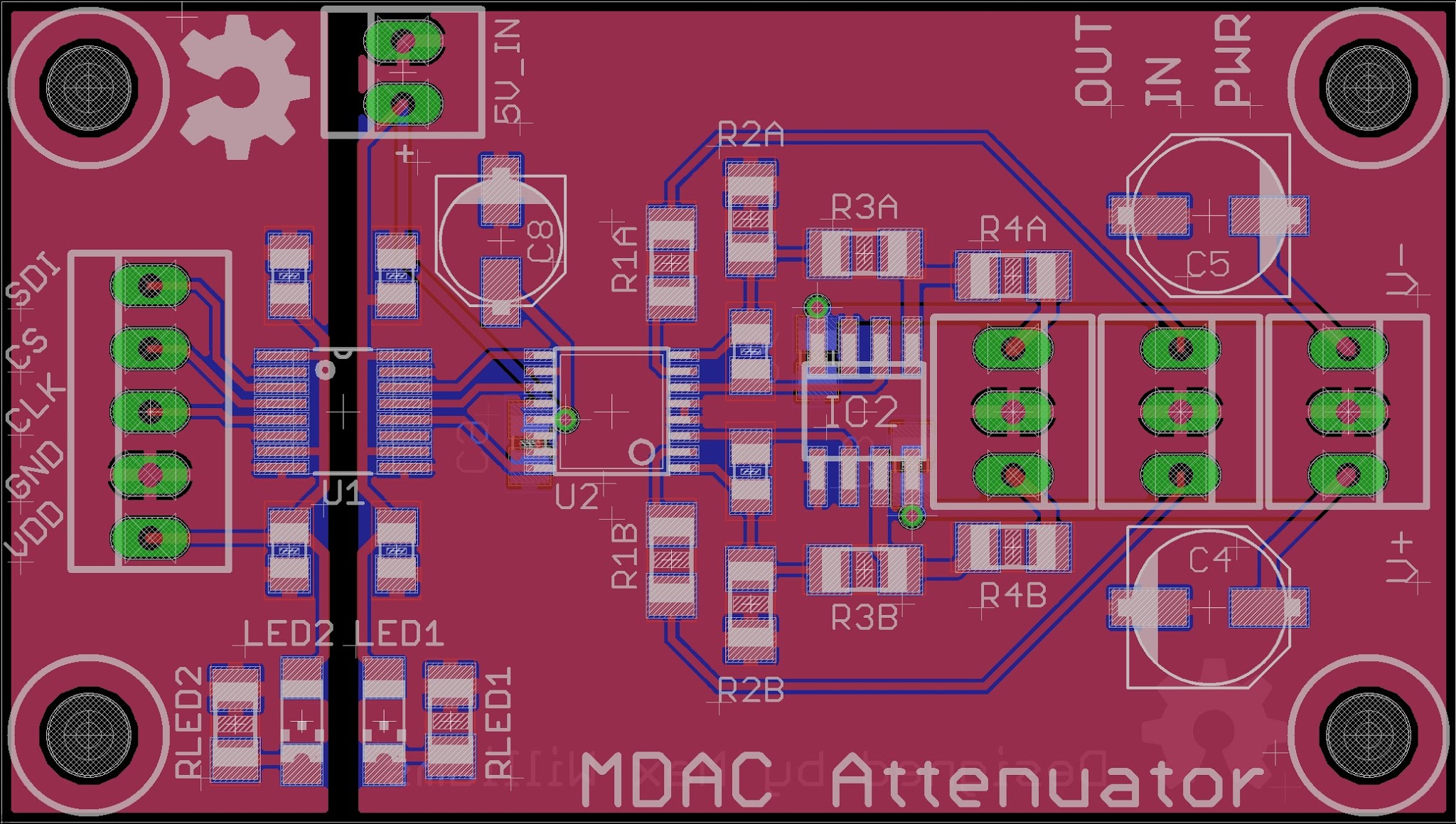

I'd like to improve the attenuator with 12dB gain, the schematic and layout are attached.
Any suggestions??? I'm just not quite sure where to start...
Better PSU?
0805 components and shorter traces?
Mount components on both sides for shorter traces?
A lower noise opamp?

If I'm not mistaken you have a big fat ground loop in the board (plus a small one) that you should break somewhere. Those are the perils of ground fills.
Other than that, where's your absolute noise level at currently? Doesn't look too bad tbh. An AD8599 is a low-noise part but I'm not sure what sort of impedances it sees here.
Can you point out where? That IC 'U1' is an SPI isolator which isolates the microcontroller from the DAC, 'U2'. There is supposed to be a gap there.
Not sure what you mean by that? Is that THD+N? Or just the noise level figure that RMAA gives? RMAA loopback says about -113dB where my attenuator measure -107dB. Does that make sense?
Sorry, I forgot to say, I actually used an LME49720 opamp. Do you think switching to a AD8599 would make a measurable difference? It is 1.1nV/√Hz compared to the LME49720 at 2.7nV/√Hz.
Wait....I guess if I can only measure XdB noise level via loopback then if I'm trying to measure an attenuator with +12dB gain then it's likely I'll measure X + 12dB no matter how good my attenuator is!
Perhaps I need better measuring equipment in this case.
