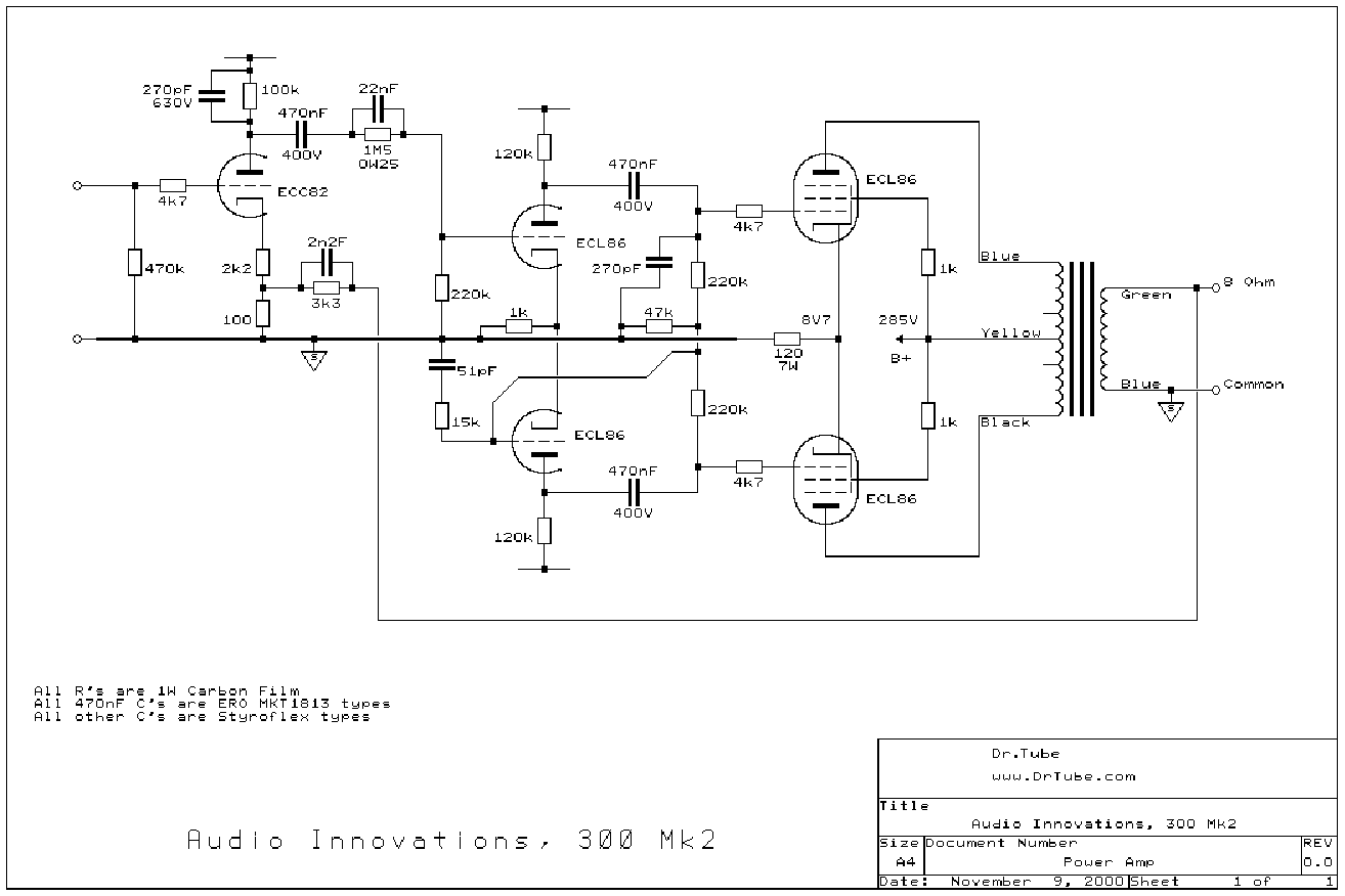

I came across and am uploading the schematic for the MKII version of the S300 amp section. Notice the changes made by the OEM are exactly those proposed by the membership. A lower μ tube (12AU7/ECC82) as the voltage amplifier and long tailed pair (LTP) topology in the phase splitter. All indications point to users other than the OP having "hair trigger" volume control trouble with the 1st version of the product.
The gain reduction by way of re-designing with the 12AU7 in the first stage is one improvement but the MK II does not use a LTP phase splitter cct. It is a little weird in that there are many HF stabilising networks. It seems that the O/P transformers, as in the MKI version, have their cores too close together and this is causing problems with the design.
The original global feedback was 15k rf and 100 Ohms ri.
It was changed to 3.3k rf and 100 Ohms ri.
And that one fact IS the overall amplifier gain reduction.
Right?
The rest is the lowering of Open Loop gain, and changes to compensation parts and compensation topology, in order to make the amp stable and well behaved with the output transformers, and reasonable speaker loads the amp might encounter.
Probably sounds better than the original.
Anybody have the two different versions to verify the fact?
If I owned the original amp, I sure would change the parts and make it similar to the second version.
Just my opinion.

Another item of concern is the scarcity of the 6GW8/ECL86. While not commonplace, the series heater string variant of the type, the PCL86, can be sourced. Look here. IMO, thought should be given to doing what's necessary to allow PCL86 use.
