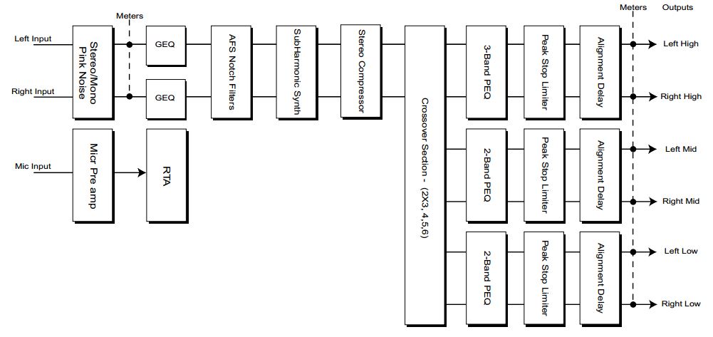

The Driverack will not be useful to him. Although the outputs of the driverack can each be configured for full range output, his 4 speakers are not identical and as such the RTA calibration and GEQ will not work as intended. Attached is the Driverack PA+ signal path block diagram. As you can see, the GEQ comes before the signal is split into the six outputs.

No, it isn't a dumb suggestion. Not many people would be aware of the internal signal path in such equipment. If the GEQ came after the 6 channels were divided, the driverack would be the perfect slice of cake.
Because the GEQ is applied beforehand, the RTA will be fighting itself over the outputs of two completely different speakers. Thus you won't get results better than a cheapo sonic maximiser and ear tuning.

you didn't offend me but your lack of knowledge with respect to the driverack's capabilities is "irritating" the GEQ is manually configurable it's not just tied at the hip to the RTA functions and the PEQ on the outputs would serve to balance the tonal difference in the two box types not to mention the delay functions for arraying the system.

That was a misstatement. The Driverack could be useful to him. I should have clarified--it would be a waste of money. I know the GEQ can be manually changed but what good does that do? A single change will effect both speakers which would need different EQs. You are correct, the PEQ would be useful in that regard but a simple analog PEQ can be had for much less, thus using the driverack for that purpose would be a waste of money, which was my intended point.
The main feature of the driverack is the crossover, which will not be useful to him. This is what I meant.
