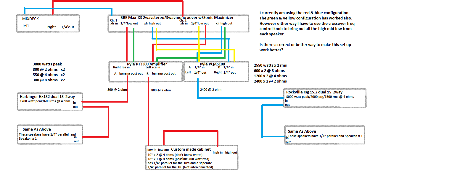

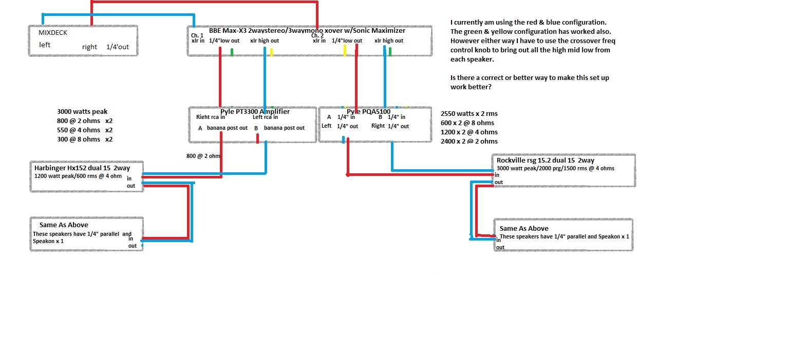

Oh, you seem to be using the BBE crossover as a splitter.
"However either way I have to use the crossover freq control knob to bring out all the high mid low from each speaker"
Unless the BBE has a mode to turn the crossover off which I am not aware of, it is not be possible to get full range audio from the output jacks.

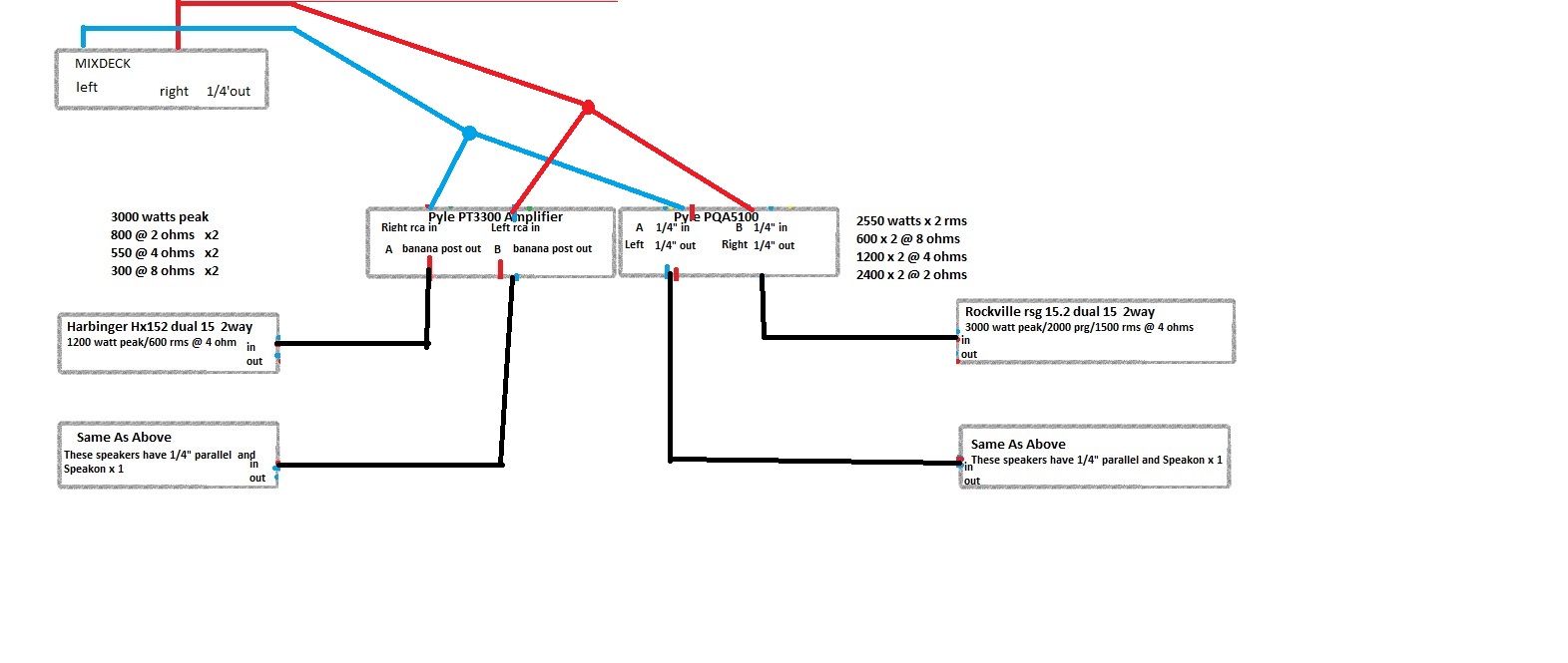

Otherwise, if you don't want to re-wire your speakers, you can eliminate the BBE to get full range audio to each speaker by simply splitting the line level output from your mixer. Not perfect, but cheap and more correct than the original wiring.
Rewiring your speakers for bi-amplification would be the best way to utilize the BBE, and if you do that I'd suggest using the smaller amp for the horns and the larger for the 15" drivers. I'm having a hard time believing these amps are truely 2ohm stable meaning you can drive them to full output for hours on end without them shutting down, but I got no hands on with them so who knows. And this won't leave anything for the guitar bass cab(18+10") but honestly I don't think you'll miss it when you have everything else setup correctly.
thetwinmeister: I had it wired like the traditional way but without the high and low parallel in and outs. I had used settings on the crossover to get all the speakers playing and sounding good thru the BBE. If I were to re-wire the speakers, I would have to by-pass there built in crossovers, correct?

conanski: I been pushing the speakers even how I have it wired now and these things push out alot at low 2 ohm. Great sound and without getting over heated.
The problem with re-wiring the speakers is that I would have to match up the wattages and wire them properly to there ohms.

That method effectively shorts the outputs of your amps so don't do that again.I had it wired like the traditional way but without the high and low parallel in and outs.
Correct.If I were to re-wire the speakers, I would have to by-pass there built in crossovers, correct?
You don't need it.Further, the pt3300 amp has a line level out that I can go into the pqa5100 amp with.
Yes.. but also for power handling too. You don't have much choice so this is what I suggest. All 15's will get connected to the 5100, two boxes(4 drivers) on each channel for approx 600w to each driver. All the horns will get connected to the 3300, these drivers are likely 8ohm so each will get about 225w which should be plenty. The crossover frequency also has to match the passive which is likely somewhere around 1.5khz to 2khz, the spec sheet should mention this.The problem with re-wiring the speakers is that I would have to match up the wattages and wire them properly to there ohms.

Rewiring this is not advisable.
How about if I didn't want to change the original speaker wiring, but bypass it only when I want to split cabinet into high and low. Maybe some kind of switch, that I could install to be able to use original box wiring, or to shut that down, if I plugged into a separate high and low.
This is not only possible, but a really good idea. However, we are starting to get into a lot of unnecessary things. Re-wiring these would be a lot of work and could risk blowing something up if miss-wired. You already have working crossovers factory-set at correct calibrated frequencies.
I don't think rewiring is a good idea. One final time I will suggest my second diagram as the best option. Simply remove the BBE and wire one speaker as-is per one amp channel. If you really want a sonic maximiser, you can sell that one and buy a non-crossover sonic maximiser.
If you are holdfast and set on using the external crossover and rewiring the speakers, we will help, but I don't believe the results will warrant the effort. You'll have to split the crossover in the Rockville speakers and use half of it, on top of trying to find the correct crossover position.
If you do decide to rewire, you can wire the pairs of 15" drivers in each cab in series rather than parallel. This will give you 16ohms per cab, and a stable 8ohms at the amplifier. Sensitivity will be reduced slightly, but this will be a non-issue due to the bi-amplification.

Ha!.. those specs are highly exaggerated too no doubt and I'll wager the crossover is pretty basic. I was making the assumption these were legitimate PA speakers but after seeing this I have to agree it's probably better to ditch the whole biamp idea, the existing BBE device is the wrong tool for the job here just sell it and buy another without a crossover.. or better yet buy better speakers.
