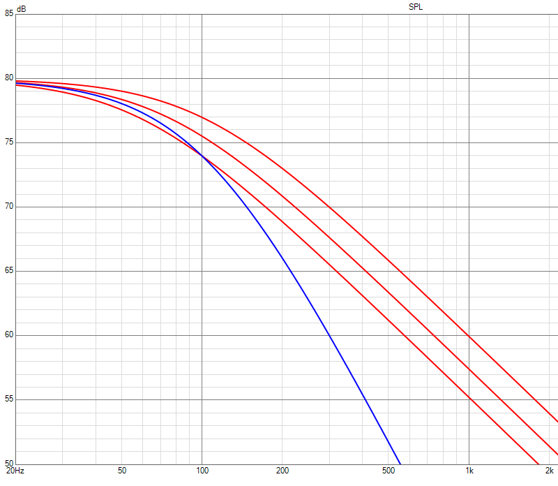

I see you've chosen the capacitive reactance to be half of the combined impedance. Clearly this is to make a -6dB response at the crossover frequency. It begs the question because many choose -4.5dB as the compromise. Some say the -6dB version sags too much.51K in, 100 Hz 1st order highpass would be 0.052µF.
So I made a comparison of all those with a second order Linkwitz-Riley at 100Hz, and your -6dB option appears viable by comparison if this is the needed crossover type.
