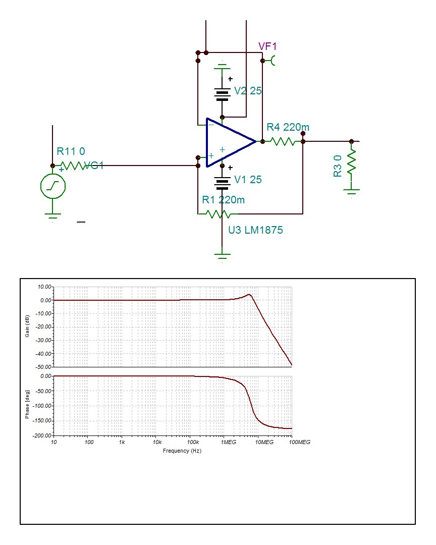

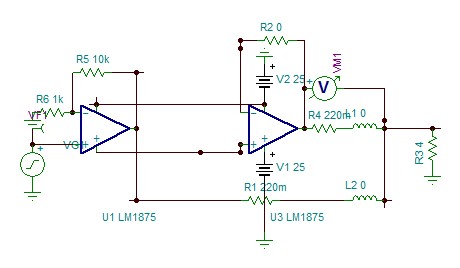

Each paralleled amp equates the voltage of its resistor to be equal to the master's resistor. By this the output current is multiplied here by four. the main amp sees the load as Rload×4. The load sees the impedance of the main amp as Z/4.

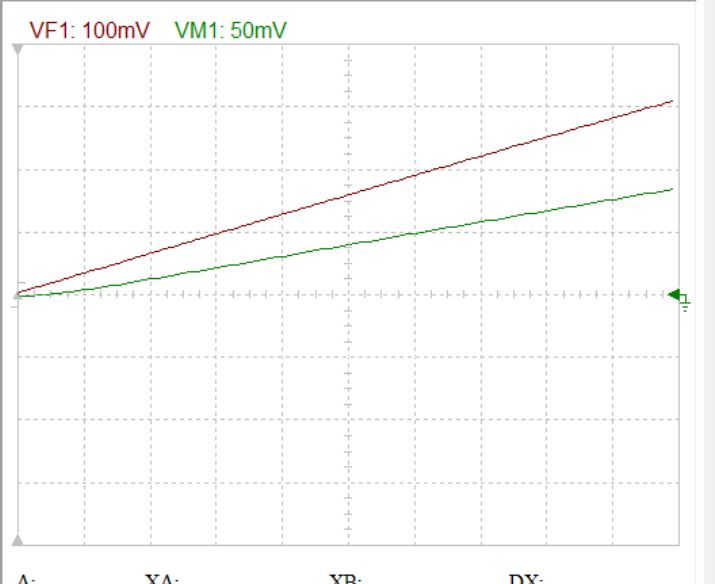

Parallel bridge configuration is widely used to get high power amplifiers by using small chips. The LM1875 gives its best with 8 ohms 15 watts only.

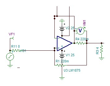

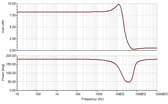

Bellow is the impedance that sees the main driving amplifier. To note that the simulating model doesn't have inductive component of the output impedance, it is fixed for simplicity to 0.1 ohms. This why the high frequency impedance falling to 0.5 ohm is wrong.

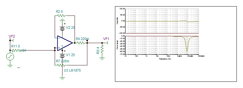

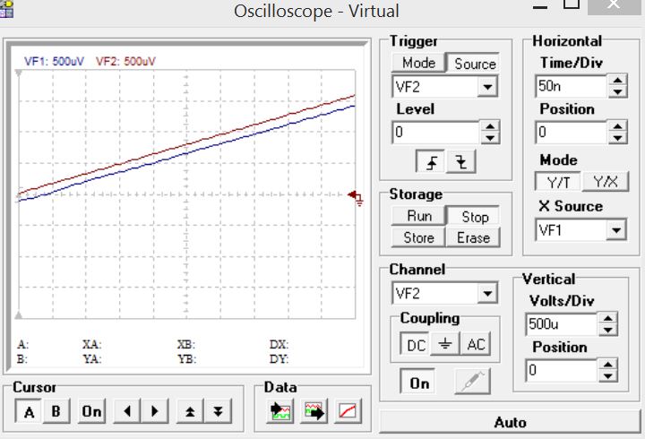

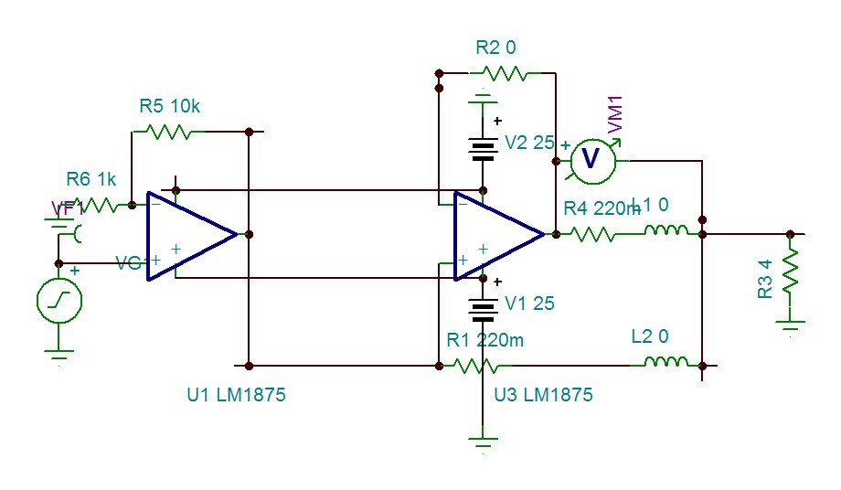

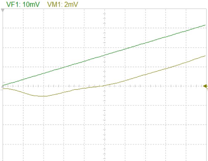

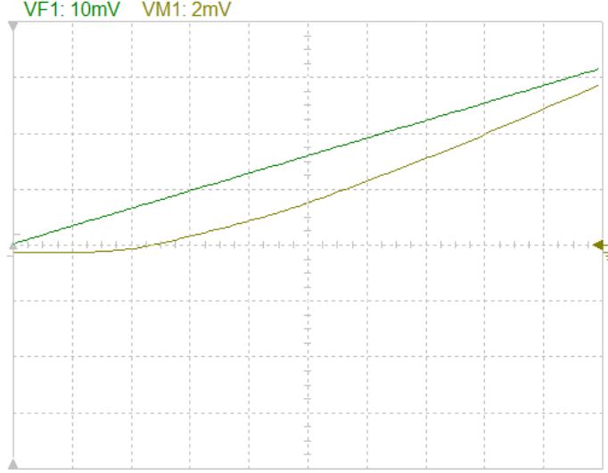

The datasheet also precise that it is loaded 2k. The open loop gain depends greatly with the load. The datasheet also precise that with one ohms in series, it is stable with any capacitive load. In other words, the OLG with one ohm gets considerably reduced to remain stable. How about loading 0.22 ohms! The OLG decreases by far by 10 fold to be stable at unity gain. If an amplifier still oscillate, to feedback by 1k resistor and shunt the inputs by 100 ohms. The gain decreases by ten fold. See applied by Mooly The LM1875 for best
After testing on simulator, it is the positive feedback is the reason of stability.
Disabled Account
Joined 2015
attachment.php

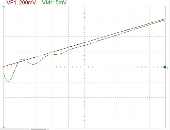

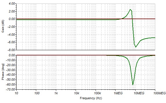

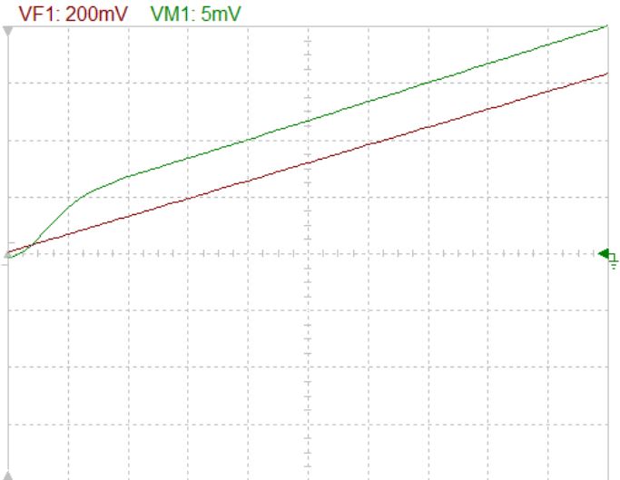

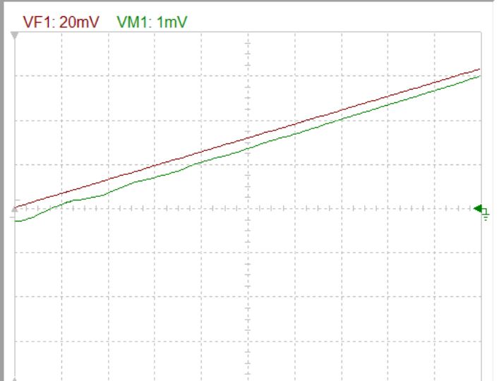

The stability is perfect but very well damped.
This is modeled with not non inductive resistors worst case and adjusted for perfect stability.

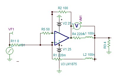

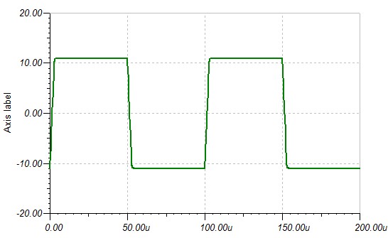

It is also possible to adjust the stability to perfection by adding an inductance to the main's resistance L2 of 100nH. This inductance can be realized by not using non inductive resistor and/or looping the leads single turn. Bellow is without and with. The scale is 50ns.
