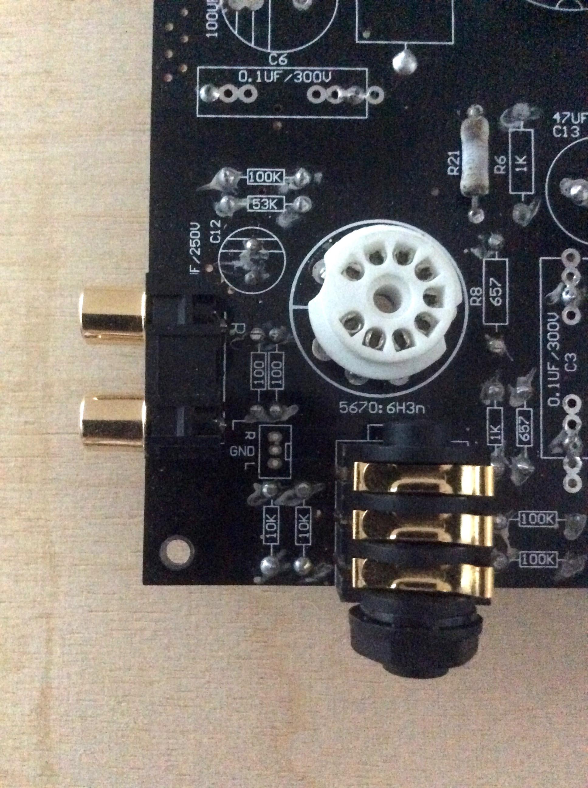

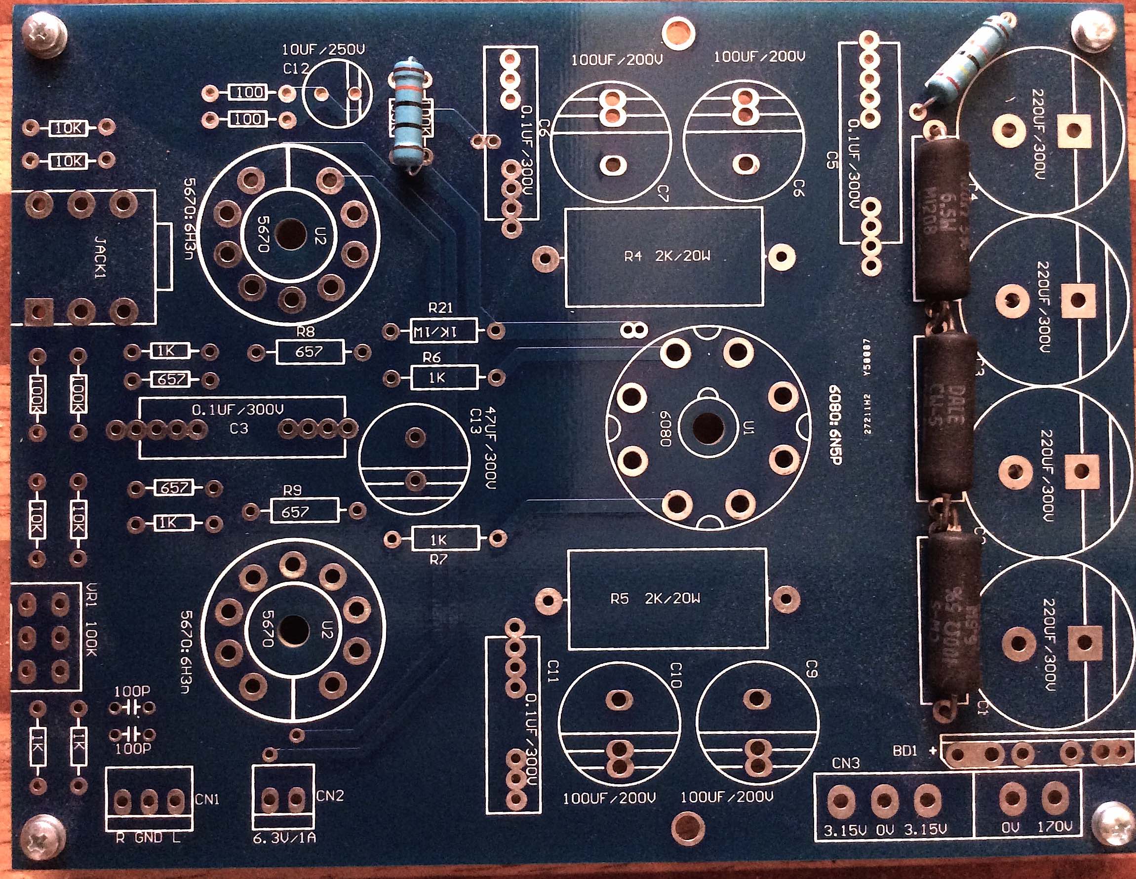

here are some images of the pcb

It would be easier for me, if someone can mark the suggestions and needed modification on the picture, please.
But always still maintaining the 32 ohm headphone output.

The transformer is providing:
170 V (100ma),
3.15V-0-3,15 V (2a)
6,3 V (1a)
the 170V are rectified and filtered by 4x150uF electrolytic caps.
here is another version that I have without preamp output:
