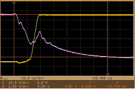

I have to admit that my probing technique is not perfect yet for high frequencies. I still haven't implement AN-47 throughly yet. I still use standard probe. So, you can guess, sometimes it is confusing wheter one display is the real thing or probing mistake, in classD monitoring.
In my scope (100mhz digital), I can tilt one channel than add channel 1 and channel 2. When I do this for 2Vgs (top and bottom mosfets), I found out there are spikes.
I got gate picture similiar like this (JohnW's). How can I see if there is cross conduction from seeing only Vgs?
Oh yes, EVA, all this time I monitor cross conduction by cutting traces, and then insert 2 resistors (1 resistor between upper source and output node, the second resistor between output node and lower drain). Then the output node is made the common for osciloscope and channel 1 and channel 2 both monitoring the other ends of the resistors. The resistor value is determined appropriate to the load and test signal until they both have about 1V drop. This way I can see cross conduction.
Is this technique good enough? I still want to find a technique to monitor cross conduction in classD (to adjust bias), but without cutting traces.
