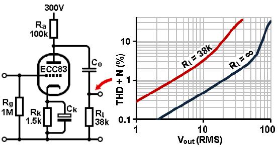

Here's a 12AX7 stage similar to yours; you're definitely in the ballpark.
The ECC83/12AX7 is quite linear when properly used, which means a high anode impedance. People who can't be bothered to get it right will be better off using lower mu valves which can deliver sufficient linearity when chucked into any old circuit. Of course, this all gets turned around for guitar amps where distortion is required; lazy people can just throw in a 12AX7 and know that they will get lots of gain and clipping without having to actually design a circuit.
