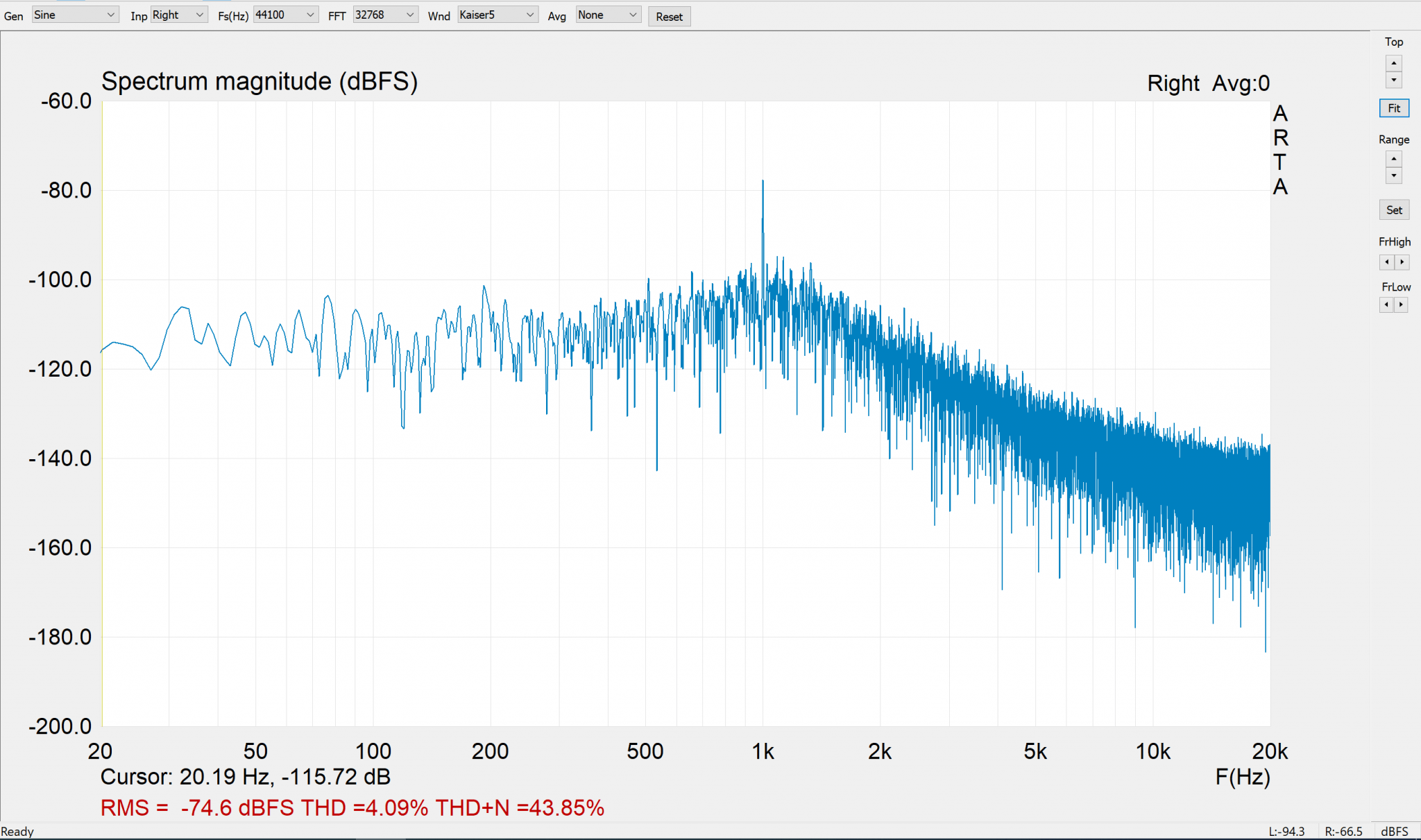

Decided to check improvements on input channel 2. It shows rather noisy response. I then proceeded to disconnect anything from the interface, but the channel remains noisy. Tried switching between LINE / INST, engaging/disengaging the pad, changing volume. I even tried setting up generator to the channel 3 and 4. No luck.
I got three assumptions:
- either I messed it up while modding
- previous owner overloaded the channel
- flaw in design / failed qc from the factory
My guess they messed up something with ADC input to the CS4272 chip

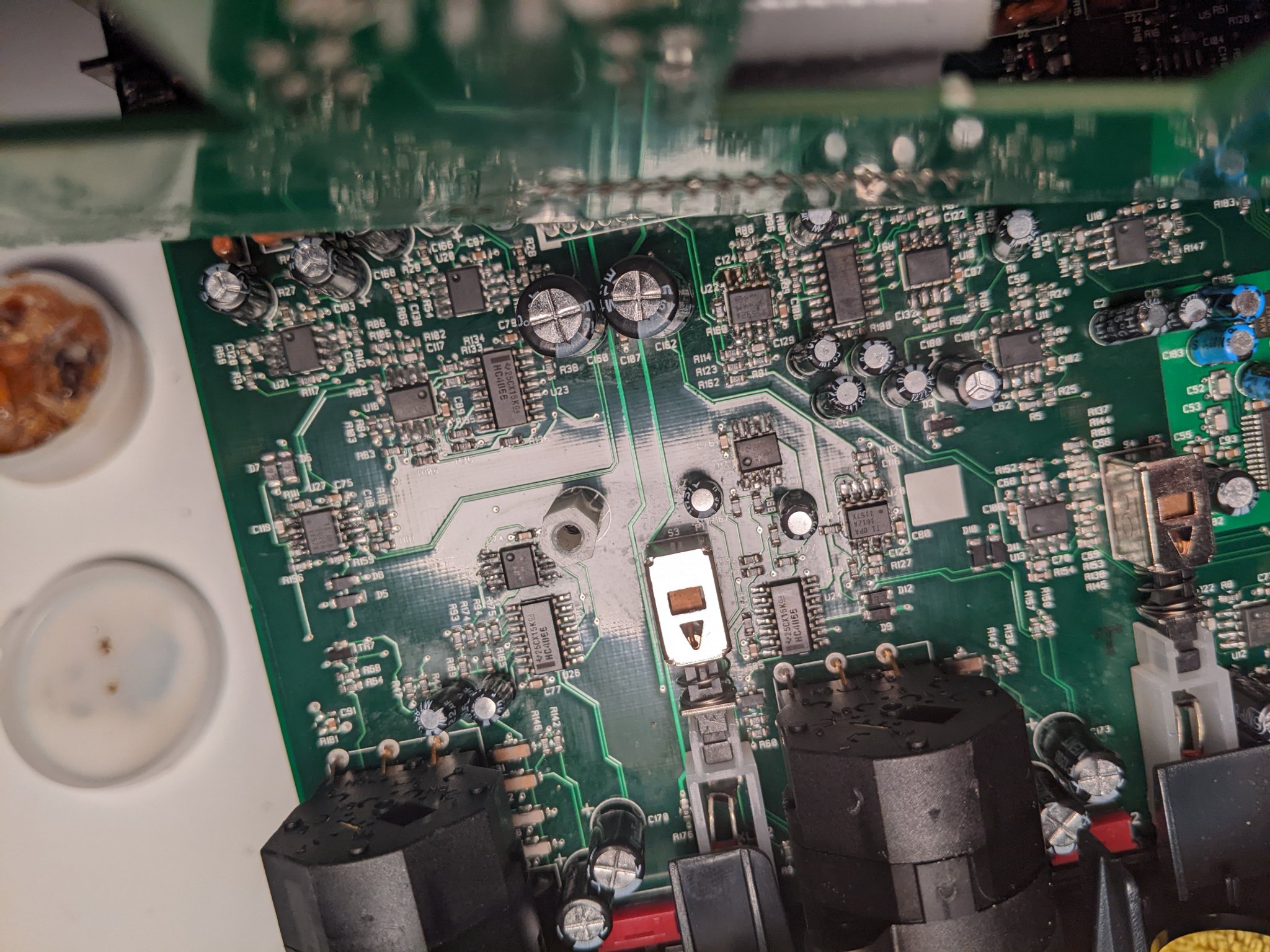

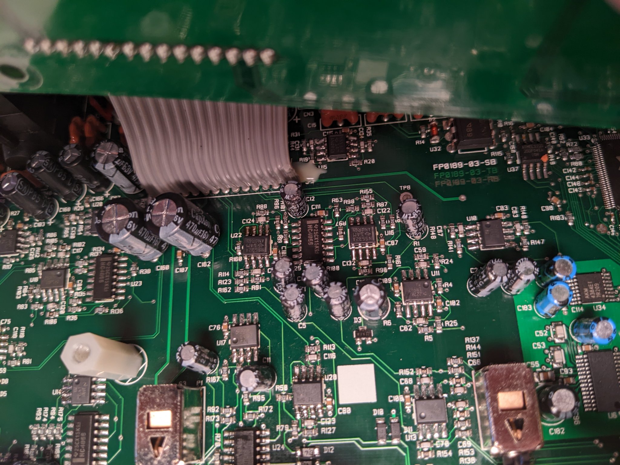

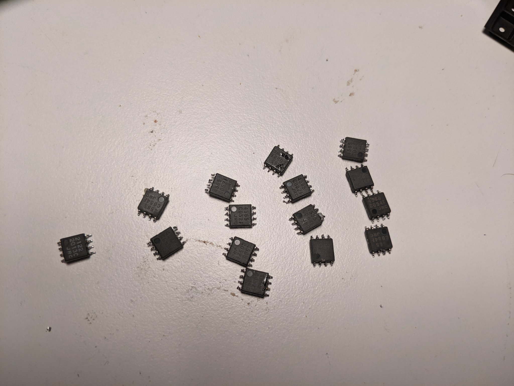

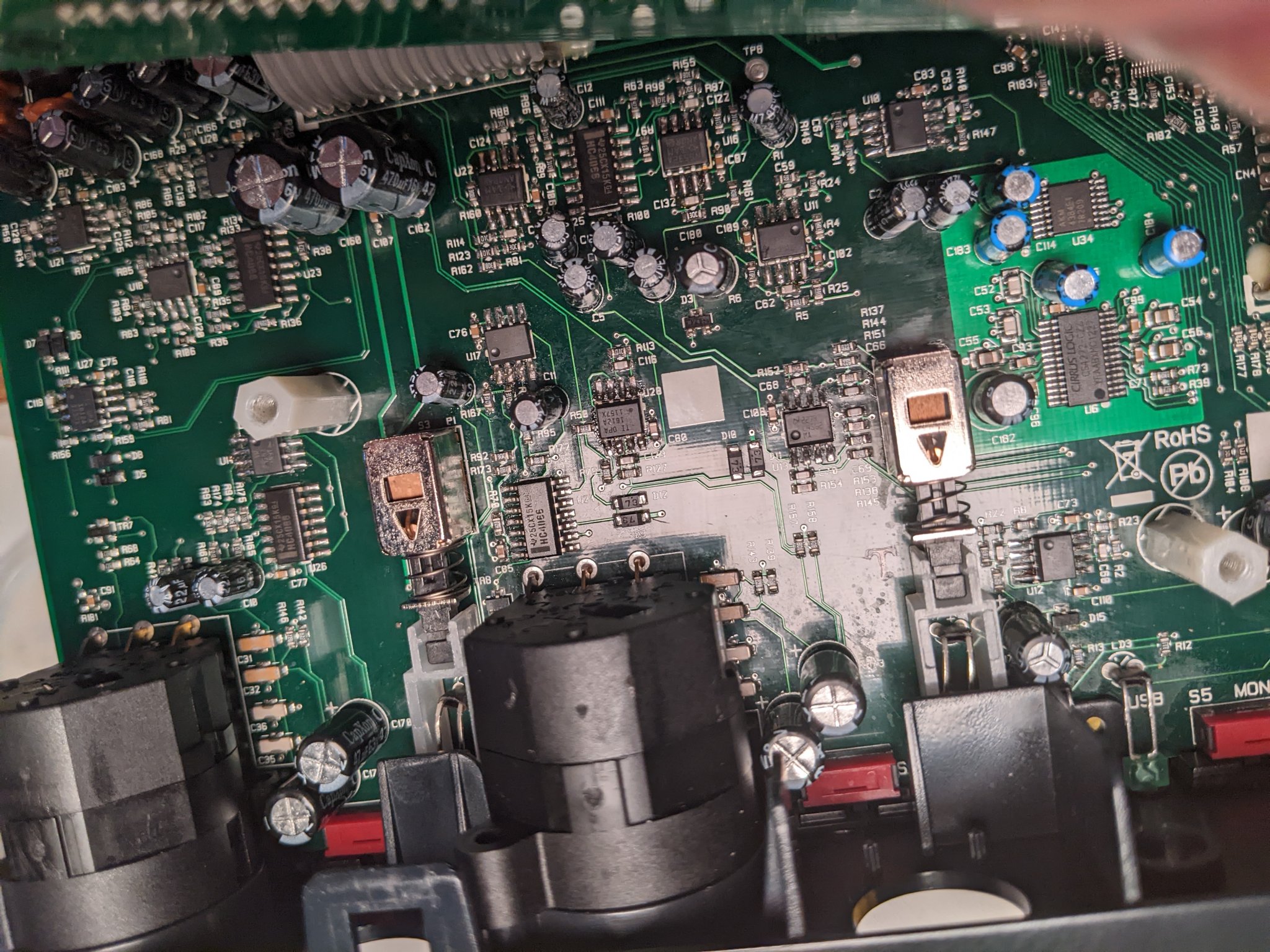

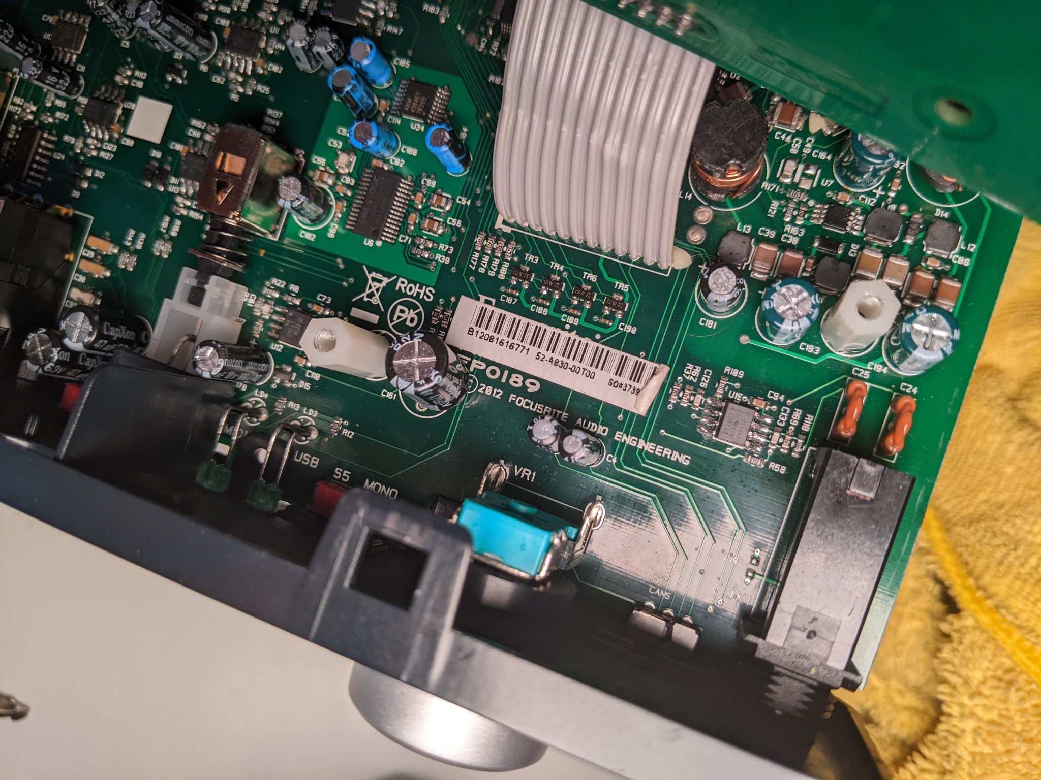

This got fixed by replacing one of the 2122 ic. My assumption is that someone overloaded that channel and damaged the first IC on the analog signal path - that is 2122 chip. Replacing those with OPA1602 created excessive noise. Trying OPA1612 now and it seems like it is working fine.
Interesting that now having one channel with 2122 ic and second channel with opa1612 I had an opportunity to test both channels and compare them and it shows that they both perform identical THD and noise wise.

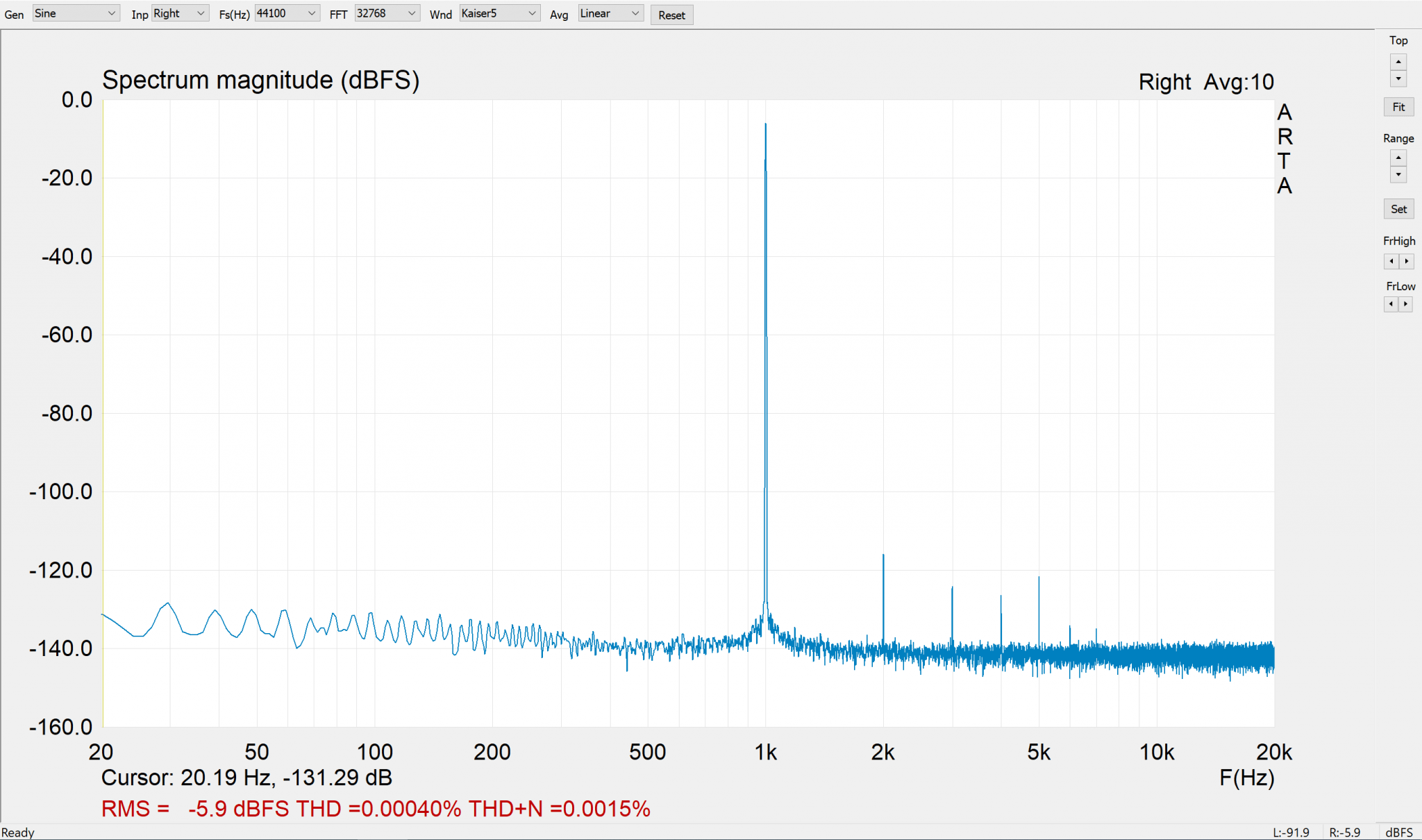

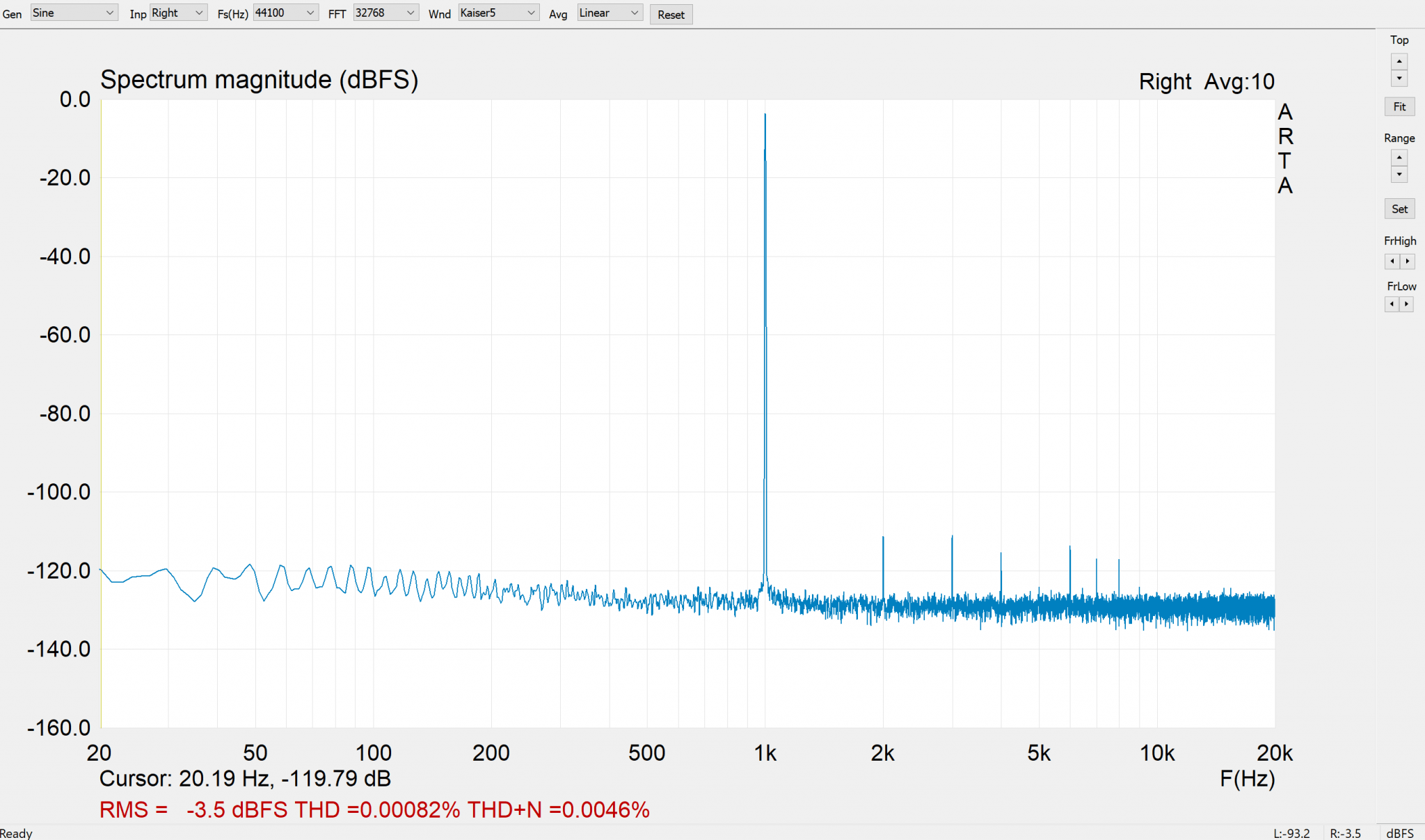

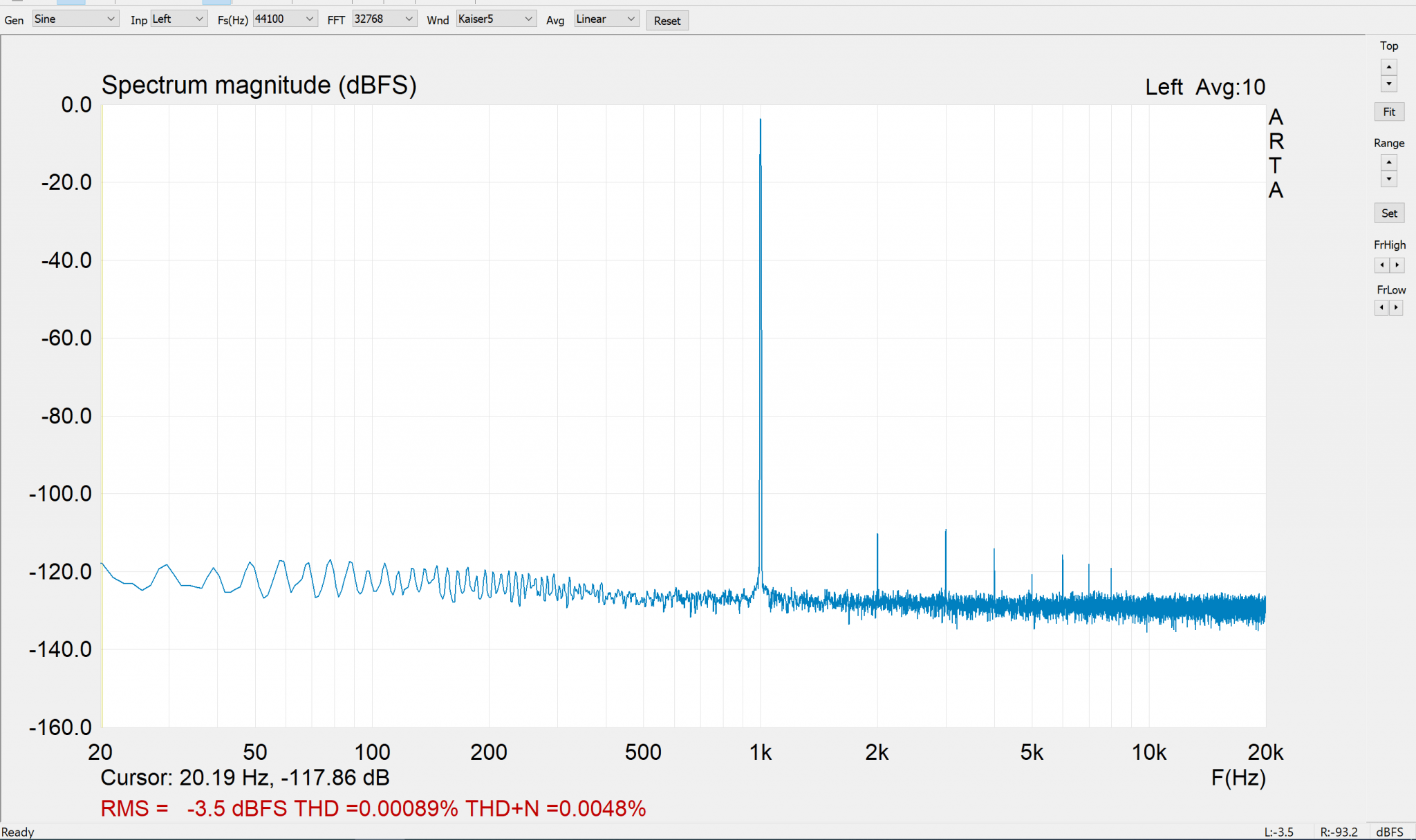

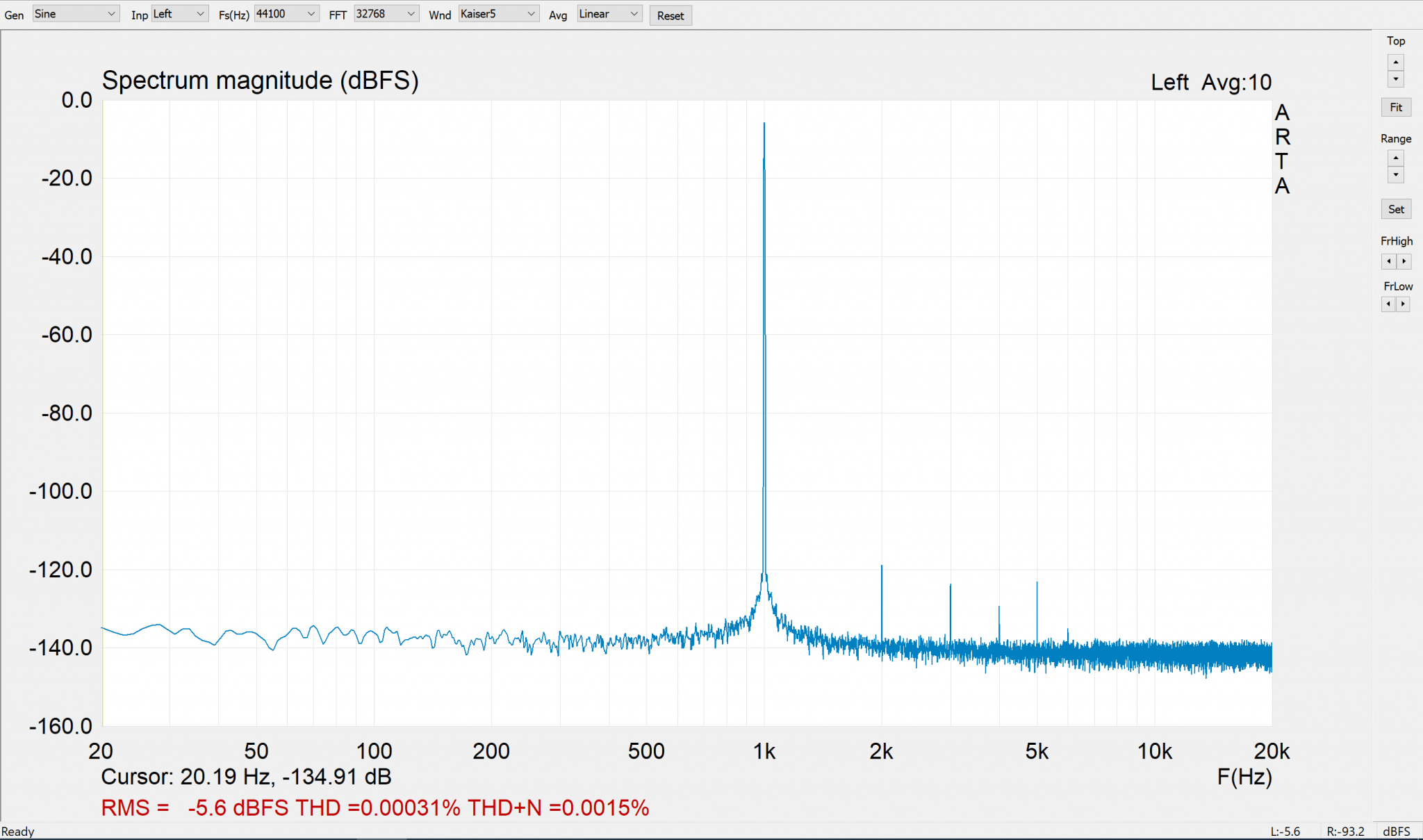

Here are the results after the mod.

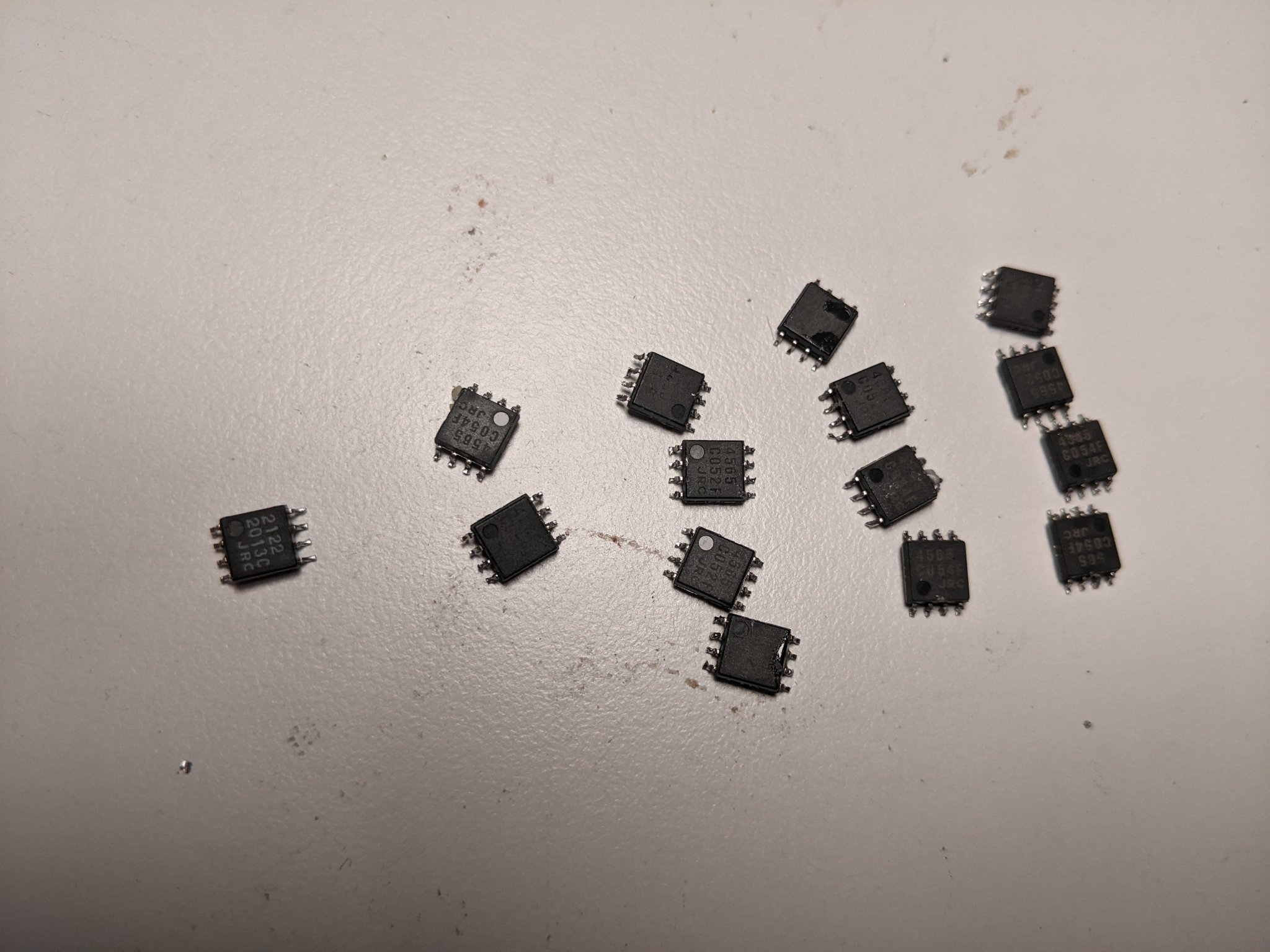

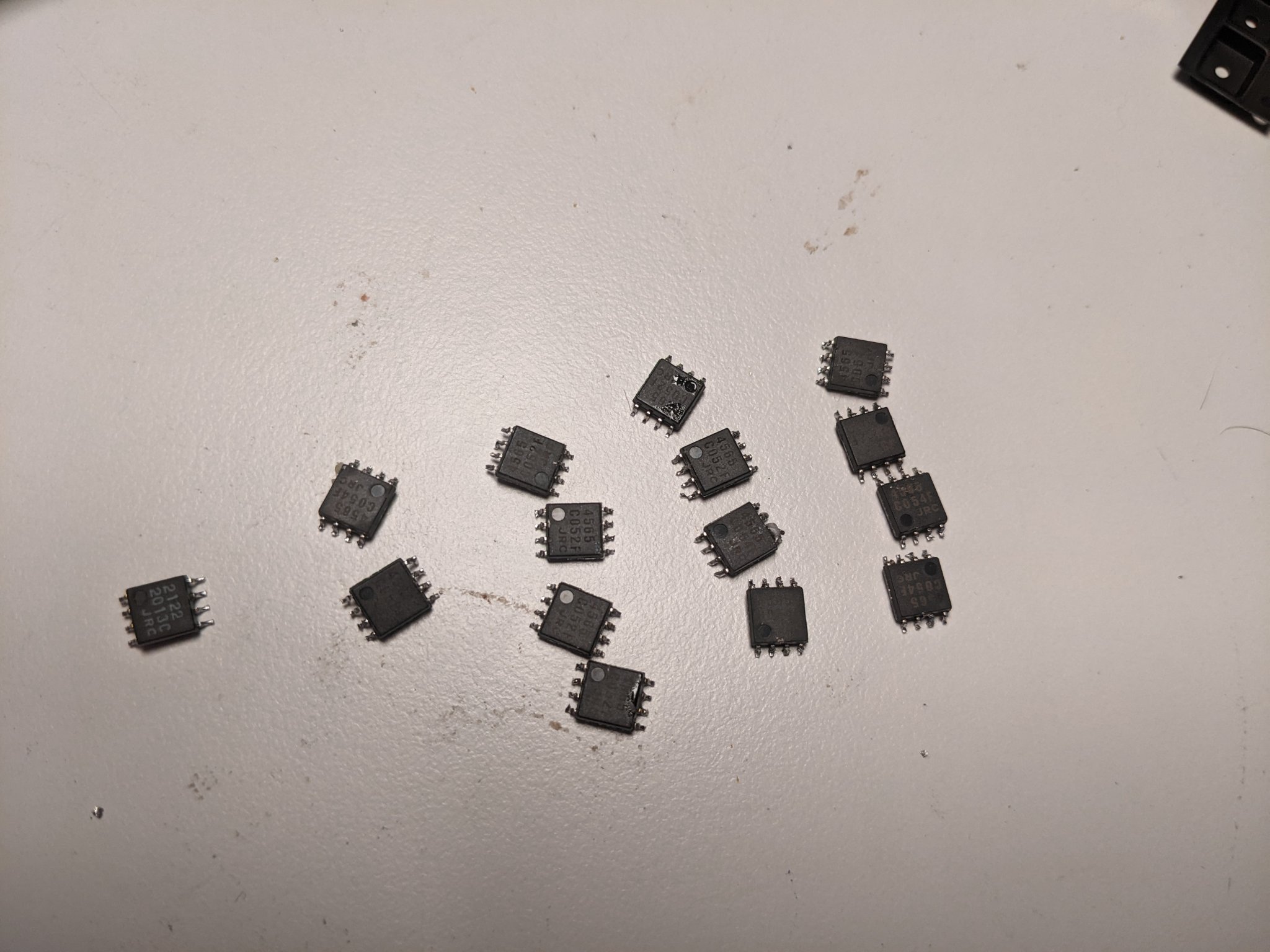

I decided to replace both 2122 with OPA1612, $5
Headphone opamp got swapped to OPA1688, $1.30
9 opamps were swapped with LM4562 (only had 10 of those in SOIC package) $1.00
4 opamps near RCA ouputs got swapped with NE5532A $0.35
Total cost of mods is less than $25
Both channels function properly now.

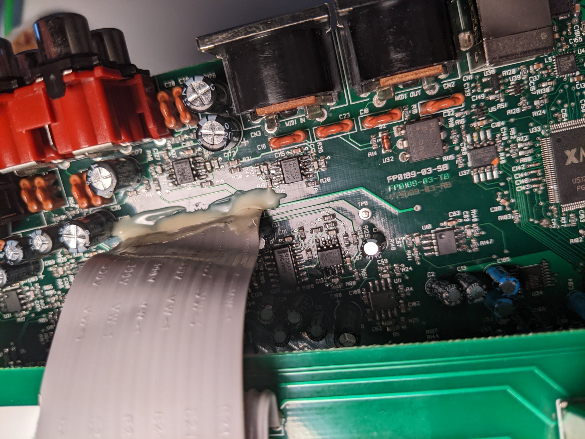

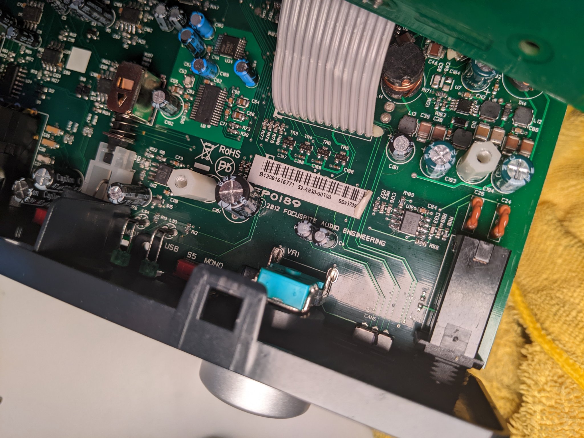

Photos of the modded board are attached with this post.
I had a lot of fun!

Best THD+N in your latest graphs is Line in 0.0015%. That is -96.5dB. Maybe through MIC in XLR it can also achieve the -100dB codec chip's spec. Certainly outperforms the majority of power amps. Except very few SOTA high efficiency modern designs in the market. Thus very good for testing. Remains to build the attenuator.
Not sure if there's a clear THD+N performance gain than before swapping the op-amp chips but you had fun and that's the main thing in a hobby.
Yeah, I ordered those attenuator boards, just waiting for them in the mail...Best THD+N in your latest graphs is Line in 0.0015%. That is -96.5dB. Maybe through MIC in XLR it can also achieve the -100dB codec chip's spec. Certainly outperforms the majority of power amps. Except very few SOTA high efficiency modern designs in the market. Thus very good for testing. Remains to build the attenuator.
did you limit the BW of Arta 20-20K according to the standard THD+N? Without that limiting, Arta will be noticeable less optimistic than AP analyzers.
I tried both with loading the file you supplied (20-20k limit) and without. Seems that THD is the same for both cases. I use Fs at 44100Hz, maybe that is why. When I use 96000Hz and with your file THDs are lower.did you limit the BW of Arta 20-20K according to the standard THD+N? Without that limiting, Arta will be noticeable less optimistic than AP analyzers.

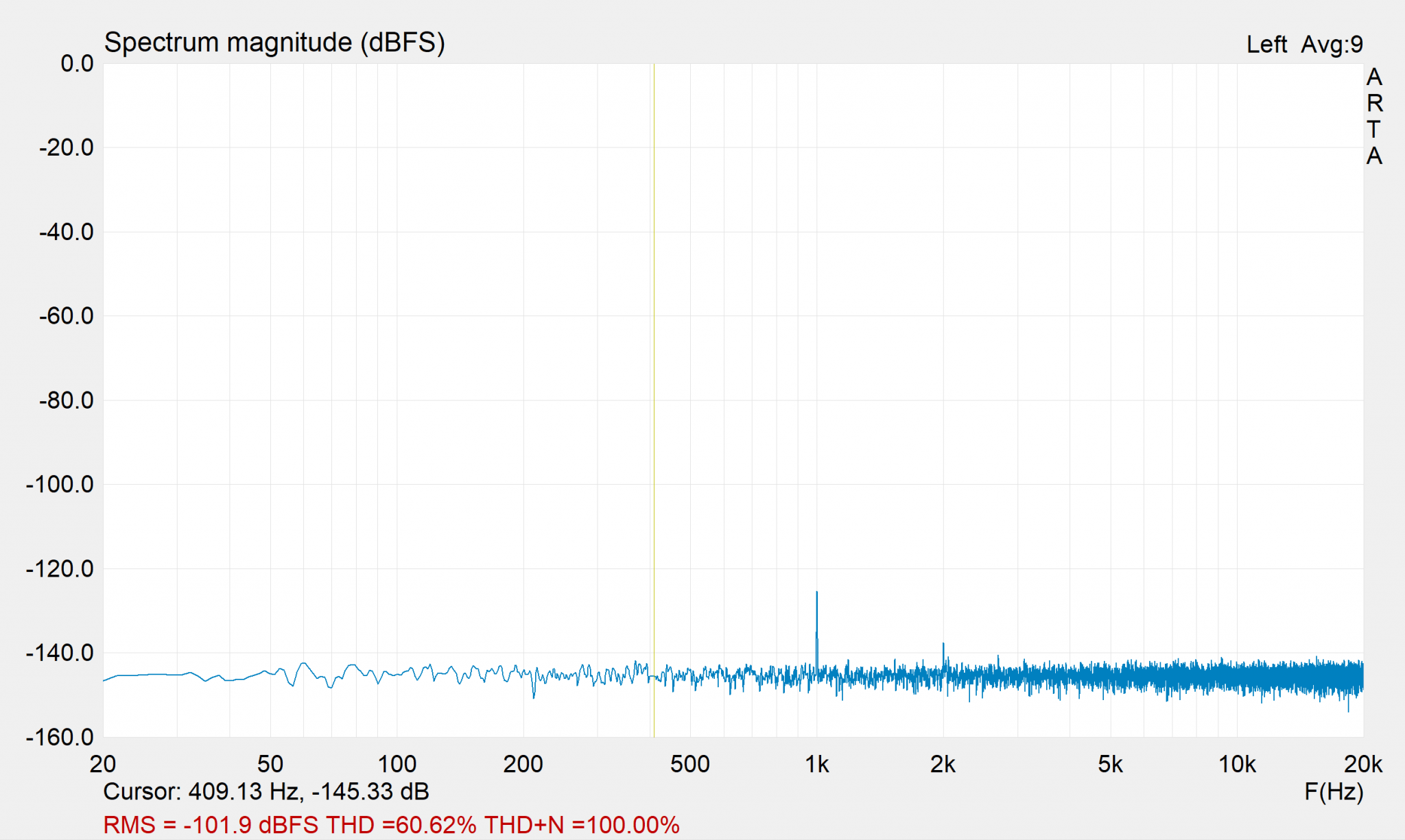

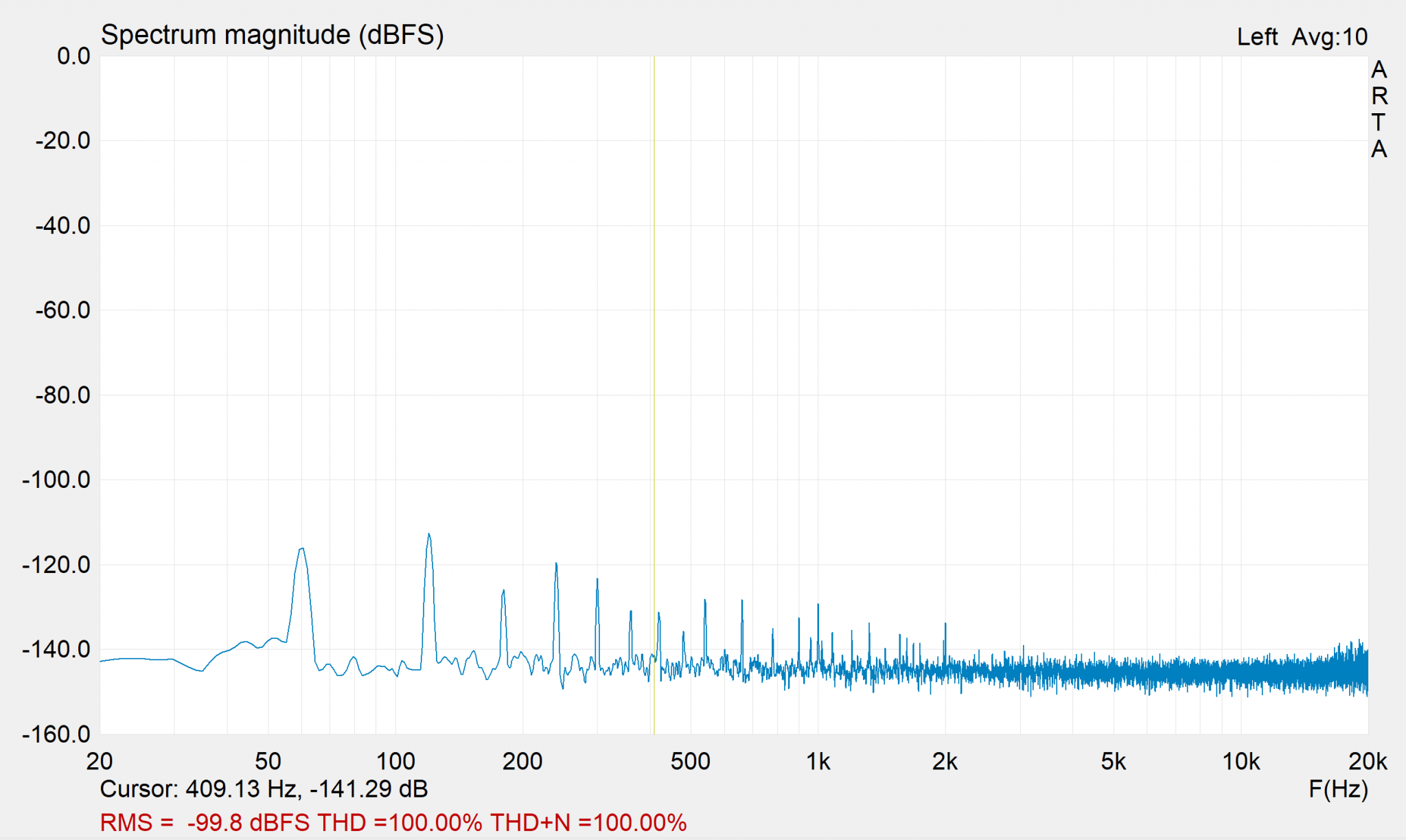

Was able to measure few things with my setup.
I have LM3886 board that was mounted on a heatsink and loaded with dummy 8 ohm load.
Power was provided by linear power supply using Antek 22V-0V-22V transformer with 14,000uF caps per rail. +-15V was obtained with LM317/LM337 regulators.
I am attaching four results:
Conclusion - I need better power supply for +-30V.

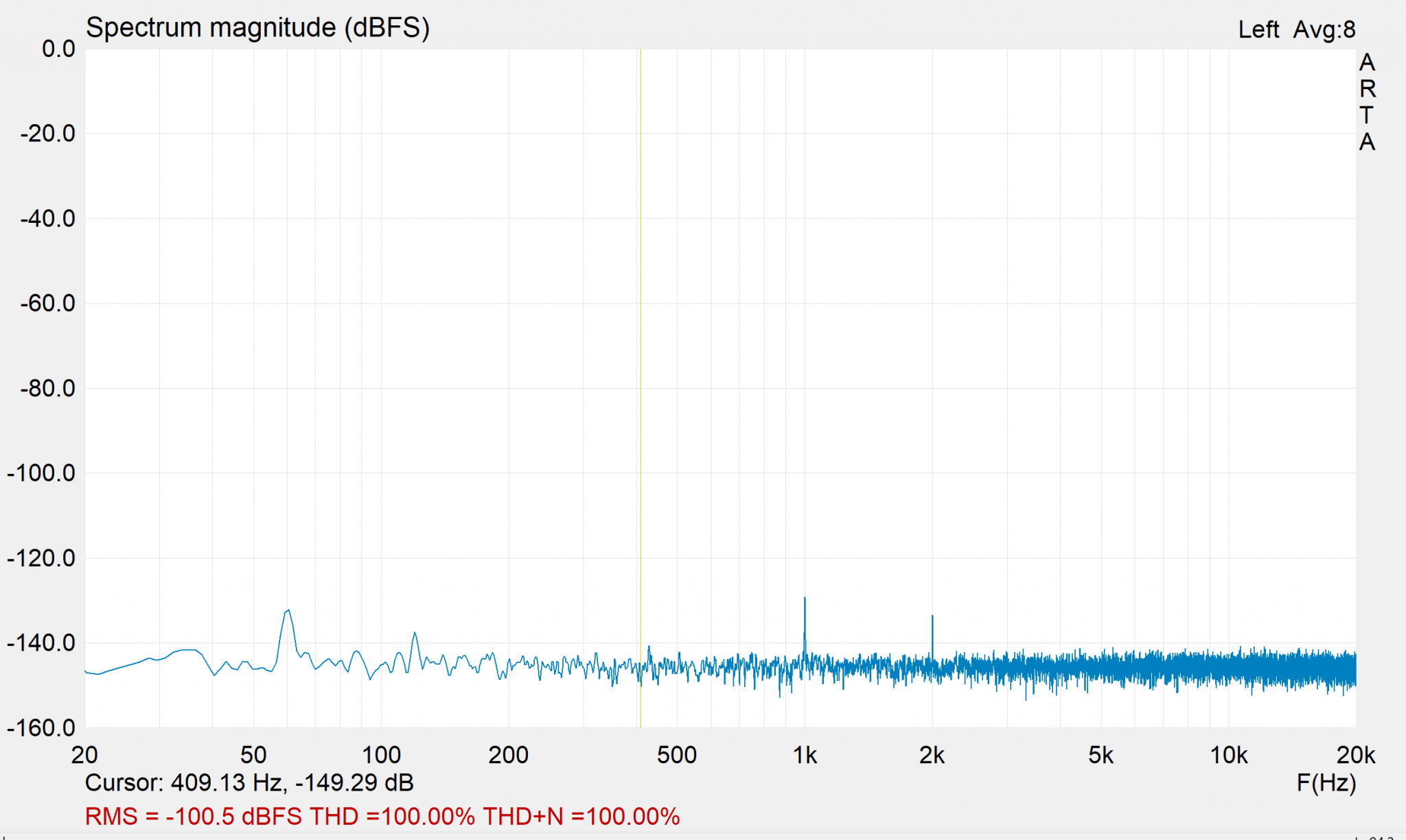

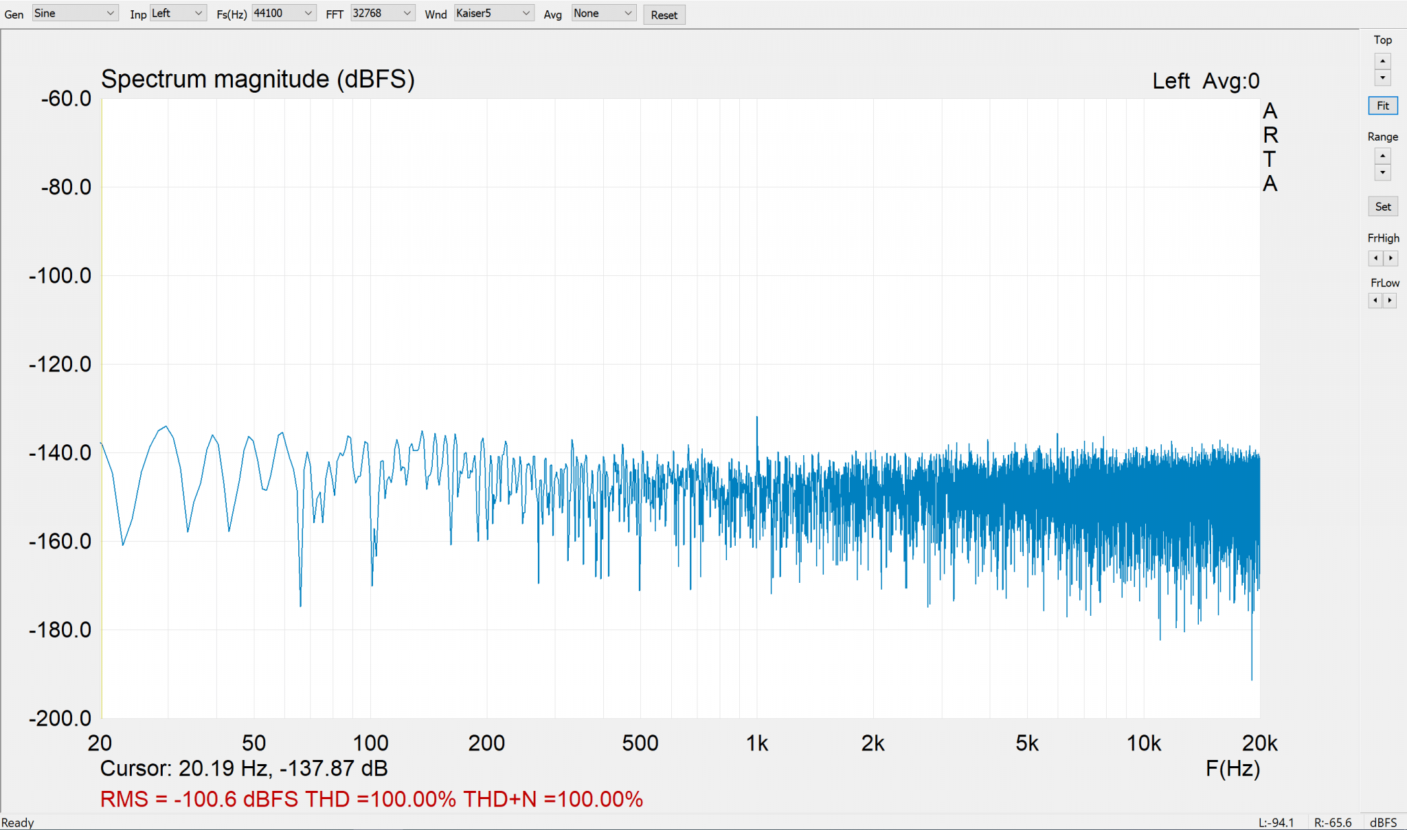

- Audio interface loopback - best result
- Audio interface - nothing plugged in to the input - another best result
- Connected to amplifier via attenuator board with amp off
- Amp on but no signal in - clearly power supply has some noise inserted up to -110dB
Jusr FYI, asking those regulators to reduce input voltage by half (15V) AND deliver high current isn't going to work well for sound quality. Output impedance and load regulation deteriorate as Vin-Vout exceeds 4V...
Actually that mains noise isn't so bad. It's hard to get lower than -100dB. It could be the power supply as such, but also the wiring run and grounding scheme.
You could see what it looks like when using a separate lab supply (maybe you already did that).
Jan
I don’t have lab supply- but I have Connex SMPS300RS board that I want to use to measure in the nearest future hopefully…
