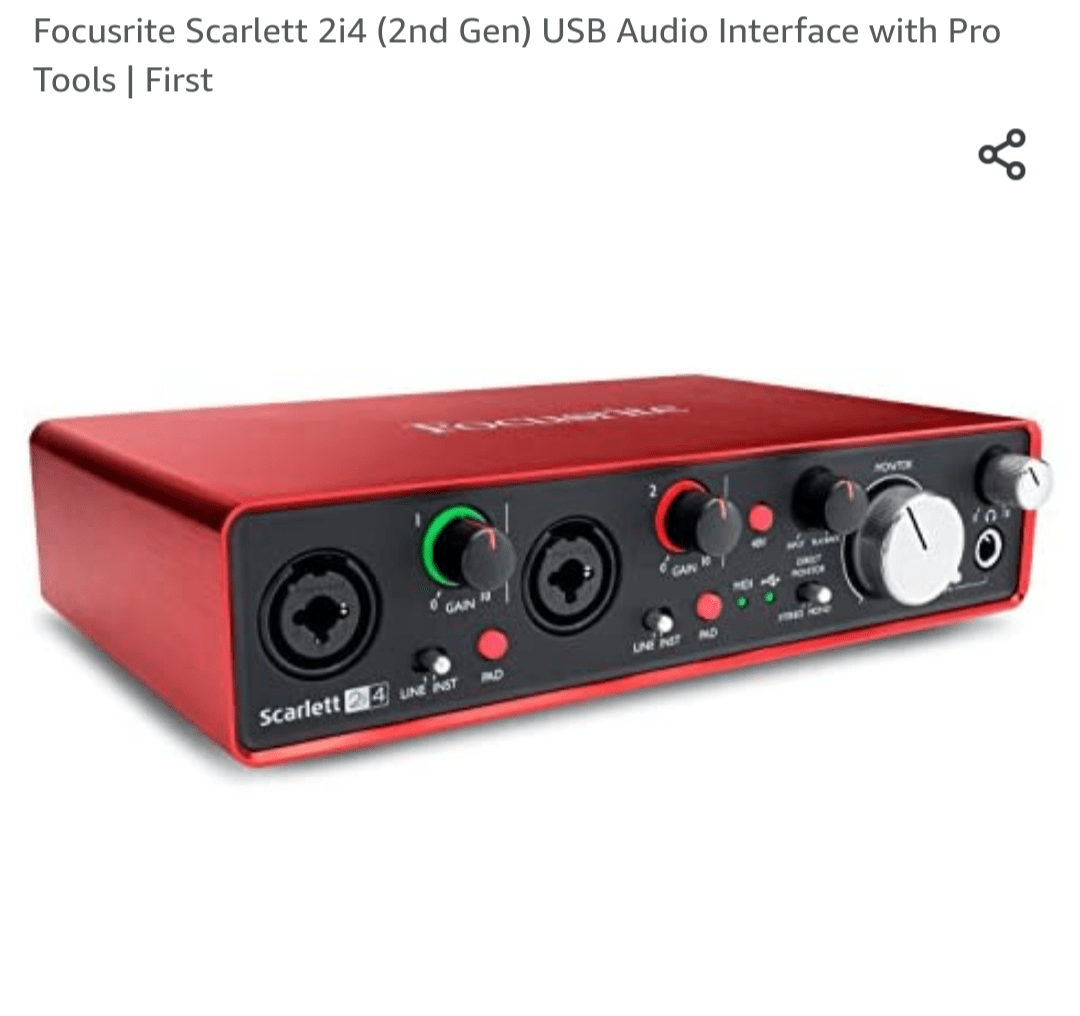

I have built power amplifier based on LM3886 chips. Now I want to measure it.
I have Scarlett Focusrite audio interface that I plan on using in combination with ARTA software:

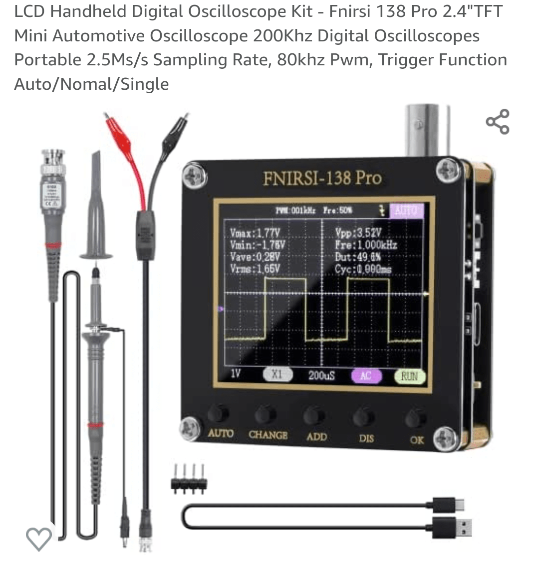

And a $30 oscilloscope:
Will this be a good start for a beginner? Any comments or suggestions?

You have all you need.
I have focusrite and use rew software. You do not need generator, software does it. Unless you want something special.
There is thread how to measure with rew, from member xrk971.
seems OWON NDS1202S scope 200MHz would be cheaper than 100MHz Siglent SDS1102 😉I was also looking into getting Quant Asylum QA403 Audio Analyzer - that's $550:
And oscilloscope from Siglent SDS1102CML+ $320:
What route should I go? Any other equipment that can be used for measurements of the power amplifier?

Just start measuring, and when you find you need something your current equipment cannot do, that's the time to (informed) decide on your next purchase.
But I understand your anxiety to actually start measuring, it can be daunting, and an easy way out is to fret about which equipment to buy.
But at one time you have to get started, or you end up buying lots of stuff you may never use. Many of us have been there.
So, just fire up the Scarlett and ARTA and Start Measuring!

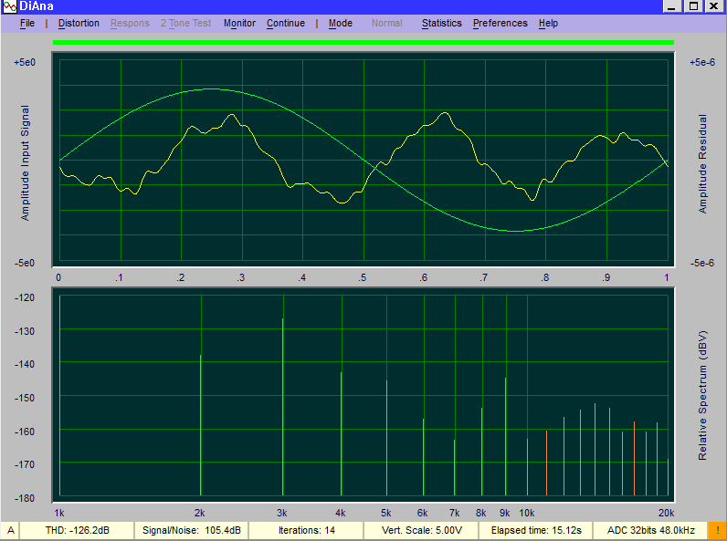

if you want to understand the relationships between the harmonics and the waveform DiAna https://www.data-odyssey.nl/Diana.html is possbly the best tool. It will show where the wave departs from ideal. (Password can be found here: https://www.diyaudio.com/community/threads/diana-a-software-distortion-analyzer.315785/post-6422164)
and how is that FFT app? Did you compare its THD+N versus REW or AP? For example, I tested many of FFTs and found only Arta (only with BW limiting file!), and 1 year ago REW was corrected and THD+N now more or less matches vs AP. Others are simply wrong, massively. RMAA, Multi instrument, Spectraplus etc all are junk, and not all of them are free ))if you want to understand the relationships between the harmonics and the waveform DiAna https://www.data-odyssey.nl/Diana.html is possbly the best tool. It will show where the wave departs from ideal. (Password can be found here: https://www.diyaudio.com/community/threads/diana-a-software-distortion-analyzer.315785/post-6422164)
PS: the common problem of all FFTs excluding Arta, they have no idea about AES17 recommendation regarding THD+N notch filter implementation.
REW also had that problem but May 2021 was corrected, partially.
Absolute accuracy is not a big issue for me, I'm more interested in relative values. Yes there are issues on correct windows and etc. to get the right levels on the harmonics. I use my 725D when I need correct values. Its better than +/- 2 dB for the harmonics. I am more interested in its diagnostic capabilities. The author is on DIYaudio pretty often and will address any issues that turn up. Have you tried it? Its free still.
I may be able to check it against my Shibasoku 725D which has been a good reference standard and does similar analysis. Attached is a screenshot of DiAna showing the the source waveform and the residual in phase helping to understand where the harmonics are from. This is with an RTX.

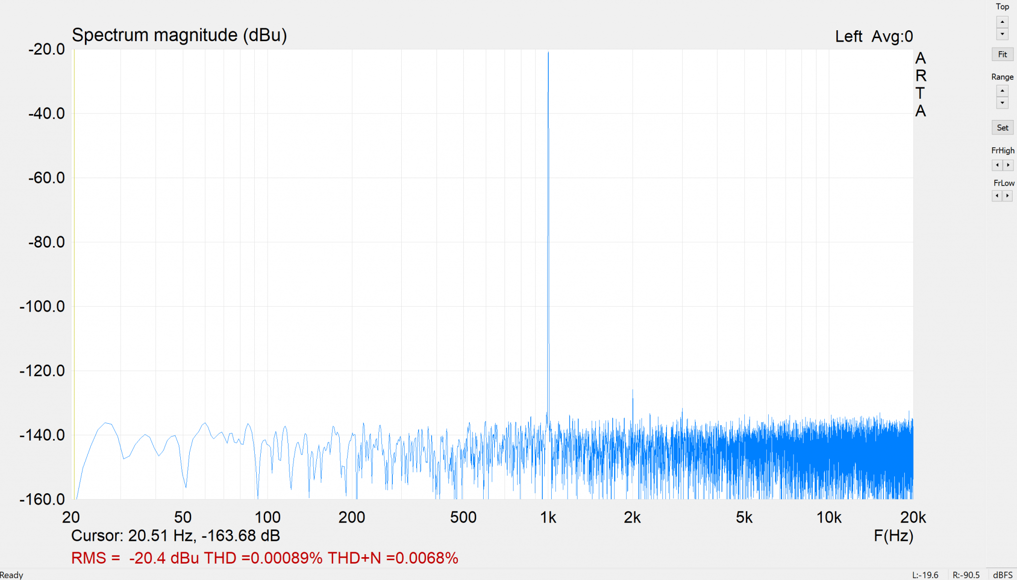

I downloaded ARTA. Using spectrum analyzer I get pretty low THD figures. I wonder if those are correct?
Audio interface has been set up with main volume at 12 o'clock and input channel 1 at 9 o'clock. I engaged the PAD - it reduced THDs from 0.004 to 0.0009
