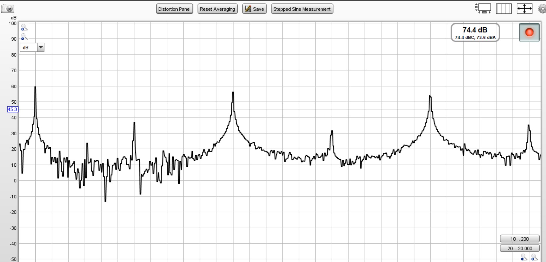

OK. Disconnected the attenuator inputs as first test - no change. I cobbled together a test set-up. Latino PP ST120 amp that is quiet enough on its own and a pair of Altec 414 drivers in free air. Hum is easily heard and measured with REW spectrum analysis.
I BELIEVE I have found the problem. The Khozmo attenuator bodies need to be grounded separately from the audio signal it seems. There is NO indication on the attenuators that needs to be done. What stimulated me to try that is I replaced the brass volume shafts with Garolite ones thinking I might be creating a ground loop or similar as moving the volume knobs often changed the hum. Well that made the problem much worse. I then touched a grounded probe between the flexible coupler and the chassis - and lo and behold, dramatic decrease in volume!
I then moved the jumpers to a threaded hole (unmarked) on the attenuators and tried grounding to the chassis - good reduction and then to the audio bus and next to silence was the result!!!

Pre and post below.
