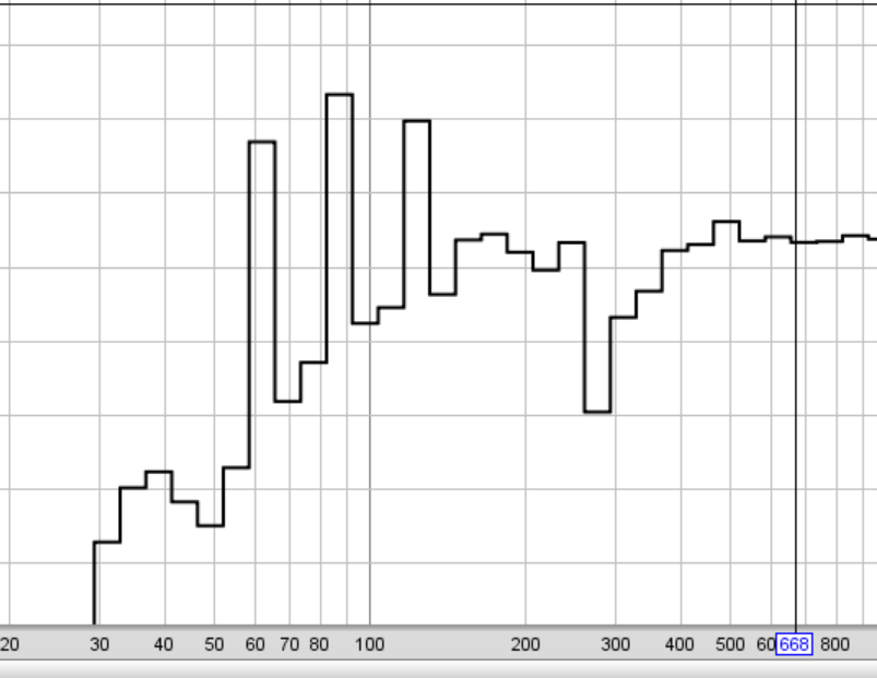

The 60Hz and 120Hz is electrically possible, but not the 90Hz. That must be acoustical.

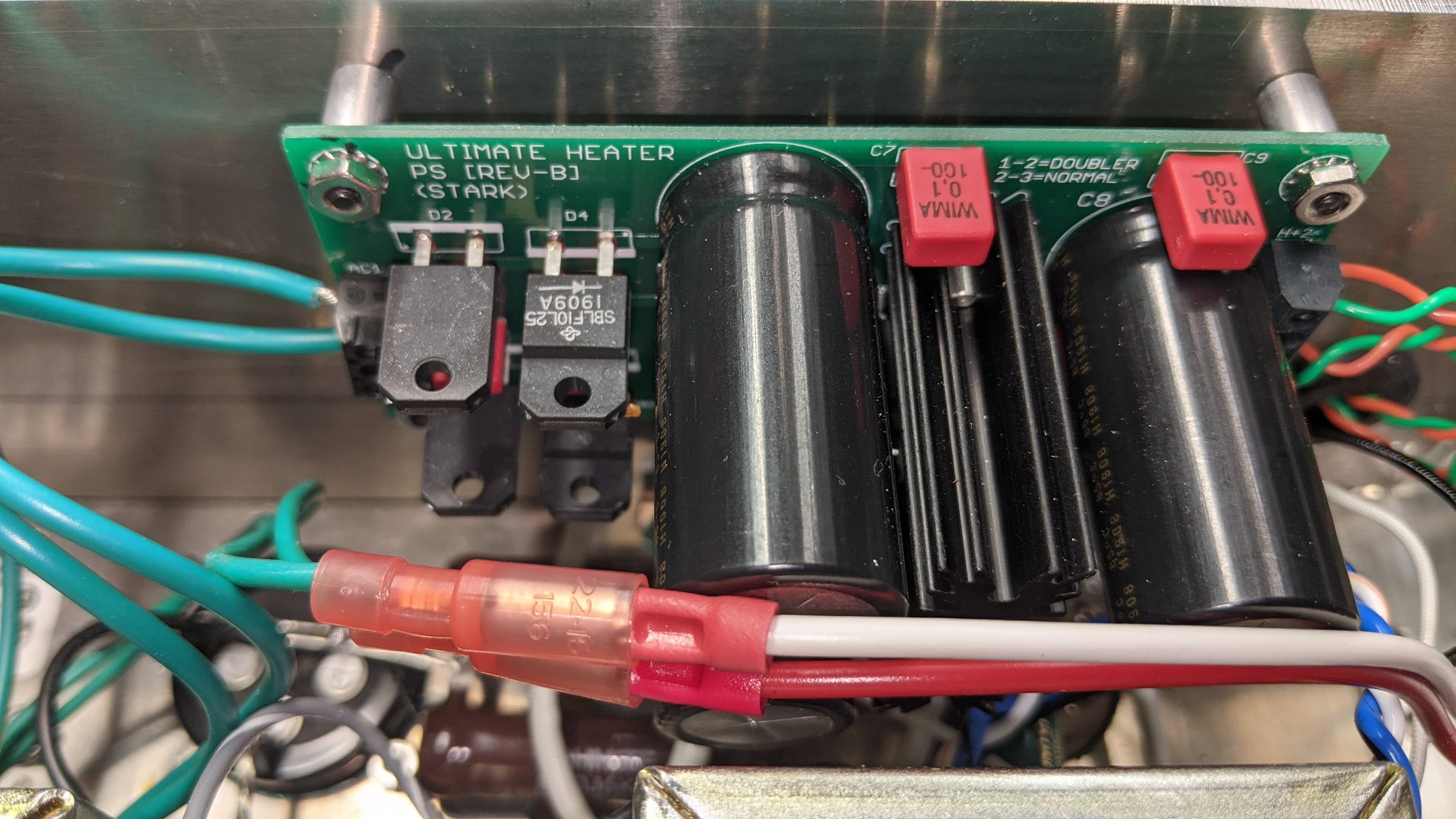

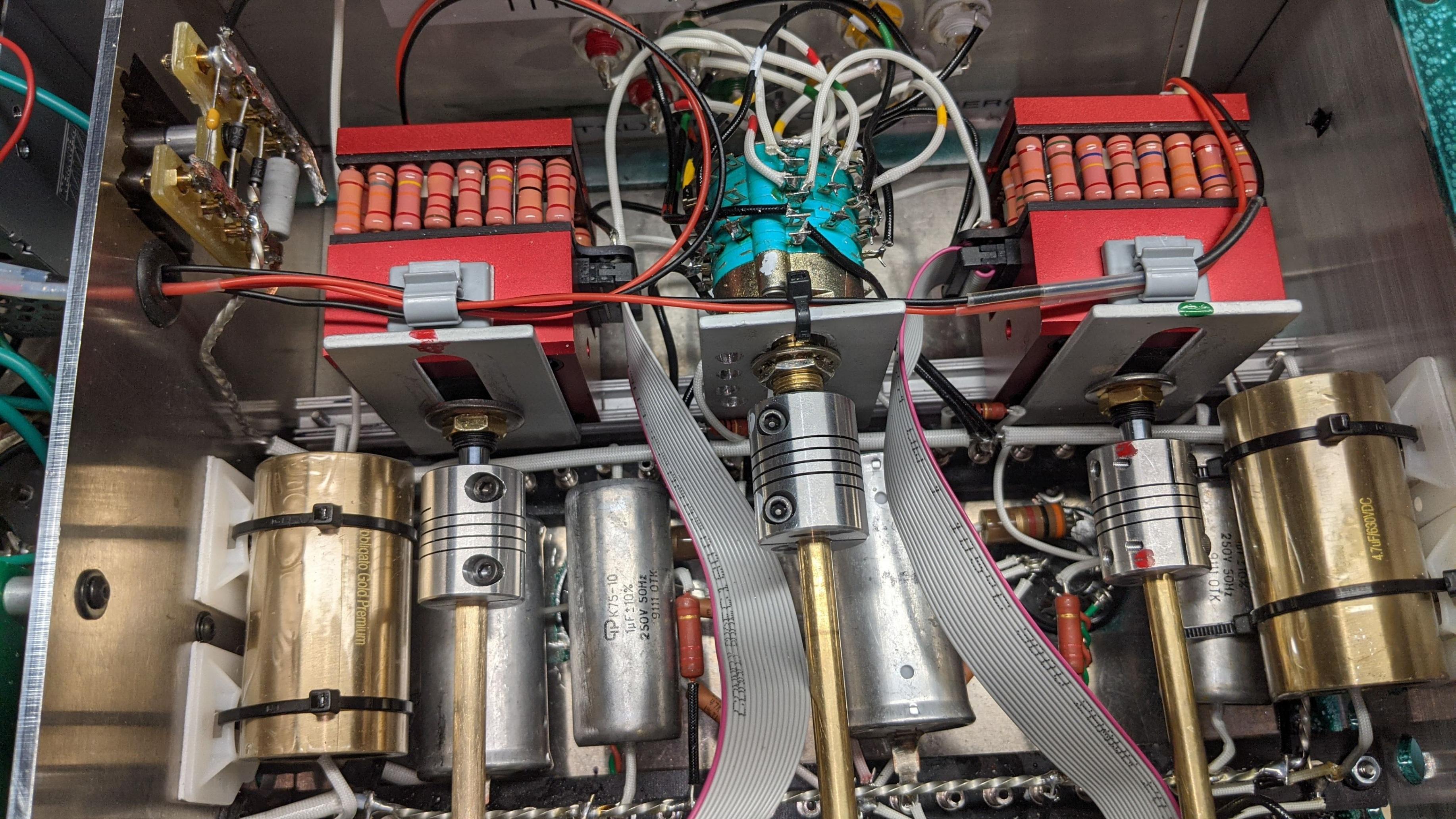

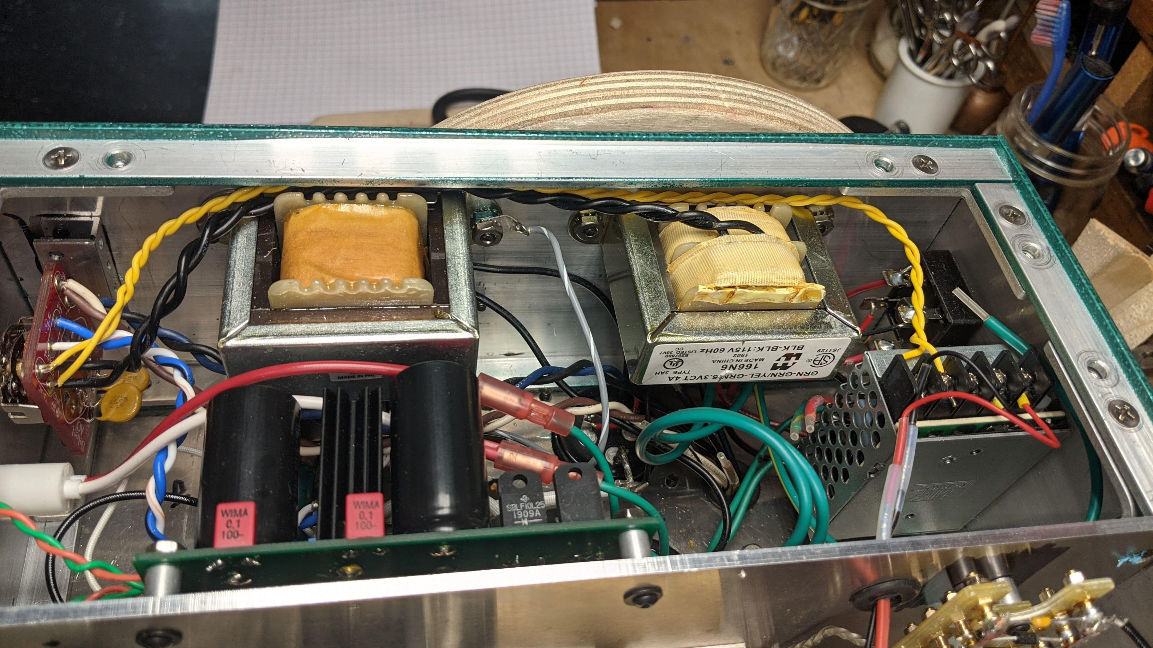

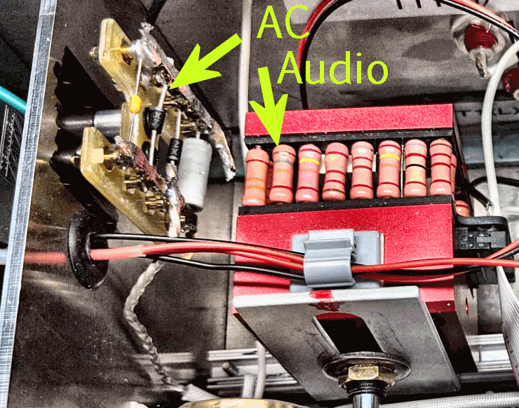

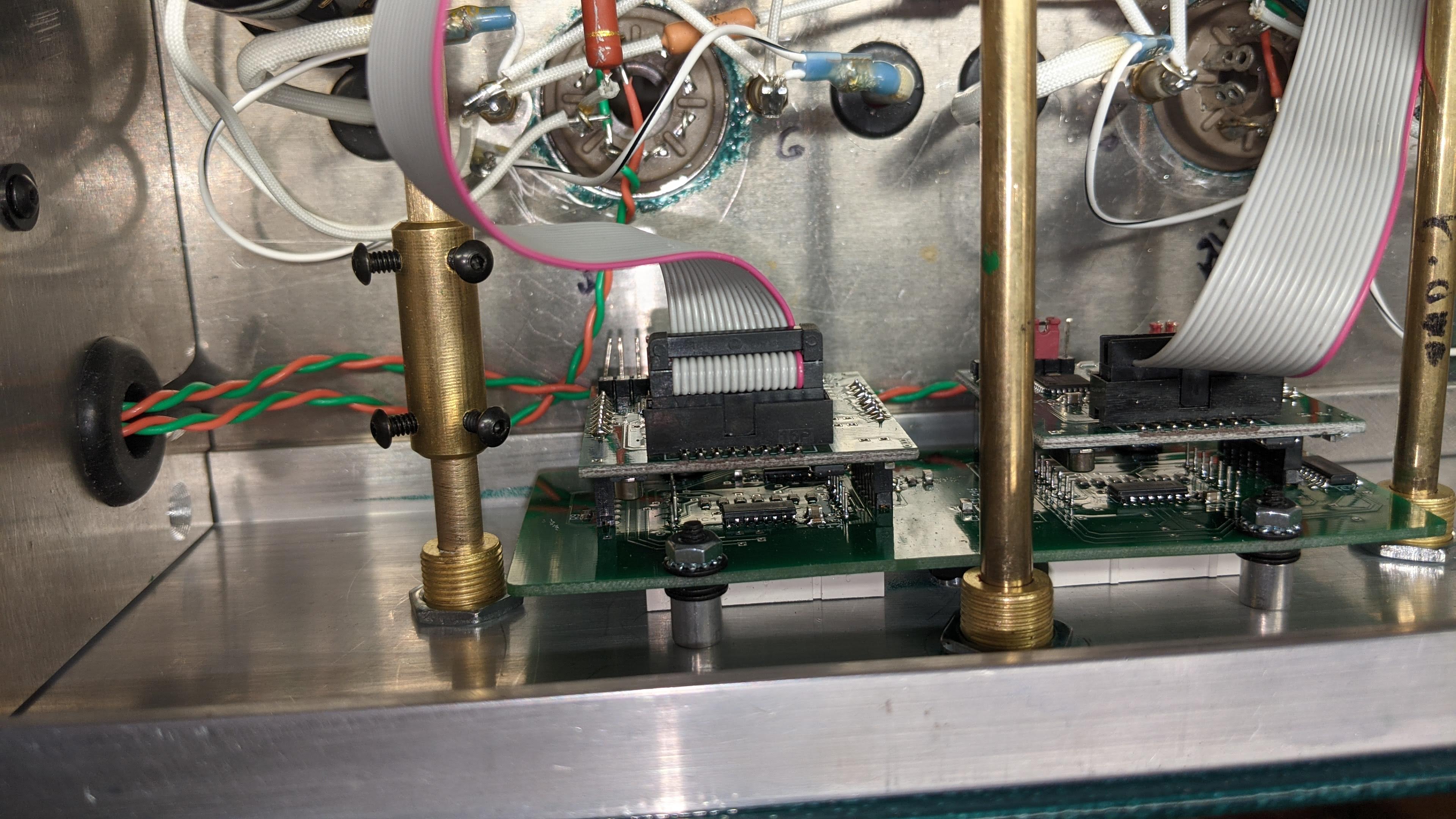

Some inside pics.

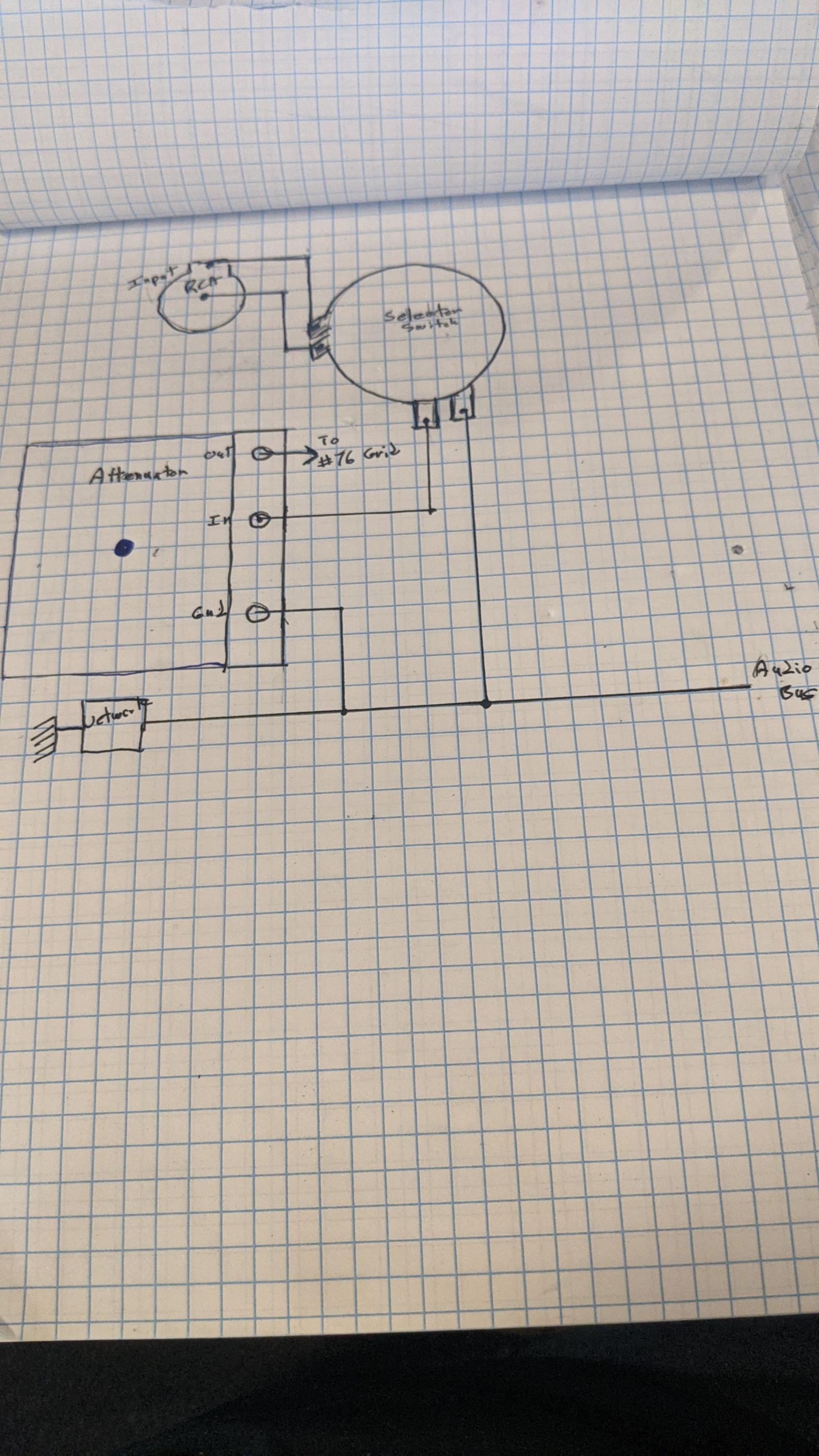

First check where the volume pot connects to the ground bus, compared to where
the tube cathodes and power supply returns connect. Where is that?
Both channels share the same ground bus? Is the power supply wired like the schematic
in terms of how the capacitor ground returns are connected to the rectifier?
Generally, the center of the shared ground bus should connect to the chassis and to the shared power supply.
The audio circuits connect to points farther away on each side of the center, and the input and volume control
returns connect to the far ends of the ground bus.

I have it wired very close to the schematic I sent you. The ground "network" is grounded to the chassis at the input jacks which are insulated from the chassis.
The PSU caps are at the other end of the bus. The cathode, resistor grounds as well as the attenuator grounds and the input and output grounds are daisy chained along the bus. I'll work on a sketch to post.
If the HUM is low @ min volume, and high @ mid volume and then low @ max volume you then have a loop pickup problem. The output Z of the attenuator is max @ mid volume position. What is the HUM LEVEL @ low, mid & max positions?
The 90Hz may be a power supply problem of mismatching of balance of the rectifiers or pcb routing. Do an FFT of the power supply voltages.

REW allows a much better frequency resolution of frequency spectrum than that the plot shown in post #3. In RTA, open the graph controls and in the pop-up box confirm that Mode is set for spectrum - also read the help files for a general understanding of the various controls. Of course that requires a low ambient noise environment when using a microphone. The 'Appearance' controls allow you to display a 'peak' plot that may allow easier indication of main frequency related continuous hum.

There is also a switchmode supply module in that mix?
