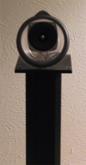

Now that my Zen4 is nearing completion, I finally assembled this Tang Band box - I am not brave enough to hook the amp I assemble directly to my main speakers, the first time. Ultimately I will use these as computer speakers.
The box is .75L (the effective volume is reduced further by volume occupied by the driver). I put these boxes in my main system and was really surprised at the sound (I was very careful with volume control and listened at very low levels). There is no bottom end (as expected), but imaging is superb. Midrange clarity and detail, though not up to par with my main speakers, is also excellent (a lot better than some much more ambitious boxes, for example some PSBs that I have tried in the past). High frequency is rolled off (again as expected). Also, there is something (very subtle) happening in the high frequencies that I do not like (and I think that is the only fault I can find with these). The effect is very subtle and I am not sure what exactly that is. With a box as small as this I was expecting a mid-bass bump, but cannot hear it.

I don't understand your enclosure choice. Isn't it flimzee to say the least? I think what you're hearing at the higher frequencies is the speakers becoming directional, maybe?

Compared to 3/4" mdf? Yeah, but I guess good enough for these 3 inchers. The box is really a lot more rigid than is looks - give it a try sometime, you will be surprised. Also, there is a lot of foul smelling transparent glue at terminal and driver interfaces to make them airtight.

Xyberz said:What is that made out of?
Rubbermaid (hehe). The plastic is very hard - the drill bit 'walks' on it like it would do on aluminum. You would probably need some kind of a circle cutter (definitely a lot harder cutting circle on this with hand, when compared to plywood). The circle cutter I used was pretty hot with molten plastic all over it. Have fun!

The container being quite hard, is also brittle, and broke into pieces when my '2-years old' bumped it off the table. Since I have packed-up my tools till sometime next year, I have not gotten around to fix the broken box yet...I was planning to run them with an old AMC integrated that I got.
