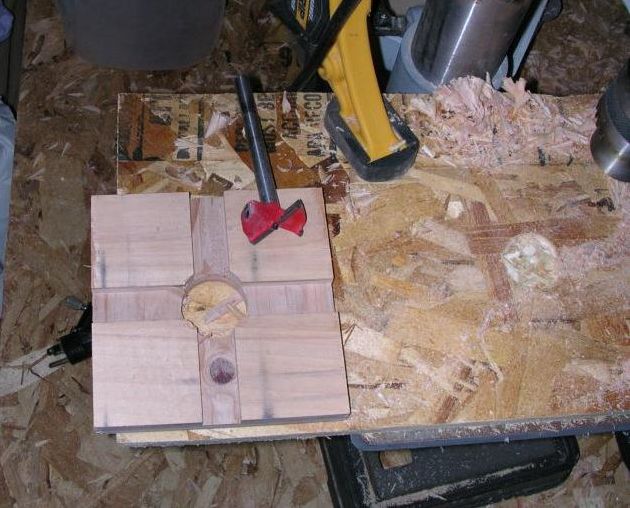

The key is having the proper jigs for your tools. For a table saw a sliding table is a lifesaver. One can be built from scrap wood in an evening. If you are cutting miters it is a requirement that you clamp your work. the angle of the blade with the wood will try to pull the wood into the blade and no amount of holding strength will prevent this. I have several sliding tables. One for 90 degree cuts, and one each for left hand and right hand 45 degree cuts. They are invaluable for working on a table saw.
I also make "goop" to fill any small cracks. Goop is a mixture of wood glue and sawdust. if you mix it in the proper ratio after drying and sanding it will match the color of your wood. Too much glue and it will be too dark and hard to sand. Too little glue and it won't stay together.
In order to align butted joints I made about 2 dozen small jigs. I set the fence for 5 inches, and cut a strip of plywood. I used the chop saw to cut this strip into manageable portions. THEN I cut them into squares using the fence at the same setting as ripping the strip to make squares. Now, set up either a dado cutter with the width of your material (mdf, plywood, bb, whatever) or a straight cut router bit, and cut dados in the center of each square. Turn the square 90 degrees and cut a cross dado. Once done with all the jigs, put a large forstner bit (I used 35mm) in your drill press and drill a hole in the center to allow glue drainage. I had tearout from the forstner, so it may be better to drill the hole first.
To use: put these on each corner of the long piece of wood to be glued and butt the shorter piece up to them... aligning the longer piece in each jig. Remove the short piece, apply glue to appropriate areas then reinsert short piece, making sure they're aligned, and clamp. I also use a cross clamp to make sure the jigs don't fall off.
This is used to align the tops/bottoms/backs/fronts. I've cut the sides oversize and just glue them on, then use a trim bit to trim the sides to a perfect fit.
Here is an example, with pictures, showing how I used them. NOTE: a LOT of glue wound up in the glue hole, and some of them got glued anyway 🙂 Next time I propped the jigs up with strips of cutoffs, and solved that problem.
