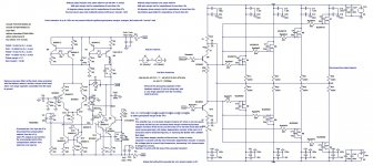

Hi Danny,
Here you go. I have changed the models but that was only so I could run it on my pc. My mods to the schematic are a bit messy (not much spare time) but it gives you an idea of what to change.
Haven't done a detailed analysis but this looks stable under overload conditions.

Sorry. Made a mistake D1 and D2 on my mods (Should be pointing down). They should be the other way round.

Yes, solid state protection is what I am planning on using. I think I can cope with the distortion they add. Just the fact that can reliably break high currents at DC which small relays can't. Big relays can but i don't want such things due to cost and size.
Vertical mosfets are what I am planning on using. Don't need the thermal advantages of Laterals. All that's needed is low Rds ON and cheap devices. I am only at the beginning of researching how I'm going to do this. I will have +/-15V rails available anyway due to wanting to use a DC servo.
All the 100R resistors connected to each output device source is to allow all output devices to be monitored. What happens if you loose the device you are monitoring in original scheme? The rest get fried as the protection circuit is now effectively disconnected.
Minor loop stability, I'm still working on that one. All I have worked out is that you need to use tian probes. But what I'm struggling with is where to put the probe and how to break the loops.
The bad news for me is that suddenly the cascode enhanced VAS has given me a big reduction is THD.

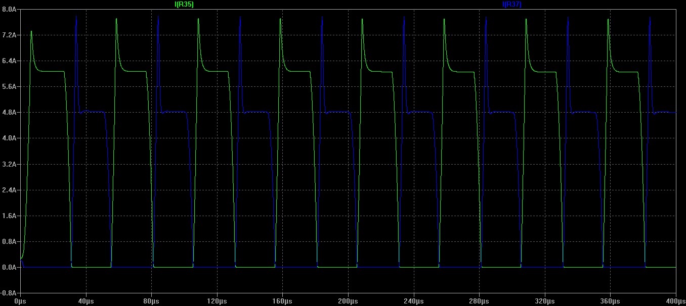

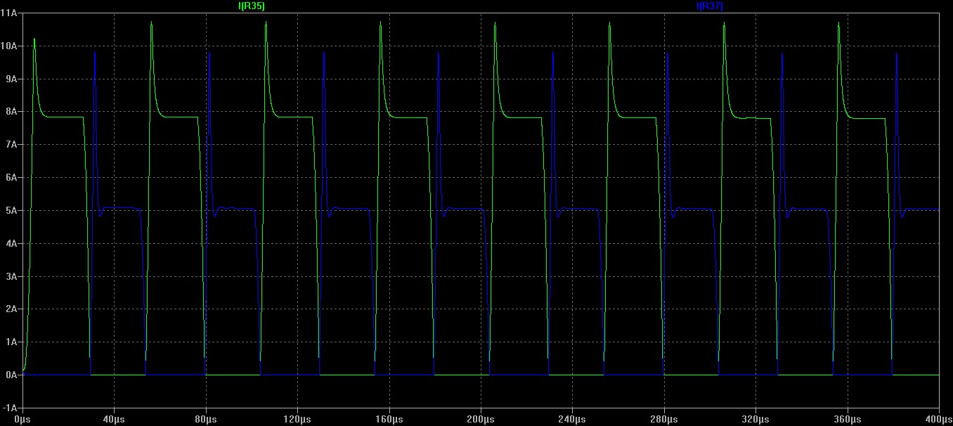

Thank you for modifying the circuit to supress the instabilities 😉
I'm sorry but the circuit now limits the current at 4.8A per device for the P devices, and 6A per device in the N devices and the current limiting has a peaking, could you take a look? Please.
My goal is 6A per device, so N channel is protection is fine. 😀
I'm sorry for bothering you with this. 😛
PS:
You could use my Bob Cordell's models file, that includes the BUZ90x models.
With the output devices I'm using (BUZs), current limiting is up to 8A for the N device, which is unsupportable 🙁
For the N devices it's 5A.

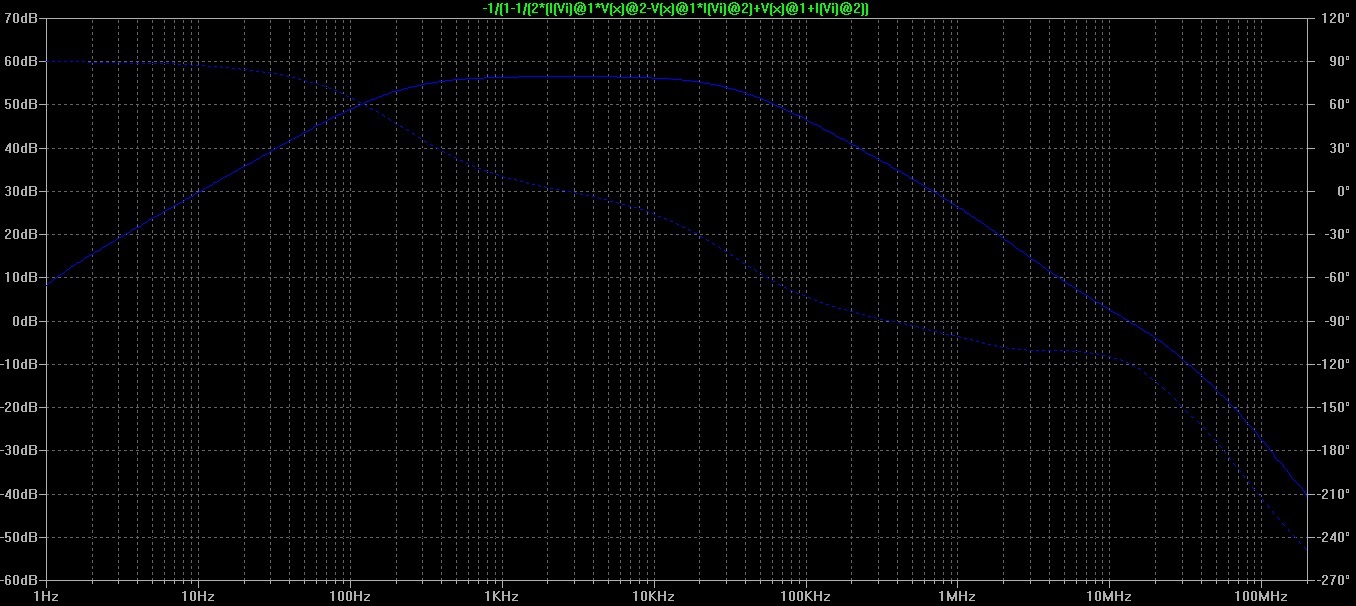

Danny,
The tian probe is explained in one of the LTSpice examples. I think it is Loopgainexample2.
I am currently doing some very basic reading on solid state relays. But currently concentrating on minor loop analysis as I see this as a block on further progress. Will let you know if I gain more understanding.
There is some question whether a DC servo is an advantage. Some say yes and others say not. One thing a DC servo does add is extra noise. I have used one in the working amp (TL072). I personally like them.
In my cascoded vas I have used the 2N device and got a good gain in the new design but no matter what I use in the working amp there isn't any change. Need to understand the factors involved more as manso stated in the Bob Cordell thread. Will try the BC5x0 later and see if there is any change in the new design.
As for the current limiting circuit. Try changing the 100R resistors to 10R and use the A1381 and C3503 transistors. This should work. I don't think there is enough current going to the bases of the protection transistors to turn them on hard enough. You may need to increase the caps in this circuit to keep stability since the resistors are now lower value.

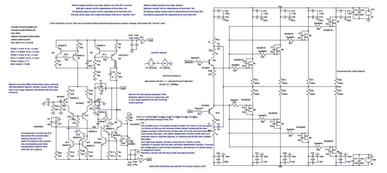

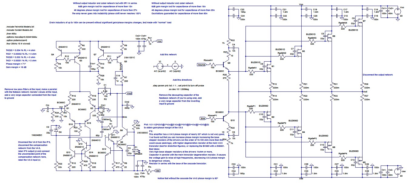

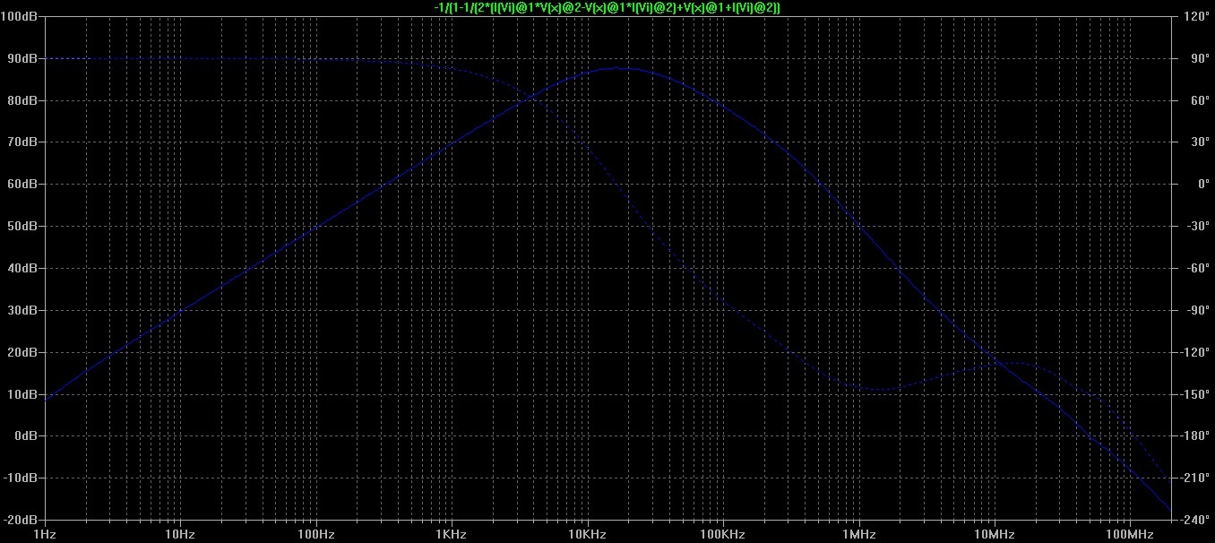

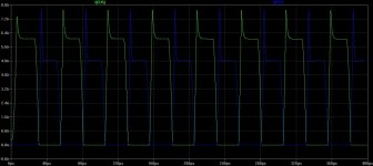

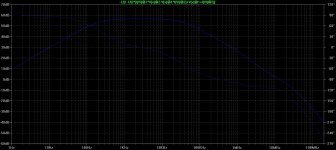

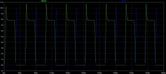

Hi everyone,
Thank you mcd99uk and scopeboy for your great help,
This night I've discovered how to use the tian probe for checking for VAS stability, maybe you already knew how to do this 😛
I've also discovered some changes that could be beneficial to increase VAS stability.
I've found out that my circuit with the cascoded VAS has 30º of VAS phase margin, and 60º with the beta enhanced VAS.
I've the explanation of the simulations and the changes that could be made to improve VAS stability in the LTSpice file attached.
I like to thank to mcd99uk, the LTSpice example really helped me 😉
and to Michael Kiwanuka, I've used some technics of the test circuit he used in the discussion with Bob Cordell about VAS stability.
If you don't know how to probe VAS stability just take a look at my file and tell me what do you think, I'm interested in knowing your findings about how to make a more stable VAS. 😉

I will try the improvements in the VI limiter circuit in the next night, I will try with the 2SC/2SA pair and with different capacitor values. This night was dedicated to VAS stability probing.

Phase margin at the VAS is seen with -180º as point reference, right?
For example if you have -150º at 0 dB you have a 30º phase margin, right?

As a general rule, I would be wary of enclosing more than 2 transistors in the Miller compensation loop. Beta enhanced VAS is OK, but a beta enhanced cascoded VAS is 3 transistors. Returning the Cdom to the input stage makes it something like 4 or 5.
If you want to use more than 2 transistors, you should add a dominant pole to the inner loop you created.
This would make sense. I have found that when using a 3 transistor vas + moving the take off point to the pre-drivers that a 220pF shunt on the VAS output does the job, otherwise there appears to be an evil peaking in that minor loop. Doesn't meet the conditions for oscillation but nonetheless looks bad. As long as the ULGF is low then this shunt does not affect THD but does make stability margins worse. Suppose that this is because the VAS is now slower and adds more phase lag.
Yup. My own personal experience comes from playing with a Blameless type circuit. It ran nicely with the beta-enhanced VAS, but when I tried returning the compensation cap to the input stage (as suggested by Self to improve PSRR) it went crazy.
This has been the my experience too with trying to move the comp cap connection to enclose the input stage. From a global stability point of view everything looked good but when I try to run trans sims it oscillates like a beauty. The phase shift in the minor loop must be too great. Hence why I'm turning my education to the minor loops. I feel this is an important aspect to properly understand to allow progression to more advanced ideas 🙂

Danny,
I will have a look at your VAS stability tests tomorrow. Time has been limited today.
As for my findings (so far) the best method for stabilizing the VAS was to add shunt (lead-lag) compensation to its output. All other attempts have failed miserably.
The servo I'm using is the 2 op amp version from Bob Cordell's book page 160. But I've added a 220n cap across R7. This solved some oscillations I was getting from the servo. In Ltspice I use LT1128 but it really doesn't matter which one you use as long as its a basic op amp. The built in models are said to be inaccurate anyway.
Regarding the cascode VAS . Try the hawksford way. Move the LED connection from the power rail to the emitter of Q5 / Base of Q12.
Your L-FET emitter resistors can be as low as 0.2R for unmatched devices.
A good test for stability is to try and drive the amp with a big enough input signal to make it clip and then add a load to make it current limit at the same time into a Resistor // capacitive (100n) load. You may find some oscillations there.
PS. This was a quick "dumping" of thoughts before bed 🙂

Hi everyone,
Thank you very much for your help, and for your interest in my project, 😉
I really apreciate all the help you're giving to me.
I've a question to do to both of you scopeboy and mcd99uk, are you talking about the Douglas Self circuit of page 248, figure 8.6, with the points A and B?
If that's the case in point B you're including the input cascode transistors in Miller compensation loop, and that will look ugly, as you said scopeboy and I've confirmed, the minor loop is almost 2x more stable with a simple beta enhanced VAS compared to a 3 transistor VAS.
The solution you've purposed mcd99uk, seems good in improving minor loop stability, I don't know if I understand it well I've attached the minor loop Bode plots and a picture of the circuit with the shunt capacitor at the output of the VAS. The drawback are less PM and GM at the global loop and the decrease of the step gain of the VAS minor loop by more than 10x (20dB).
About your questions, bear, the circuit's closed loop BW is aprox 150 kHz (-3dB), I'm not expecting to have those THD specs in real life, I'm expecting that it can go as bad as something between 0.001-0.01% for THD1 and 0.01-0.1% for THD20, but I don't really care about that, I just want to make an amplifier that makes a good sound and with the best THD figures I can get, but that's my first solid state project. 😉
I don't exactly know how to calculate the SR, can you help me here?
The GD capacitor could have another values, but I don't really know if this will influence very much, I was thinking about using 22pF for N-channel and 33pF for the P-channel, but I've opted for use the highest value for both.
I'm using that source resistors value (0R33) because of the VI limiters threshold current.
I know that if reduce them, I'll get better DF, but that's a price I've to pay.
I thought that parasitic oscillations are generally between 1 MHz and 100MHz, that's when the parasitic capacitances have lower impedance. And I can't hear 1-100MHz unfortunatelly. Please, correct me if I'm wrong, the only oscillation that I know that can be heard is motorboating and similar power supply decoupling issues. The other sound is if the output transistors blow up if they are oscillating with a large amplitudes at high frequencies, but I think this is unlikely if you use base/gate stopper resistors and if you've good gain/phase margins, more than (45º/6dB), I would say at least (60º/10dB), but that's my opinion.
mcd99uk I've a few questions to do if you don't mind, are you still using TMC when using the lead lag scheme?
What are the THD figures of your working amp, have you measured them? I'm curious about that. 😉
Have you used TMC and a beta enhanced VAS in your working amp?
I will test your servo in my amp tomorrow, and I'll post the results of the Hawksford connected VAS, and of the capacitive load tests.
I'm a bit hesitant about using a cascoded beta enhanced VAS, it has less THD, but is more unstable, and I don't know if I want to slow it down and wasting some gain to make the minor loop more stable. What do you think?
I will also test and post the results of the modifications you suggested (mcd99uk) to the VI limiter.

Yes, I am referring to the scheme where the input stage is cascoded and the feedback goes through the cascode. Way too many transistors in there. :O
