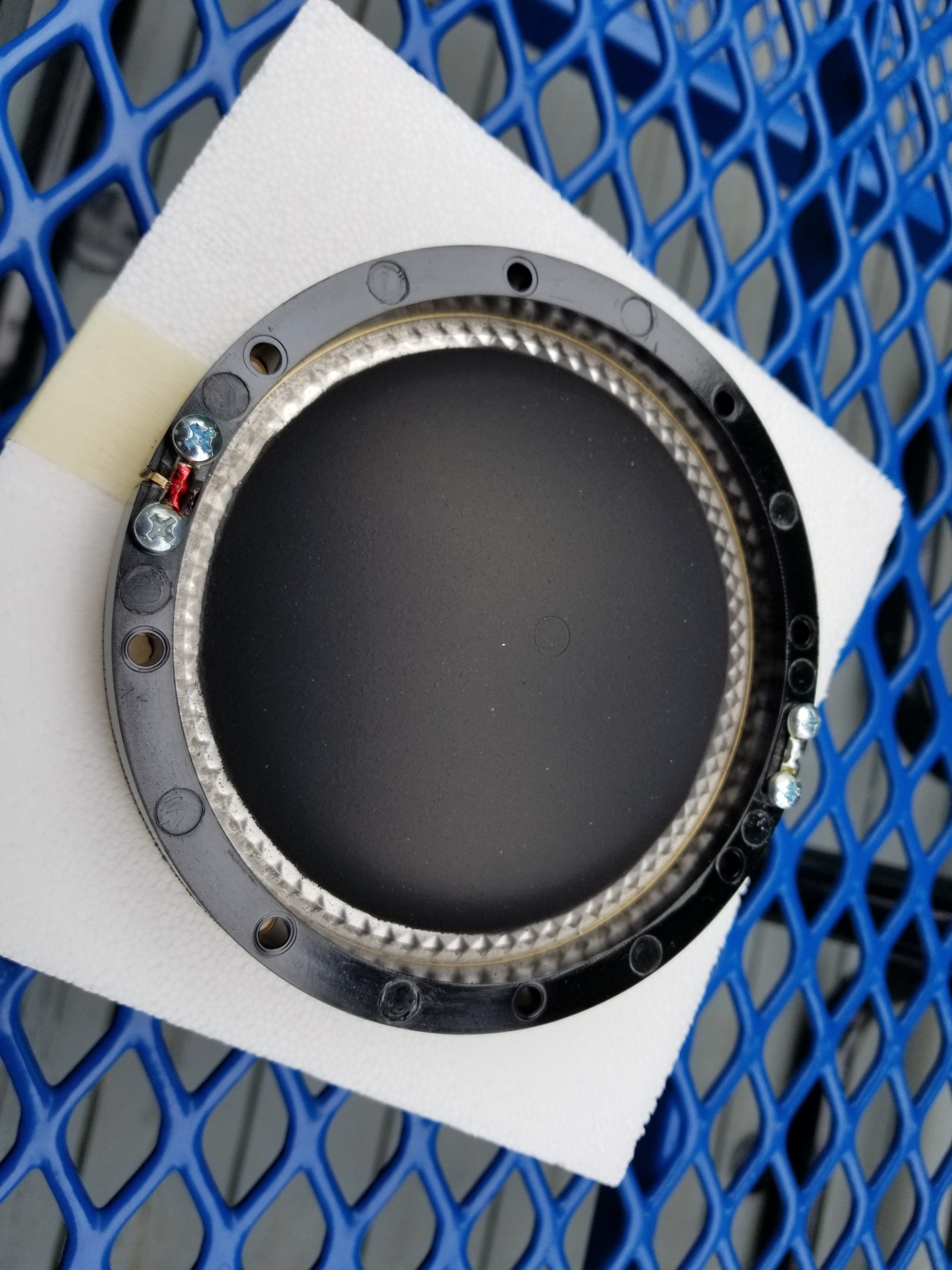

Okay a couple of photos. Plus 1 more out on my walk a couple of days ago. When I do the JBL 2451 aquaplas diaphragms I will take photos of the install in the compression driver
I have only done a few of these and I have no sad stories to tell. I have done 2425 drivers, 2445 drivers,2450 drivers and now about to do a pair of 2451 drivers. The aquaplas coated diaphragms in the 2450 really smoothed out the breakup above 10kHz.
The diaphragms I have seen have the rigid plastic rim with screw wholes around the perimeter. By the time all the screws are started in place not even snug there is little to no room to move just a little bit.
For the next pair I will take a closer look to see if there is any movement with a little tap tap nudge nudge.
I do a test sweep with the Audio Precision APx500 Rub and Buzz software, and have not needed to take things apart to start over. Lucky.
Thanks DT

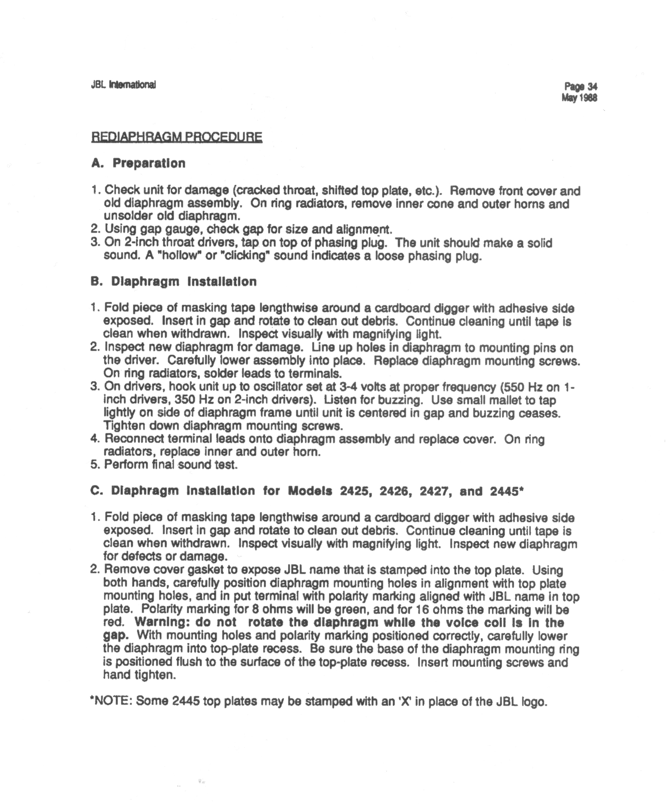

Your provided instructions from JBL filled the gap of missing information.

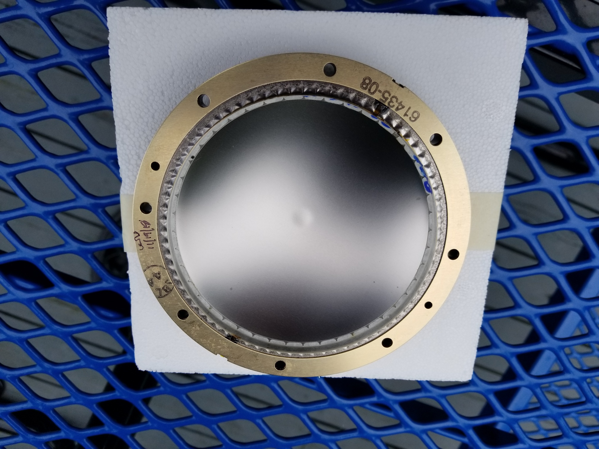

Hello,
If you zoom in on the photo the diaphragm has a 2018 date on it. I bought it 3 years ago, it has been on the shelf since then.
