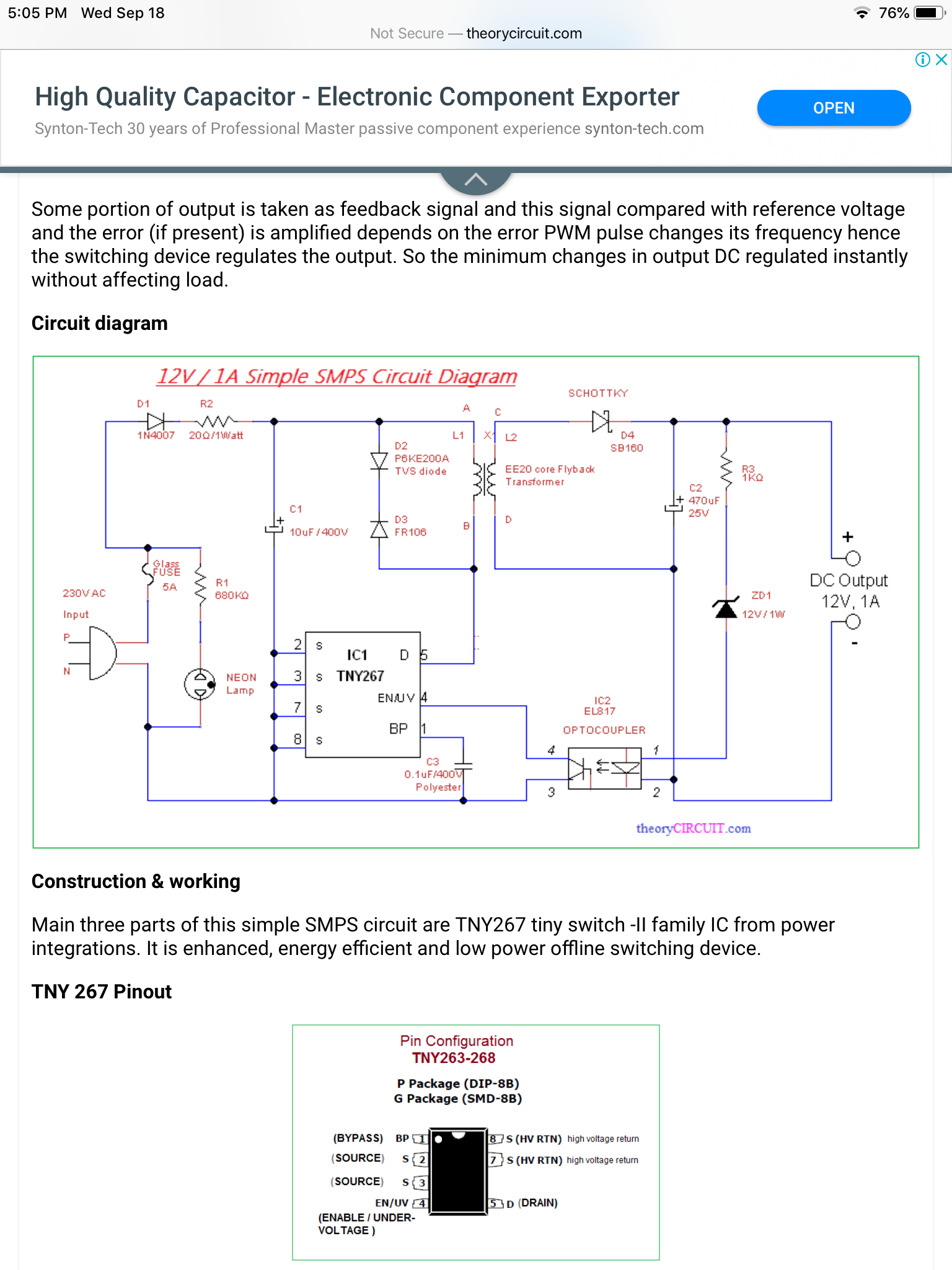

Come on guys, my problem isn’t a 10,000watts amplifier it’s just a little smps with less than 16pcs of component not even bigger or complex like my iPad charger.
I’m literally just begging for 3-4amps of power (I already have the voltages under control) there must be an pwm ic that uses few parts whether internal or external mosfet that you can recommend on a schematic (I’ll take my chances I have a lot of these boxes so I will get it right).
This was the design I modified to the circuit to drive the smps transformer, however the transformer has two primary winding unlike one in the schematic.

Some points about the posted SMPS schematic:
i) The mains voltage is halve wave rectified
ii) The high voltage switching transistor is integrated in the IC
iii) The switching transformer is of the flyback type
iv) The IC is supplied power through an electrolytic capacitor used as a voltage dropper.
In such a design, current output is limited by the current handling capacity of the flyback transformer and switching power transistor. The transformer has the highest bearing on this current limitation.
How it works:
Energy is stored in the transformer core as a magnetic field. The magnitic field intensity might almost reach the core's saturation magnetic field. Trying to magnetise the core beyond this saturation, results in its magnetic field failing to rise with magnetising current preventing the primary from setting up a back emf. This situation, leads to the switching transistor having to handle all the supply voltage resulting in a short circuit transistor condition. This is catastrophic for the switching transistor.
To increase the current output in any flyback SMPS, you will have to change the switching frequency and the turns number on the primary coil and secondary coil. This can be achieved by calculating the new higher operating frequency and changing the frequency determining capacitor if it is an external component.
One tempting but apparently simple way is to use full wave mains rectification instead of the existing halve wave rectification. You can also add a smoothing capacitor to the rectified mains. This will, however, force you to use a resistance voltage dropper instead of a capacitive dropper for the IC. This should, in theory, double the power.
Note and Warning:
I do not know whether the chip will like full wave rectification instead of halve wave rectification. You will have to understand the datasheet that comes with this chip. This chip seems to be designed for SMSP power factor correction which expects a rectified sinusoidal input voltage.
Could you practically make the edits on the schematic I post and repost it back, the transformer that I have tho is 2pairs primary windings.
If you search for the chip datasheet you will find a circuit using it employing full rectification of the mains. The problem with this circuit is the fact it uses a very high voltage. Rectified mains is 330V DC in Europe and around 160V DC in the US. An error or omission, can easily result in circuit destruction. This is why I am suggesting you to consult the chip datasheet as published by the manufacturer. You have also to make sure the power supply works as intended before powering anything with it you are not comfortable to destroy. Besides this, such a power supply requires a current limiter during the testing phase. You can use a low power (10W) mains filament bulb. Do not use higher ratings as this is a low power circuit. As a load you can use a wirewound resistor or a low voltage light bulb.
I beg your pardon if this post disappoints you, but high voltage has no mercy on components. Furthermore, the forum rules bind respondents to warn readers when high voltage is used. Testing this circuit after adding a full rectifier bridge, a smoothing reservoir capacitor for the rectified mains, and a dropper resistor for the chip, has to be planned and done carefully to avoid destruction of the circuit and injury to yourself.
A simpler and more secure way, is to find a replacement SMPS power supply which delivers the DC power and voltage you require.

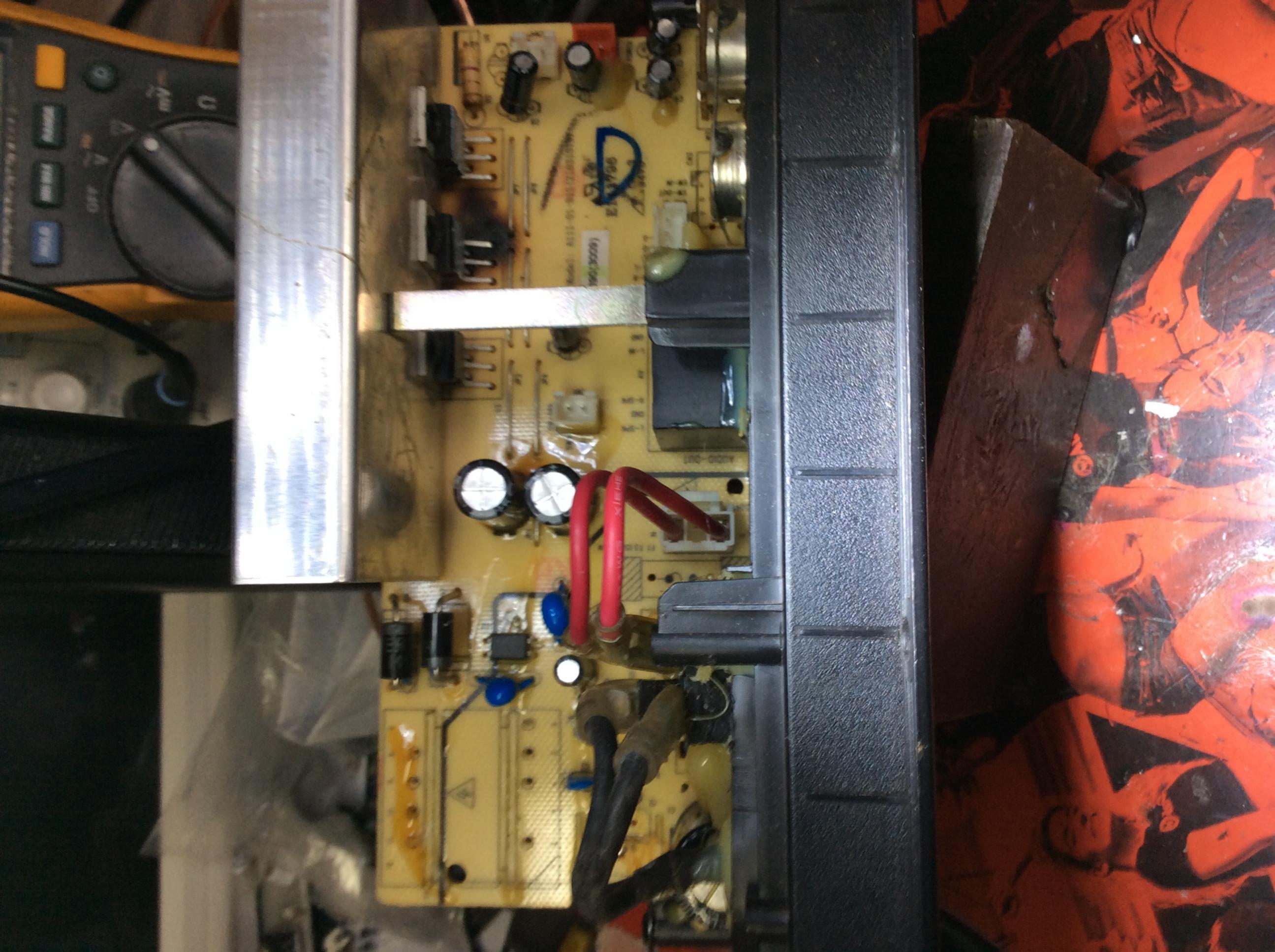

I’m converting to linear, smps didn’t turn out well on the forum.
I’m at 12v center tap transformer with 3amp, I’ve wired up it plays loud, but it’s swinging from between 11ish and 13ish on idle it’s at 15ish, my question are as follows:
Why is it still cutting out when driven volume hard, I’m still losing amperage. **(it’s way better than previous with the smps tho)
Should I just add the secondary transformer wires where the smps secondary was removed?
Should I remove the two diodes and add an full bridge rectifier?
Should I upgrade 25/1000uf to 25/2200uf?
Should I use a 12v (pos) regulator for the usb/card reader circuit.
What can be done to make it stablish?

Hi Formas,
With an ordinary transformer and full-rectification using a bridge-rectifier, the power line decoupling capacitors are recharged by the transformer every 10ms. In-between the recharging, the current for the amplifier is taken from the decoupling capacitors.
A 10000uF capacitor will in 10ms loose 1V of its voltage when loaded with 1A.
With 60Hz net frequency, it is slightly better but not much.
In your case when you turn up the volume, let's assume you pull a current of 1A. With only 1000uF, the capacitor will lose 10V in 10ms. If the capacitor was recharged to 16V for a start, it will fall well below 10V toward the end of the 10ms period. You have an enormous voltage ripple when you turn up the volume. That shows when you measure an "11ish" voltage with your voltmeter (slow).
Further, it seems you are using only two diodes thus single rectification. Then, the period in-between recharge becomes 20ms and the voltage drop the double!
You need to use the 12V center tap trafo with a bridge rectifier and at least 10000uF for each voltage rail before it will start function well.
You can leave the 1000uF that are already there. If you have decided for a traditional transformer supply, you better remove the two diodes such that the old SMPS power supply circuit is disconnected from the amplifier. The outputs from the new 10000uF (or more) capacitors are connected directly to the 1000uF capacitors. Be careful using the correct polarity.
