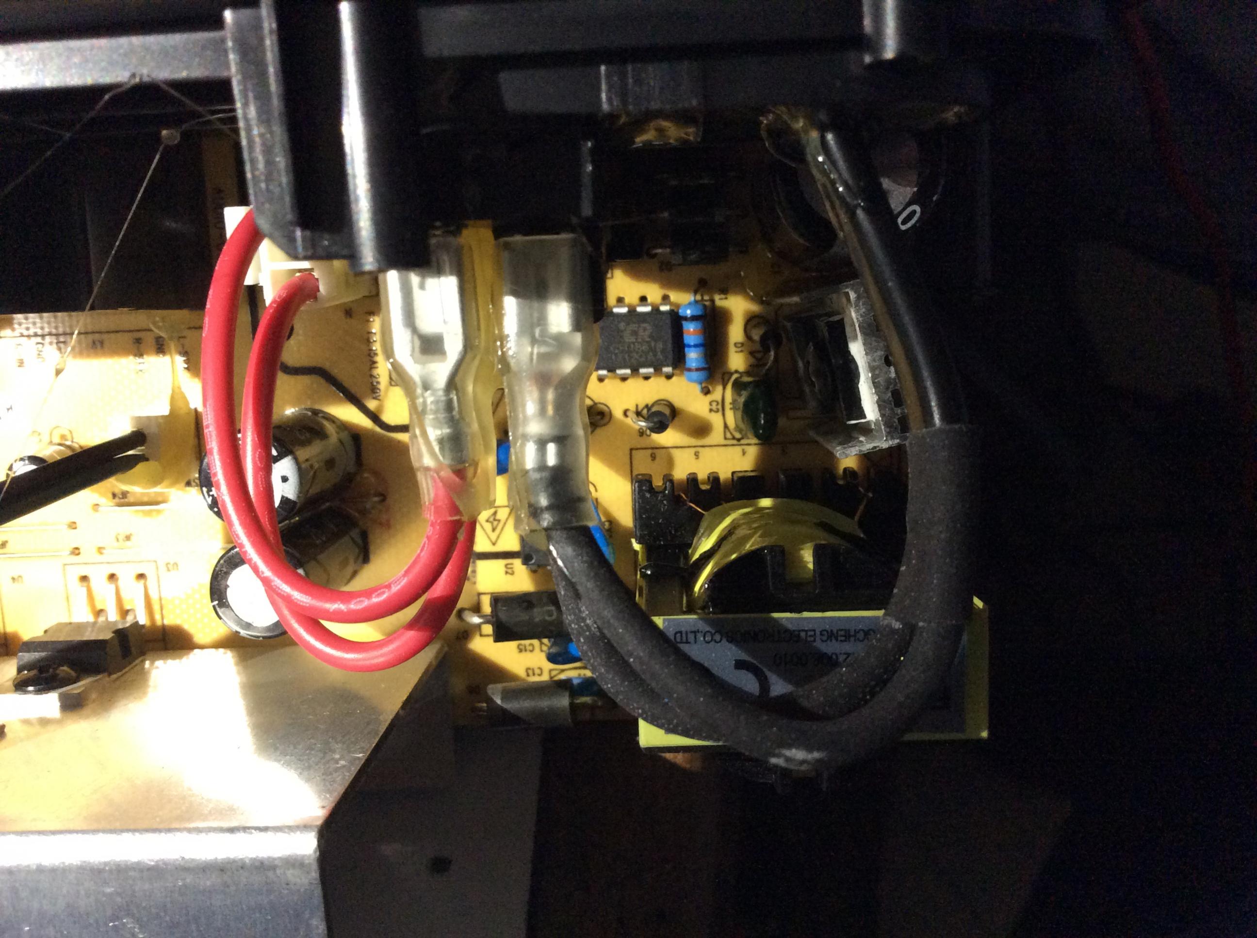

There are some IC's like you say, try the TOPxxx series, but at your own risk. Keep in mind that those IC's uses line voltages directly rectified; so, observe line related circuitry precautions.
Why not put another of the same type back in to get it going. The only way to increase the current, is to replace the copper, in the transformer/inductor with the correct area for conduction. The iron/ferrite is probably OK.I have a computer sub box with two full range speakers, the PS was blown and trying to convert another ic in the circuit, I pulled a few parts to accommodate the modifications but my problem is I’m not getting much amperage. The voltage is 16vdc+/- but when attenuating it chips out. If I change the feedback resistor I’ll get a lower volt (10v+/-) with more amp that plays a bit higher but will still chip out if given more attenuation.
Is there any ic that can drive the switching transformer without an external mosfet/regulator that can produce more amp in a 4pin dip package?
I’m currently using the TNY268.
To increase the current means increasing the SMPS drive power, increasing size of transformer and increasing power capability of output stage.
Probably easiest to just buy a more power SMPS.
So would a linear center tap transformer (15-0-15) work if I wired it to the secondary (removing the smps of course) if yes what amp transformer?
As "safe play" a 15-0-15 transformer will give you around +/-22Vdc in idle mode dropping to +/-20-21Vdc in use. The advantage of such a traditional transformer is that the simple design rarely fail. In countries where transformers are produced, they can be bought at very attractive prices. Here, the transformers are as such not expensive but shipping costs are high due to the weight.
You will need a 4-5 Amp capacity thus a 120VA-150VA transformer.
Listen first to the ideas about recovering the existing SMPS. Then, make your choice. If you had the schematic of the "old" SMPS I would consider reworking that one. Without a schematic, I fear it can be quite some work.

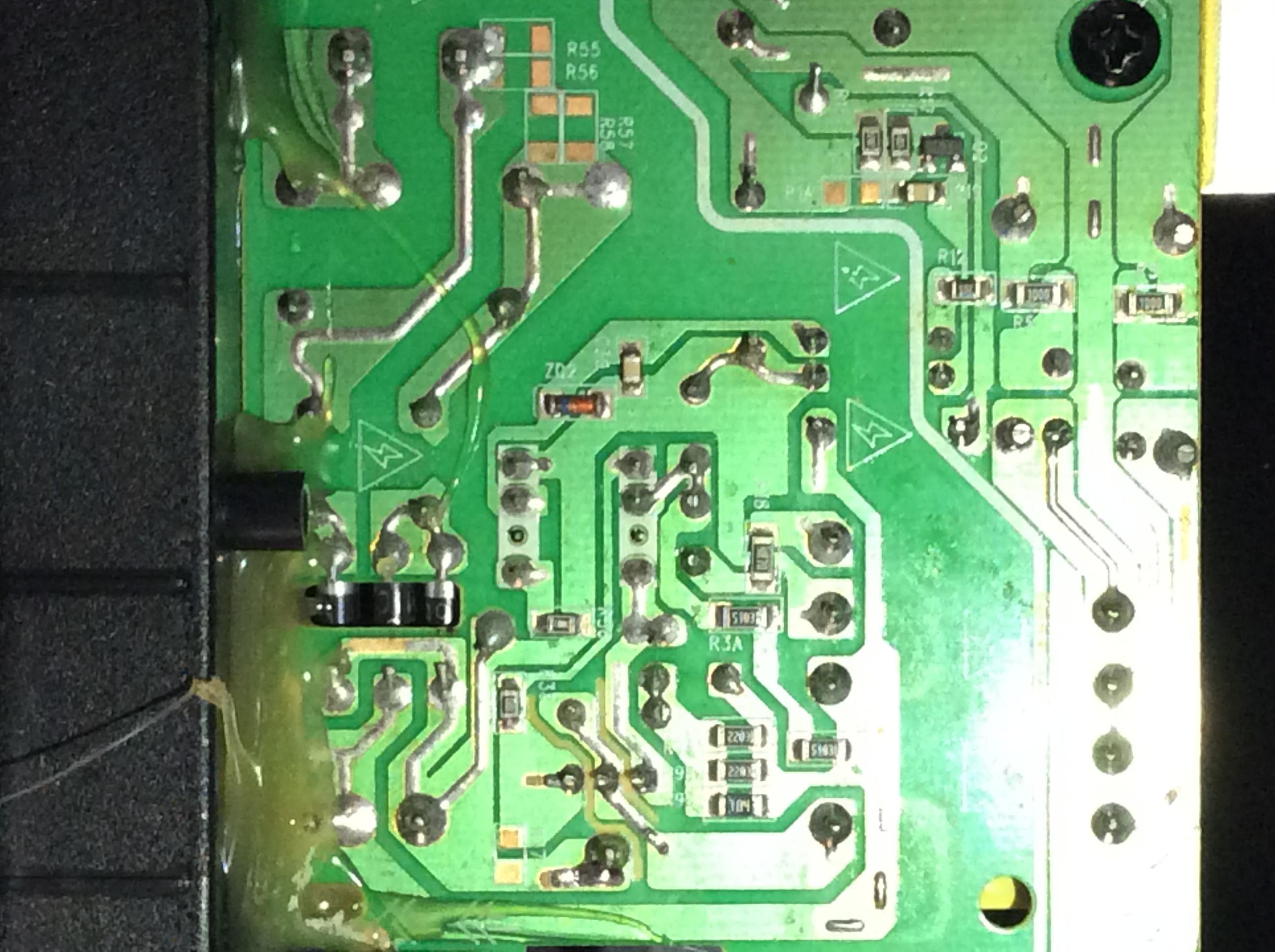

The smps transformer isn’t damage, it was the same one that worked it. I’ve only changed the components that was driving the transformer. The specs on the transformer have the capability to give more, I simple just don’t know how to drive it harder.Why not put another of the same type back in to get it going. The only way to increase the current, is to replace the copper, in the transformer/inductor with the correct area for conduction. The iron/ferrite is probably OK.
Why you all can’t understand what I’m saying.
I know it’s a complex circuitry and I have limited knowledge but you guys keep saying I can’t get more and I need bigger transformer, it’s the same one that use to work and produce sufficient amperage for the outputs.
All I want is just some simple diy builds of different types of components driving a switching transformer built in-chip or external mosfet/regulator. Simple.
I believe Formas is right in that probably the old SMPS circuit was sufficient. Thus, that the SMPS transformer should be able to give the necessary output power as is. For some reason the primary switching circuit stopped working but that could be due to poor component quality.
Formas' request for more power relates to his attempt to use a TNY268 as primary switching circuit. The TNY268 IC did not drive the SMPS transformer in a way to deliver its maximum power (it was a gamble with the TNY268).
If we can find a primary switching circuit that drives the SMPS transformer as in the old circuit, it may work well.
But, that is not going to be straight forward.
We cannot just replace the old broken components as they are Asian rare. We will need to know the old SMPS circuit in order to know the original topology and in order to adapt component values. We can most likely find components to replace the old primary switching circuit if we know the topology. Finding the optimum switching frequency (and phasing of the windings) for the SMPS transformer is more difficult but depends on the topology as well.
Formas, are you willing to draw-up the old SMPS circuit from the PCB layout and the components mounted there (reverse engineering)? We will need that to find the right replacement switching circuit.
If not, replace the old SMPS circuit with a new power supply.

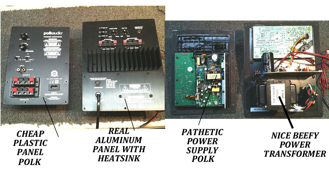

For my friend's Polk subwoofer, I took the easier, more reliable and sensible way to fix it.
Apparently, these SMPS subs are crap, there are loads of complaints about them.
SO.......
OUT with the BAD (smps)......... and IN with the GOOD (pwr trans).
