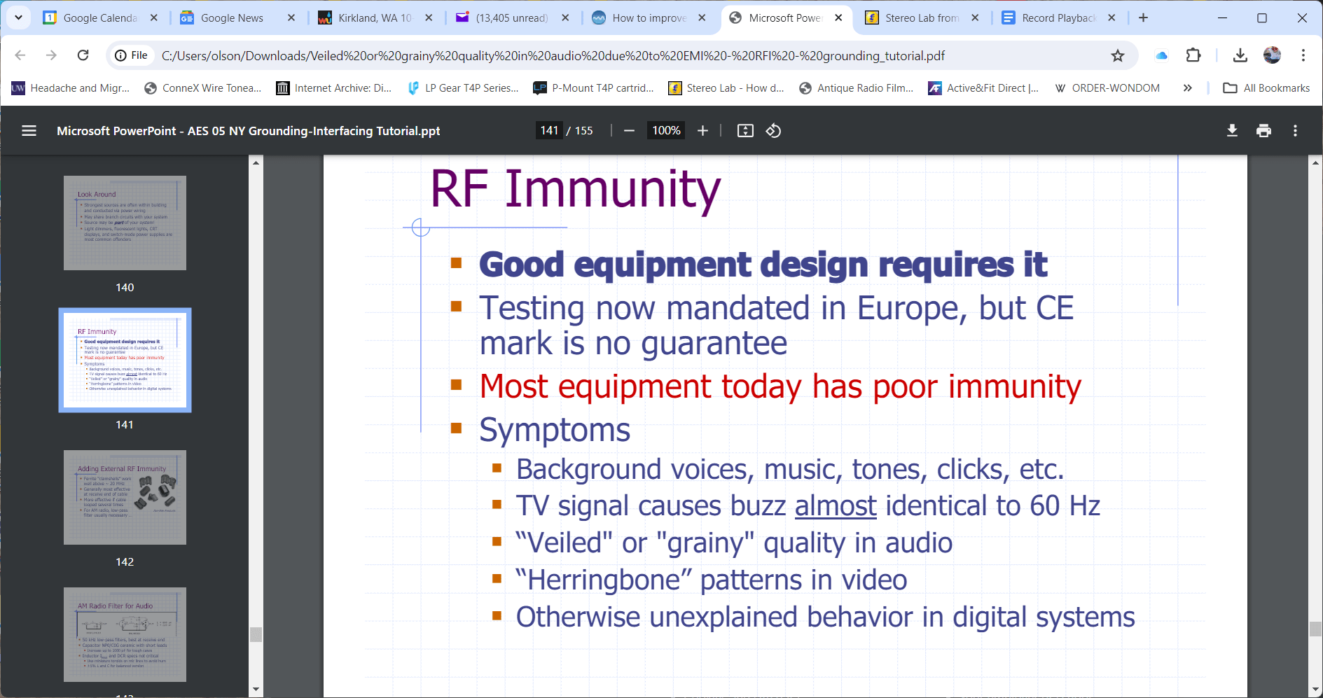

An actual expert should be able to produce ample evidence.
Oh, he does.
He is:
Bill Whitlock
President, Jensen Transformers, Inc.
Member, Audio Engineering Society
Senior Member, Institute of Electrical and Electronic Engineers
The slide deck of one of his talks was already posted by me, but of course it was ignored by people uninterested in the scientific facts.
The theory is in the next attached document.
EDIT: You might want to search for the words 'veiled' or 'grainy' in the first document.
Also please see the reference documents listed at the end of the 2nd document.
OK, so that is all standard electrical engineering. I would say 99% of that applies to concert or recording studio systems where equipment is spread around a large room or venue with equipment plugged into multiple power outlets creating obvious ground loops. So the professional equipment uses isolation transformers and differential outputs and inputs to reduce the susceptibility to common mode noise and ground loops. I've setup equipment for concerts and recording studios, so I'm familiar with all of that. None of that is magical "veiled or grainy" sound. It's just plain electrical susceptibility where the noise can be measured and is audible when the music isn't playing. In a home stereo you avoid all of that with short cables, quality shielding on single ended signals, a ground star, and plugging into a single outlet.
If your grainy sound is due to RF susceptibility, there is a strong RF source near by and you have a cable acting as a loop or straight wire antenna and that's easy to deal with. Twist the wire, reduce the loop area, use a ferrite bead to increase the common mode impedance or get well designed audio equipment that isn't converting the common mode RF signal into an audible signal. This is all easy to measure as the signal is there all the time, even when the audio input is not. You should be able to walk up to your speaker and hear it if it is there when the music is not playing. It doesn't magically appear only when the music is playing.
The last system I worked on that had this type of problem had a very famous and expensive tube amplifier from the 1960's. Most of the systems with these issues have a component that simply didn't follow good design practices leaving them open to receiving noise in various ways, often rectifying the RF and then adding the demodulated waveform to the audio.
