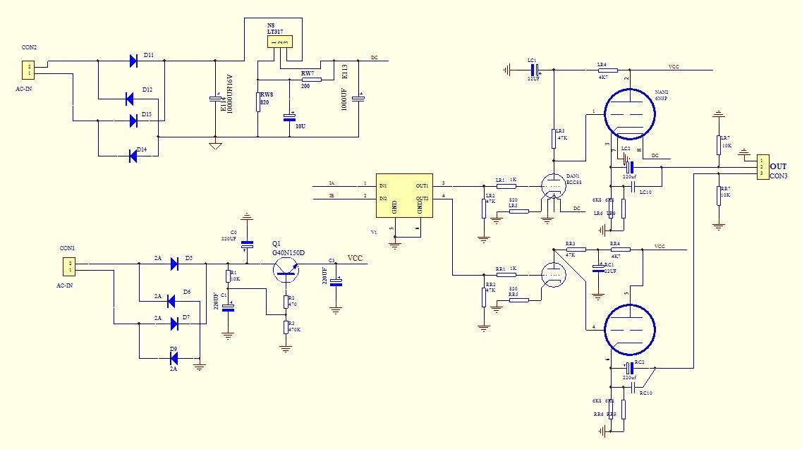

The reason I was using DC regulated voltage was because that is what they used in the kit I built first and the kit has no hum. This is the link to the kit
Nobsound 6N5P+6N11 Vacuum Tube Headphone Amplifier Board DIY KIT Single end Class A Amp|Amplifier| - AliExpress
and the schematic for the kit is attached:
I didn't have the voltage regulator they used for the B+ so instead I used a standard circuit of bridge rectifier followed by cap followed by voltage dropping resistor followed by cap followed by voltage dropping resistor followed by cap. This circuit works perfectly in some of my other types of tube headphone amps.

so to sum it up, i use the headwaze circuit for the amp itself, the aliexpress circuit for the filament power supply and my own custom B+ supply.
One more note, the circuit diagram for the aliepxress circuit has a 317 voltage regulator, which would not withstand 3-4A current. The kit uses a LT1083 high amp regulator and that is what I am using

Hmm if Q1 is being controlled by an AC rectified input then all that's going to happen is the output is the same rectified output?
I can see a LPF as LC1 and RC1 with 21uF.. but I'm not sure that would really provide much ripple control.
I'm not an expert but that seems missing something.

1) pull out the 6v transformer and move it away from the amp board
2) separate the ground on the filament power supply and connect it indirectly to ground through resistor / capacitor.

Did you measure the heater supply voltage and the voltage across the 10000uF? The first stage is investigation.
PROBLEM SOLVED !!!!!!!!!!!!
Thanks for all the suggestions. Based on your input this is what I did. I took the complete filament circuit and separated it from the amplifier circuit so that it is only connected to the amplifier ground in one place. Before I had the filament circuit connected to the amplifier ground at several places. For some reason the hum completely disappeared. This is beyond my knowledge of electronics to understand why that fixed the problem, but I am happy that it is fixed and I have learned an important lesson.

That must mean you had some serious return currents passing a sensitive part of the circuit (the input/gain stage). When only having a single GND connection, the currents are forced to go in the heater wiring, and not find an easier lower impedance path which can also be near something sensitive.
