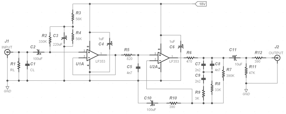

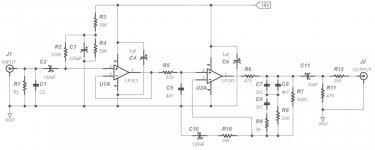

I have built several stages of DIY phono, some published in DIYAUDIO.
But I always have the doubt that is what gives good dynamics to a preamplifier.
I have passive phono preamps; assets; mixed
Some I like their sound but they do not have good dynamics and vice versa.
You seem to be saying that you don't like the sound of "good dynamics", is that correct? What is it about dynamics that you would call "good"? Why do you not like that sound?
Can you give some examples of phono stages that you built whose sound you liked but which lacked good dynamics? Can you give some examples of phono stages you have built that had good dynamics but whose sound you did not like? What was it about the sound that you did not like, besides the good dynamics? How else did they differ sonically from those which sounded good?
Did you find any correlation between circuit topology and good dynamics?
In all of them I use the same power source (50 watts and ultra-fast diodes); and the rest of the audio system is the same
OK that's good, you kept the power supply the same. Is your psu regulated? Have you tried different power supplies while keeping the amplifier the same? It is possible that what you are calling dynamics is related to PSRR, in which case changing the power supply might change the dynamics.
