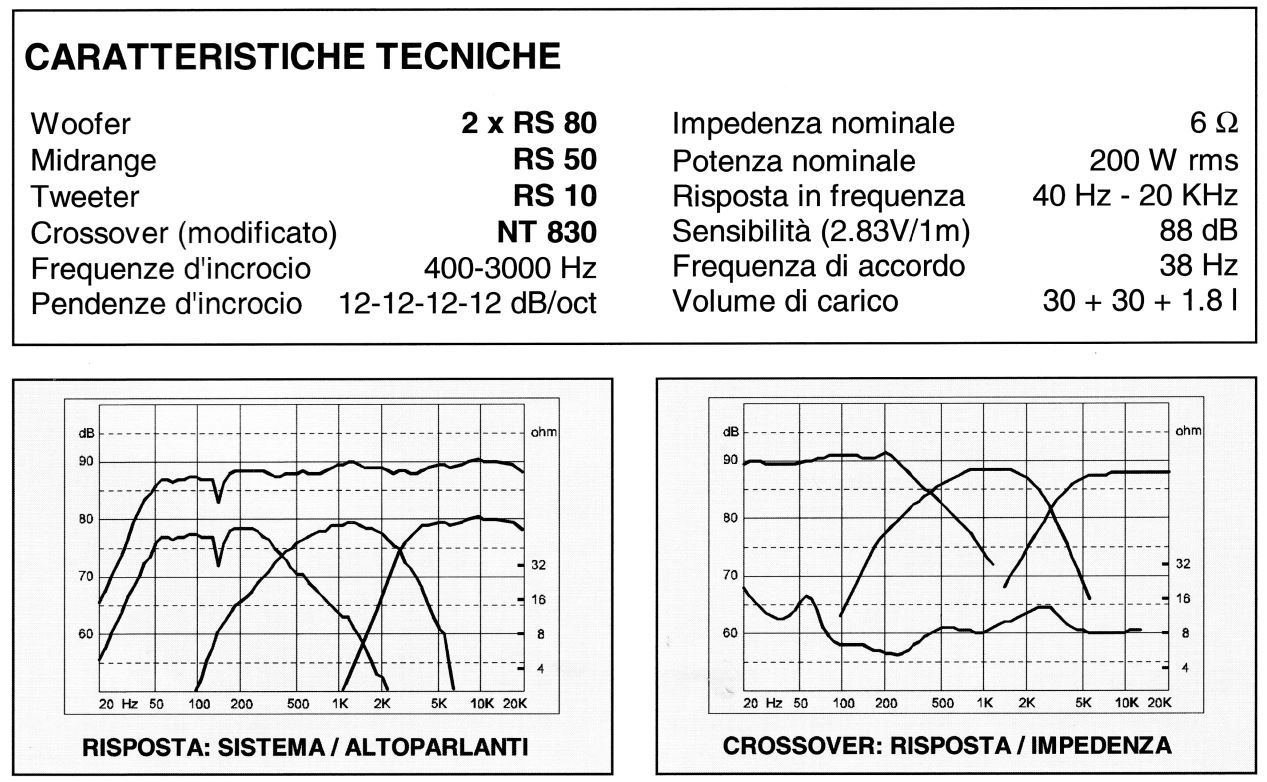

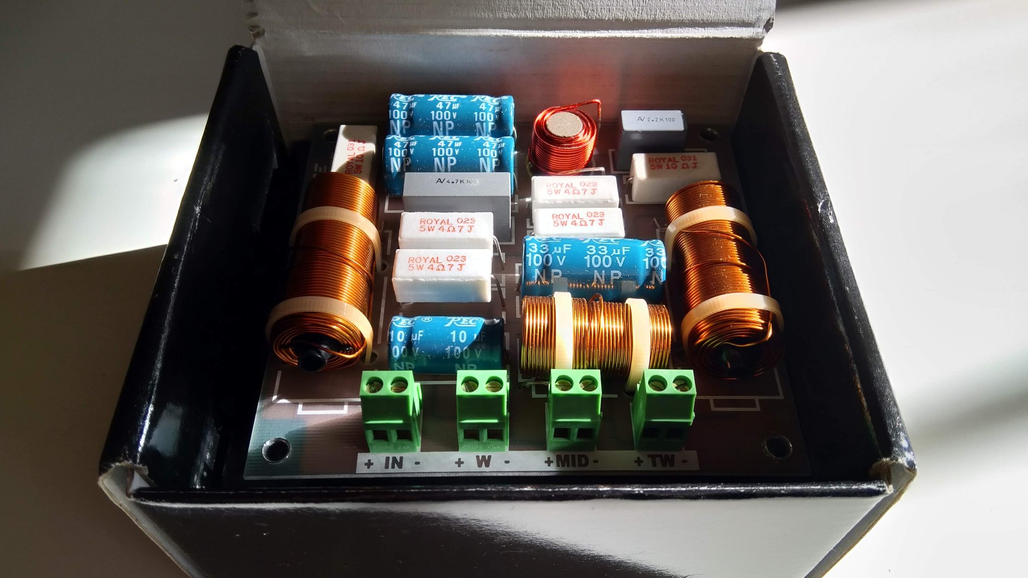

The original crossover is still in its box:
Honestly, I do not even remember if I ever tried this one, but the good thing is that I have all its specs. (in Italian) but you will understand them: 😉
At least, I do not have to change anything on this one, but I expect a totally different sound coming out from my speakers, who knows. 🙄

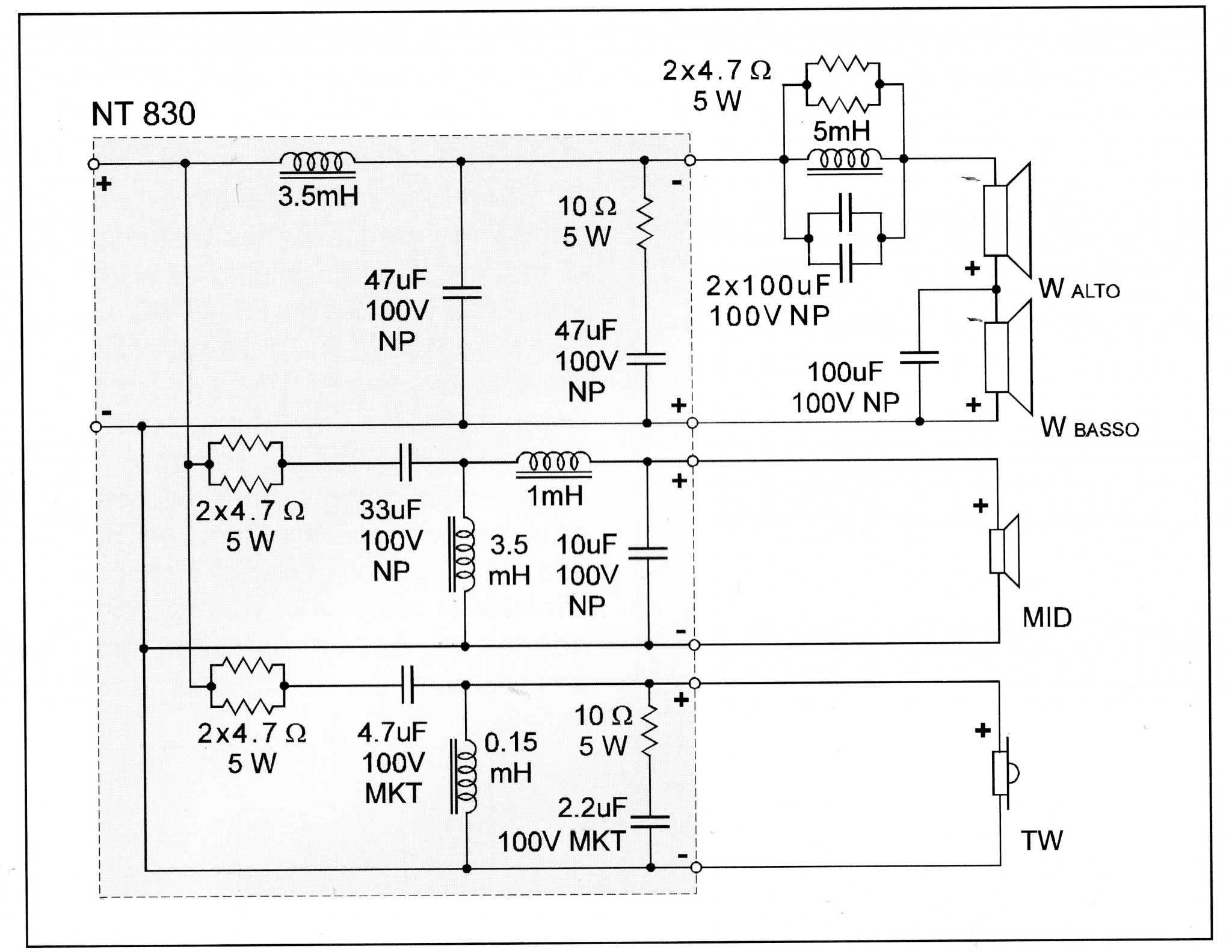

Taking a closer look, the NT 830 board does not include the additional 'response shaping' components for the woofer pair, i.e., the components outside the shaded box on the schematic.
You are absolutely right, in fact, in the original project they state that the default crossover was the NT830 to be completed with the supplemental missing network (woofers).
So I need to create a separated PCB and connect it with the NT 830.
What would be the easiest and proper way to do this?
Alex

You don't really need a PCB.
The single 100 uF capacitor could be hard wired straight across the terminals of the low bass (basso) woofer.
The contour network of parallel resistors, inductor and capacitors could be attached to a plywood base and hard wired together, then wired in series with the upper bass (alto) woofer. You can drill holes in the plywood to accept plastic cable ties that can hold the heavy inductor down securely.

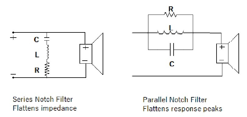

Hi folks,
I downloaded a software to create the schematics, there are many to choose from, I tried KiCad 7.0.
I studied how it works and started to draw the schematic of the 'parallel notch filter' you see in my post #67.
- Could you please tell me if the drawing is correct?

Your drawing looks correct, Alex. Well done handling the software!
I'll say again that this arrangement of components is so simple it does not require a PCB.
The physical components in a loudspeaker crossover need only be within 10% of the theoretical value, except in very critical applications.
Therefore, you could substitute a single 220 uF capacitor for the two paralleled 100 uF capacitors (equivalent to 200 uF).
Similarly, a single 2.2 ohm resistor could replace the two paralleled 4.7 ohm resistors (equivalent to 2.35 ohm).
These substitutions would greatly simplify the process of hard wiring I described in post #71 - give it a rethink.

What you state is true, but I wonder why the original manufacturer did not simplify that way in the first place, there must be a reason why they have preferred individual components.
Also, about the inductor required of 5mH, my current crossover has one of 5.6mH, very high quality, you can see the details here , I am pretty sure I have seen somewhere a formula to reduce the number of windings to take it down to 5mH, but cannot find it right now.
