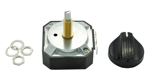

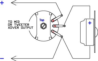

Why not l-pad? Its variable, you can adjust highs to any level, instead of testing various resistor values and swapping.
https://www.parts-express.com/L-Pad-100W-Mono-1-Shaft-8-Ohm-260-265
I've been using the same set of variable L pads on my lounge speakers for over 30 years and have had no problems with reliability.
re:'downsides to using an l-pad" - they are usually only used for an initial setup, then left in a single position. Over time, the rest of the element becomes oxidised and sounds scratchy when the wiper is moved. A pair of fixed resistors eliminates this problem, and is cheaper.

I have nothing against the L pads but I guess I would need to drill a hole on the back of the speaker, like right above or below the banana connectors.

You're thinking of a variable L-pad. Quality isn't a concern for sound.. maybe for mechanical feel and durability. Consider power handling as always.
Yes, if you add a variable L pad control you need make no additional changes to the crossover circuit.
Rather than drill holes in your lovely enclosures, you may like to reconsider increasing the value of the 1.8 ohm resistor (to 3.9 ohm in the first instance). This is a simple and easily reversible solution to your problem.
P.S. All currently available L pad controls probably originate from the same factory. The one linked to by adason is typical of what is available. They do, however, come in different power ratings. I can obtain 8 ohm L pads in 100, 50 and 15 W versions.

Here are the L pad options available to me: https://willys-hifi.com/collections/l-pad-attenuators
The 50 W version looks neat!

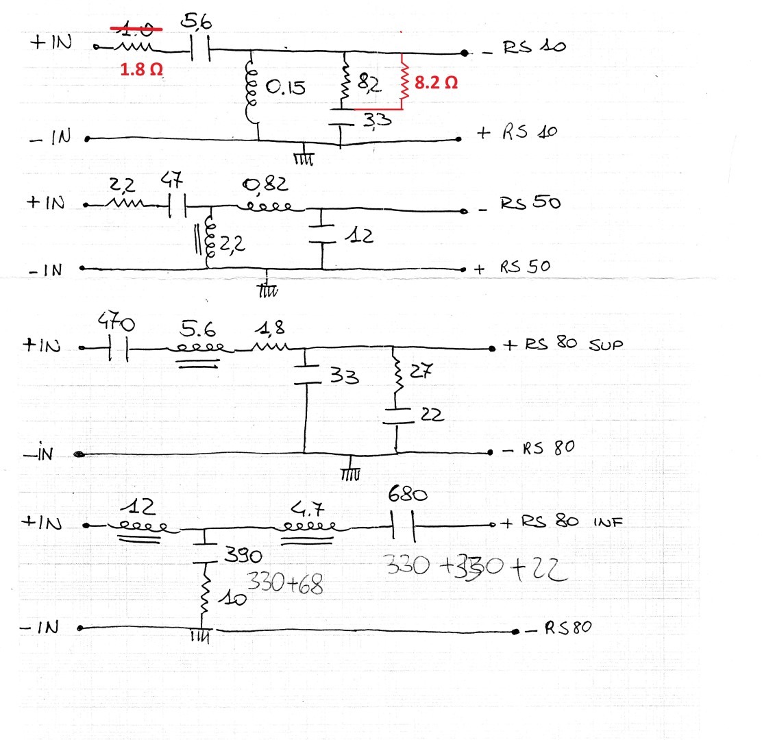

Hi guys,
Today I have removed the Tweeter + Midrange PCB from my right speaker, and I have realized that the change suggested and applied to reduce the hi frequencies, was as per image below.
I also took a picture of the PCB.
So, since I should receive the resistors today from DigiKey, as a first step, I would replace the 1.8 Ω in series with the 2.2 Ω and see how that sounds.
I am asking because before we based our conversation on the fact that only the resistor in series was changed, but in reality also the one in parallel was changed.
Thoughts?

If you use the calculator linked in post #4, you can see the effect of changes, which should help you understand what's happening. Use the DC Resistance of your tweeter in the 'Speaker Impedance' field.
So, the OP has edited his attachment in his introductory post to now show that an additional 8.2 ohm resistor was added in parallel with the original 8.2 ohm resistor.
Pete: Doesn't this mean we have a 4.1 ohm resistor in series with a 3.3 uF capacitor, forming a Zobel network across the tweeter?
Alex: I read that the function of the Zobel network is to "sweeten the top end" of the tweeter.
Alex, I would ignore the 8.2 ohm scenario for now and simply go ahead with increasing the value of the 1.8 ohm resistor.
I would try 3.3 or 3.9 ohm initially.
According to Pete's calculator, the 1.8 ohm resistor is currently providing just under 2 dB of attenuation.
Increasing to 2.2 ohm would take it just over 2 dB, whereas 3.3 ohm would give 3 dB.
You'll likely have to go higher than 3.3 ohm to get an audible difference in tweeter level.
4.7 ohm would give 4 dB of attenuation.
