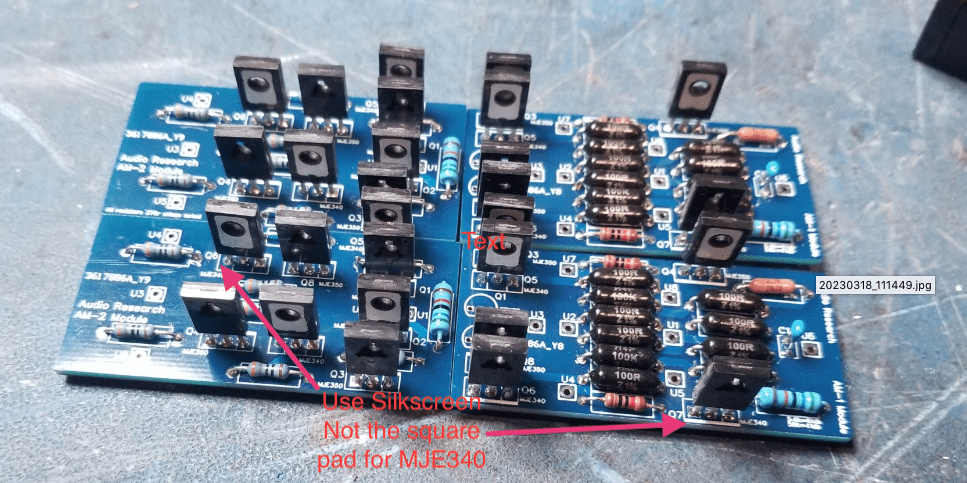

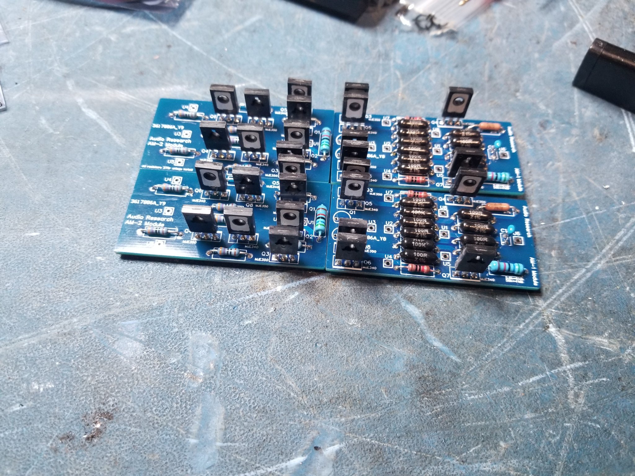

Butch discovered that the square pads are inconsistent between the MJE340 and MJE350
The square pad on MJE350 is correct, the MJE340 is wrong. I pointed this out in some earlier threads, these boards are a revision from "Jayfree" design. Use the silkscreen for orientation, do not pay attention to the square pad. The footprint files in EasyEda are open source and inconsistent, it was easier to add the silkscreen in lieu of revising the board.
See screenshot of the boards below pointing out a couple of the MJE340 oriented wrong
Yes this was very frustrating as the amplifer was acting very strange and very inconsistent voltages all over it. I was chasing my tail for a while the whole time talking to deafbykhorns and he is awsome. I wasnt here for the earlier posts but I could have easily skipped over him mentioning that as I read through the thread ( multiple boards mentioned). We had a lengthy conversation about my issues and I truly didnt think it was the boards but he went way above and beyond to offer help and advice (in my book that speaks volumes). Anyhow I confirmed the pinout a couple hours ago with him and he said to disregard the square pad and I knew right then that was my issue. I basically installed half the transistors backwards. He then told me there is a heavy line on the the board on the side of the would be transistor heat sink side. So I pulled the half of them and reoriented them and the amp functions perfectly. The amp has about + or - 4mv offset and is warming the room up as I type. I'm excited to get a good listen. So when you insert the transistors all of the heatsink sides point toward the heavy line on the board below them. Hats off to deafbykhorns for getting these boards out there and working. He will save many of these amps from becoming boat anchors.

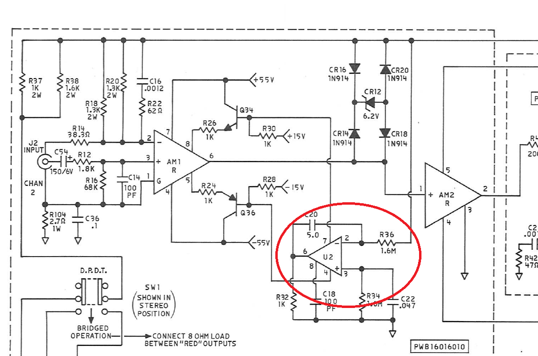

Has anyone determined how the servo works in the D-110? Shouldn't there be a 100k resistor from the output of U1, U2 to the non-inverting inputs of AM1L and AM1R?
The opamp sources current into R32 which will pull/push the DC offset on the output node to zero.Has anyone determined how the servo works in the D-110? Shouldn't there be a 100k resistor from the output of U1, U2 to the non-inverting inputs of AM1L and AM1R?

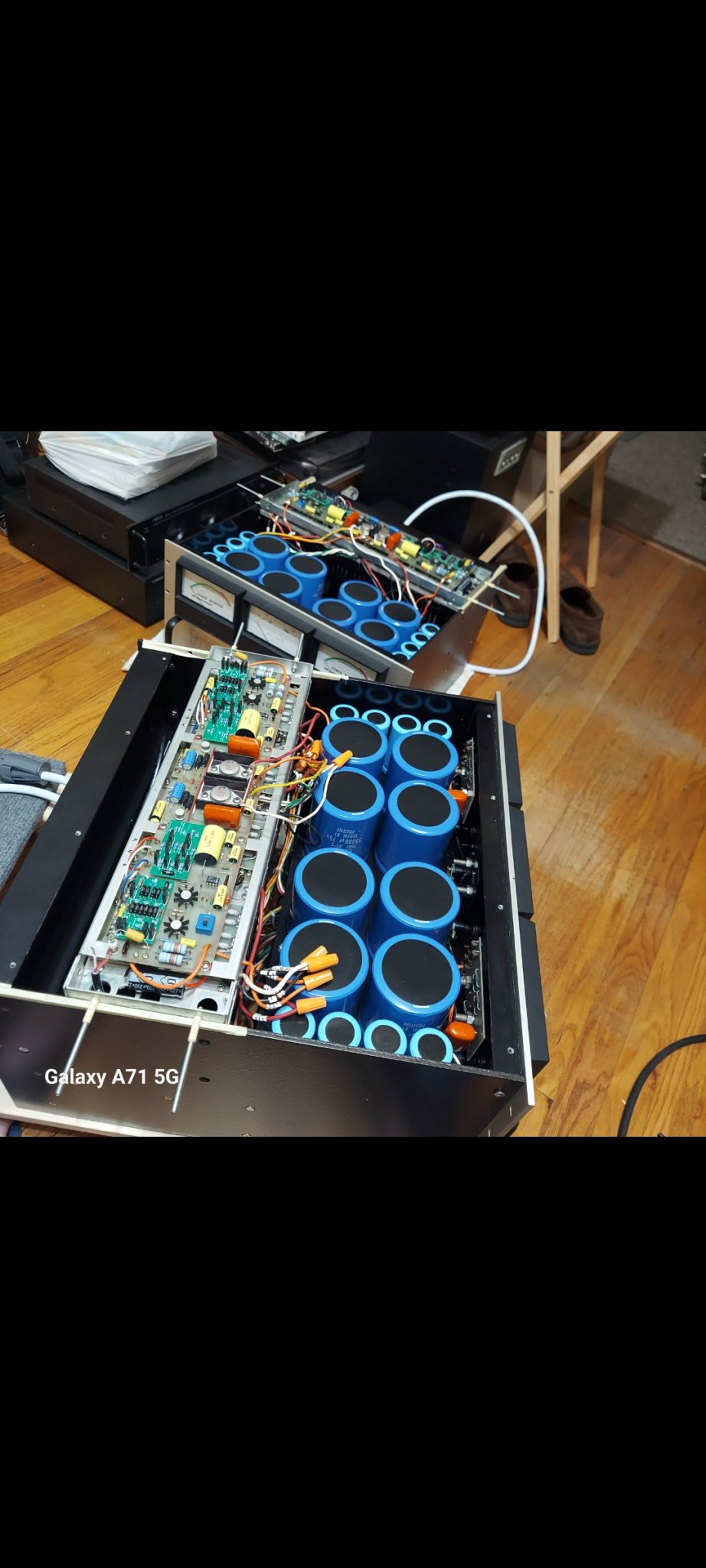

Check this out, my two D110b. Full resto, replaced all Caps,resistors,diodes,LED lights,power cords,disassembled fans and lubed, and replaced all transistors and OPamps, didn't replace all output transistors.
As you can see all the AM 1&2 moduals are new thanks to John-Deafbykhorns!
Took me a total of 6 months to do! And a bucket of money! Last night was the first test run! As you see them in the pic.
Mono blocked them, preamp Audio Research SP-9 and ran them through Klipch Cornwall ones! Absolutely stunning sound! Well worth the time and money!
Couldn't have done it without johns
