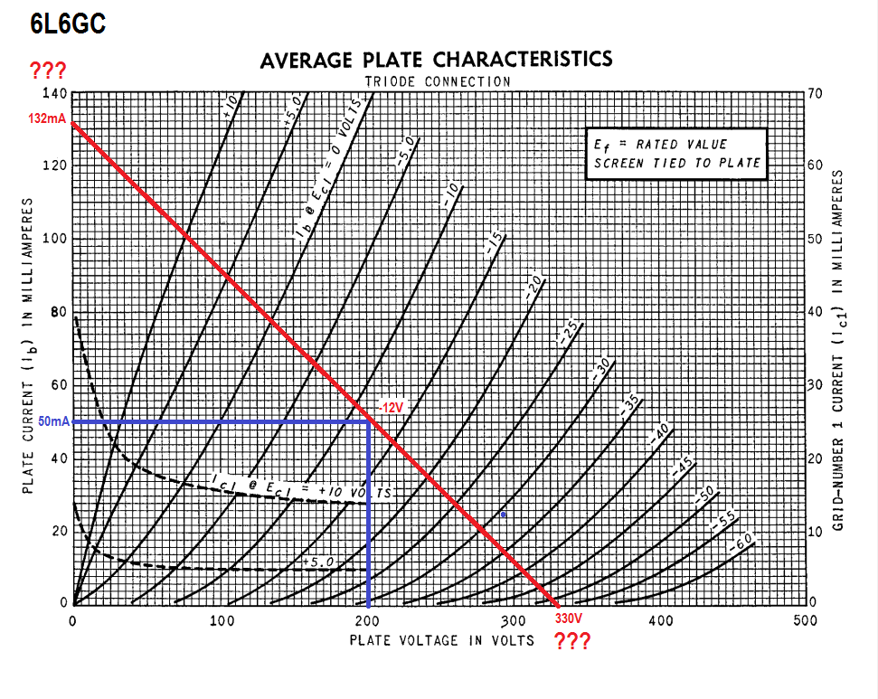

Vg1k = -8.5V is not arbitrarily chosen. It's the bias value that we need in order to achieve Ia=46mA and Ig2=2.2mA. These current values are the result of determining the target Pdiss for the plate.. With Vak=200V and Ia=46mA, Pdiss-plate would be 9.2W which is below the maximum rating of 10W. We also can check the Pdiss of the screen (which needs to be kept within the max rating as well). This would be 125V * 2.2mA = 275mW. Well below the max screen dissipation of 1.25W.

Are you talking about drawing the loadline for the right column? If so, i am wondering how you can do it because the plate characteristics in only for Vg2=110V, not for Vg2=125V as indicated on the right column 😀. However, increasing Vg2 from 110V to 125V would increase the gap between the Vg1k curves. This means Vg1k=0V will be higher. This would imply, yes you will have even less headroom if you choose 4K than 2K.
Shush you 😛 I was talking from a *theoretical* standpoint since as you so pointed out, we've only got Vg2 = 110 curves. If we assume (I'll be the a$$ in the assume this time) that they don't change *that much* I was curious what the repercussions were for choosing a 4k load vs a 2k load and what it meant for the design. Aka you can run fixed bias and have loads more clean headroom with 2K Zo but you'll have less power output vs sacrificing some headroom with a 4k Zo that auto-biases to gain some power output.
Also as an exercise, Since we've only got curves for a screen voltage of 110V, could I not use a screen resistor to drop the voltage to 110V (instead of 125) and use the curve to plot out a 200V B+ ? I realize that further lowering the screen voltage will cause it to distort sooner....again I'm just talking *in practice* here.

A load line is nothing more than a graphical representation of RL = E/I, by playing with the Triode Calculator for a few minutes, you should be able to make out how the different parameters on the screen are tied together, at least the basic ones... While you are waiting for your books, search for Norman Crowhurst's Basic Audio articles online, he covered the subject well.

I get that when plotting load lines I'm supposed to use V(B)+ on the bottom.
But in Bias current calculators i'm asked to provide Plate-to-Cathode voltage..
Now, on my amp, B+ is 332V but my plate voltage at idle is 321v due to the drop of the OPT's DCR.
It seems on some sites that despite asking for "plate voltage" they're expecting B+ all the same... I'm pulling my hair out over this.
It depends.
You need plate-to-cathode voltage to calculate bias parameters.
But maybe some calculators can take OPT's DCR into account too, and hence they ask for B+: the voltage drop on OPT depends on the quiescent current, so the plate-to-cathode voltage will be different too.

The term B+ comes from the days when batteries were more commonly the voltage source. 'B' stands for Battery and + is the positive terminal. The term remained in use even as line voltage power sources became the norm and voltages increased. So now, in tube based electronics the B+ is the voltage across the output of the high voltage supply. It is a supply voltage and is no sure indicator of the voltage on the anode , or what that across the tube will be. It's a supply voltage, how the supply is used determines the rest.
Nope.
B+ is PSU voltage (the term is derived from "Battery +"), high voltage output to ground.
B+ = OPT voltage drop + V(plate-to-cathode) + V(cathode-to-ground)
The last component is zero if the bias is fixed (might be a few millivolts if you have current sensing resistor, can be omitted anyway)
Yes i understand that there's an additional OPT drop since it's not a purely reactive load. I should have been clearer for the sticklers too that my example was for a cathode-bias. At the time I had written the reply, it seemed evident since OP was asking about bias current and was confused about the "plate to cathode" voltage and how that related to his "high voltage".
Point being when you set-out to draw the load-lines usually going "my B+/HT/HV/rail/V1+/whatever is x-volts, i start here" is sufficient enough.

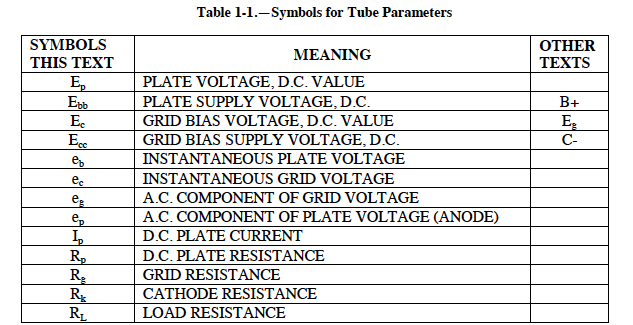

You can call it whatever you want, but as @hearinspace pointed out there's history there. If you ever see "high tension" or "HT" that's from the days of yore as well and means basically the same thing.
I've seen "Va +", "B+", "HT", "V1/V2/V3" (1,2,3 denoting whatever valve its for) and I'm sure a few others. It's all contextual but in the most general sense it usually means "this is my high voltage".
Though some have alternates these terms are useful to know. A few are missing from the chart.
HT high tension
HP high potential (both British uses)
B+ (Us Use, same as above)
Va, Ea anode volts (British use)
Vp, Ep plate volts (US use, again the same thing as each other but NOT the same as HT/HP or B+)
